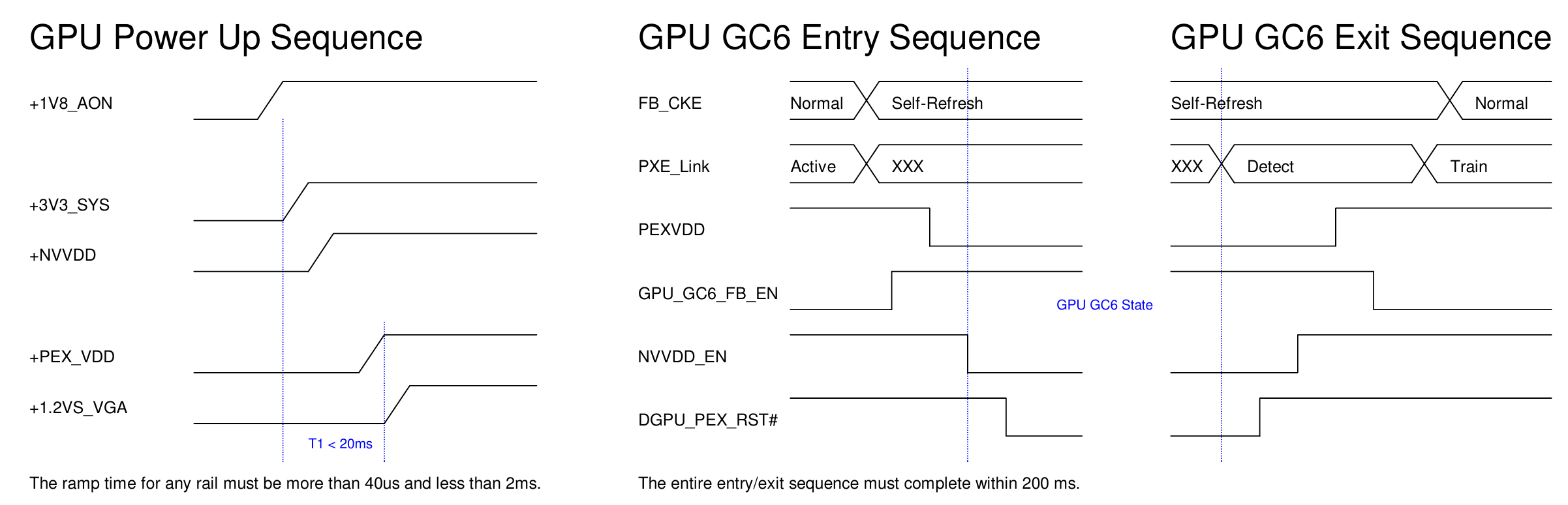

      I also don't understand what the schematic means by "GPU GC6 Entry sequence."
      Click image for larger version  Name:	gpu power up seq.png Views:	0 Size:	107.0 KB ID:	3655278

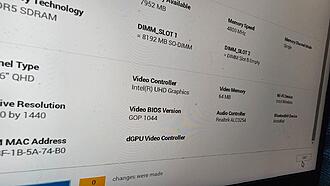

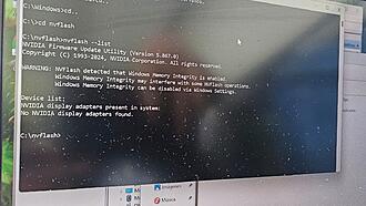

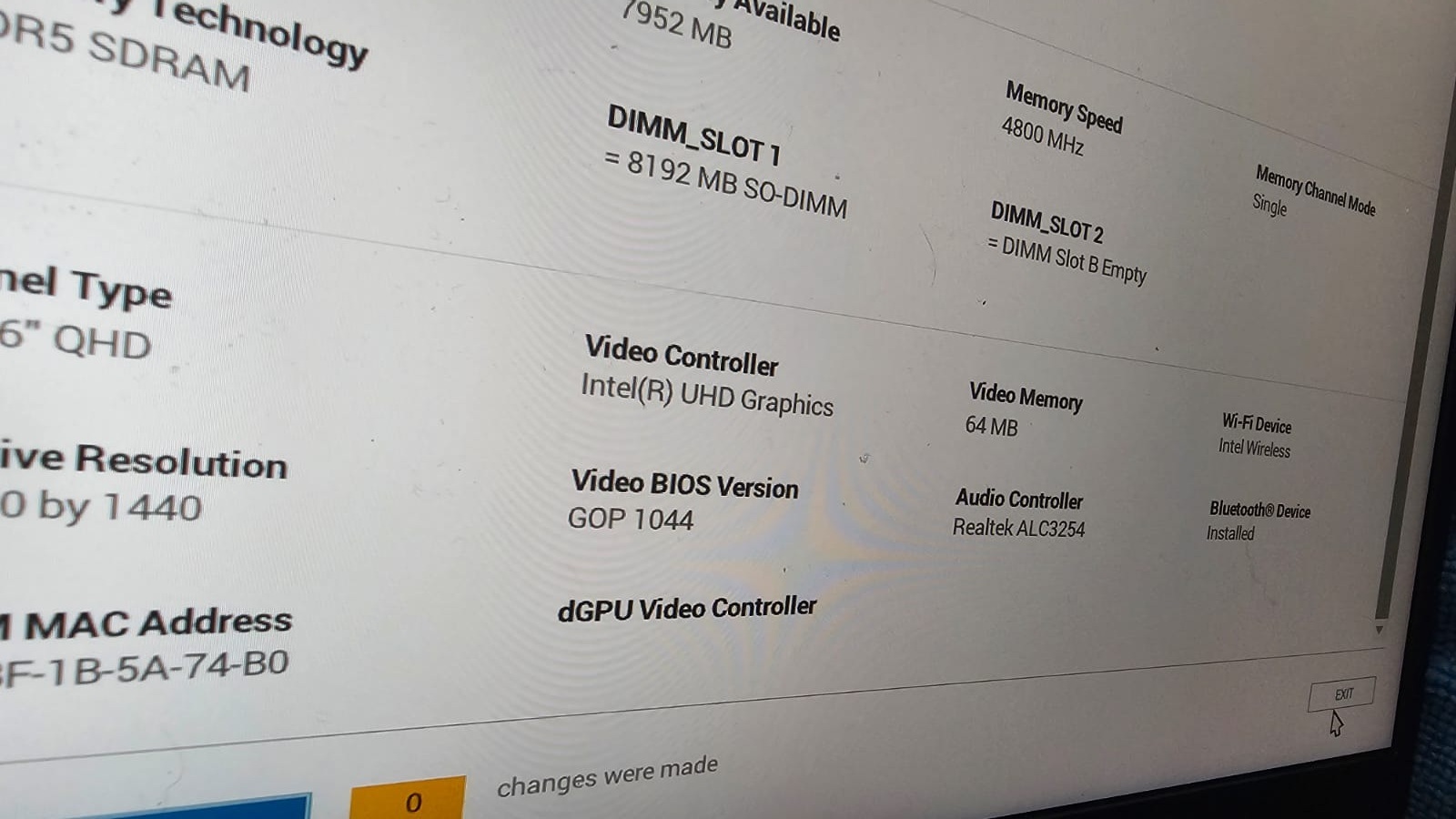

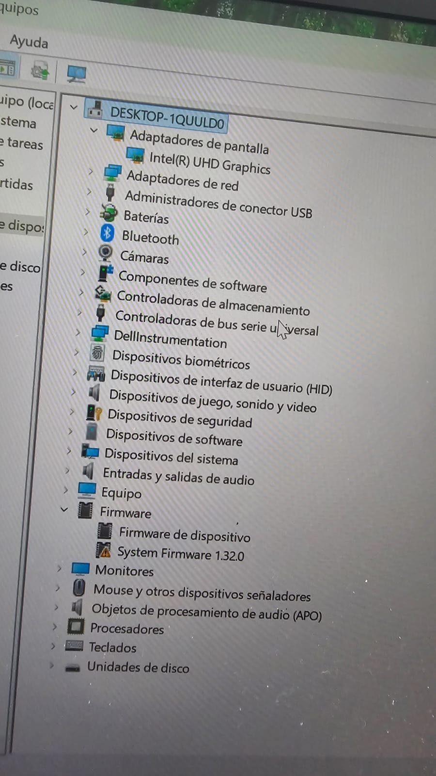

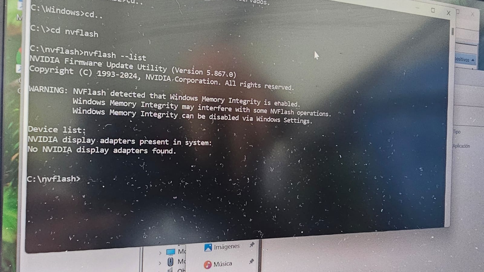

        UPDATE!
        After checking a few times and trying different BIOS, I managed to get video output again with the IGPU, but it still doesn't detect the GPU.
        I have the schematic for LA-l651p and boardview of similar cards LA-L761P or LA-651p that help me identify some connections, but I'm a bit stuck on this topic.
        I'm sure I measured 0.78V on NVVDD
        0.95V on Pex_VDD
        As you can see in the images, the GPU driver is not detected in the BIOS, Device Manager, Driver, or NVFlash
        . Click image for larger version  Name:	WhatsApp Image 2025-06-16 at 9.46.43 PM (1).jpg Views:	0 Size:	232.8 KB ID:	3660884 Click image for larger version  Name:	WhatsApp Image 2025-06-16 at 9.46.44 PM (2).jpg Views:	0 Size:	215.1 KB ID:	3660885 Click image for larger version  Name:	WhatsApp Image 2025-06-16 at 9.46.44 PM (4).jpg Views:	0 Size:	358.3 KB ID:	3660886

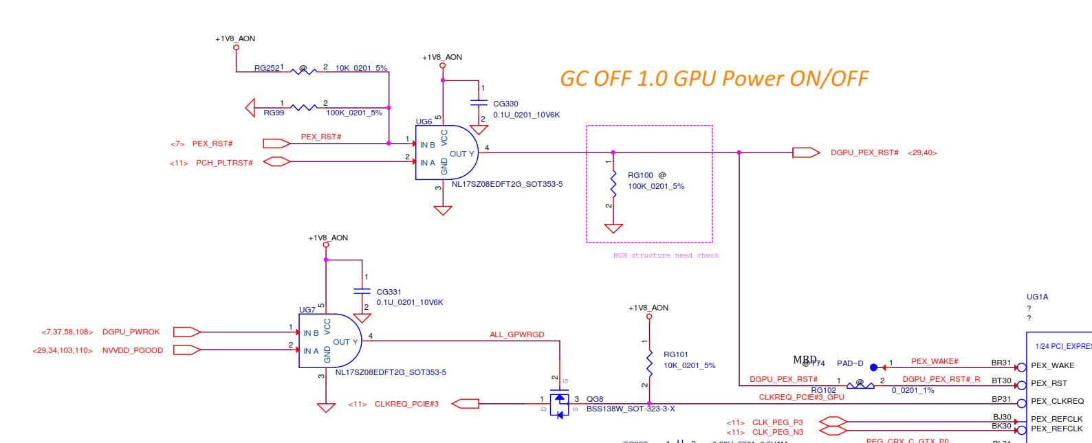

          Update 2:
          I managed to check important voltages on UG6 and UG7, but I'm missing PEX_RST#, which I don't quite understand where it's generated or why it's missing.

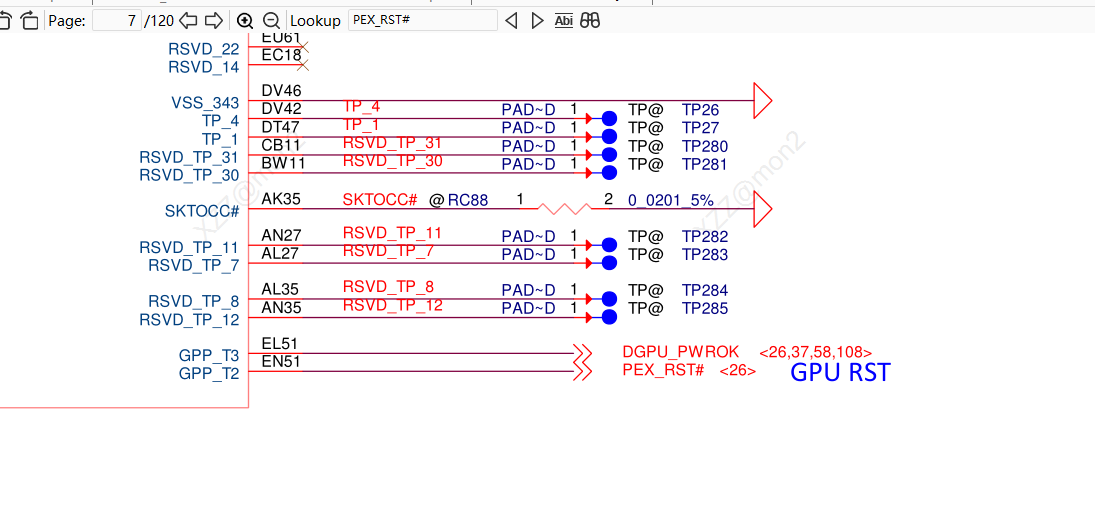

          • mon2
            • Dec 2019
            • 14634
            Did not read your entire thread but on PEX_RST#, this may be the PCI Express reset pin found on the PCIe expansion slot connector.

              • mon2
                • Dec 2019
                • 14634
                See page 7 of the schematics.
                • judamex
                  Active Member
                  • Jan 2021
                  • 186
                  • Mexico
                  Does that mean the PEX_RST signal is generated by the CPU? Are we talking about a faulty CPU or one with broken balls?
                  • mon2
                    • Dec 2019
                    • 14634
                    Carefully flux and remove UG6 off the board. After UG6 is removed, configure your meter into DIODE mode.
                    Red meter probe, yes RED to ground. Black meter probe onto the pad that mates with this signal on the removed UG6 pcb pad. What is the measurement? If this trace is missing due to a bad solder joint, the measurement will be OL = floating state of this trace. If indeed the (hidden) ball is mating with the CPU, then you will have a voltage drop from the internal diode of the CPU. Post your measurement. You can solder back the UG6 device after this test.

                        What would happen if I bridge 1.8V_aon to pex_rst#?
                        • mon2
                          • Dec 2019
                          • 14634
                          Do not hard force the logic state.
                          Is ug6 onboard or removed? Measure the resistance to ground of this signal.
                          For testing, ok to move the pull down of 100k ohms on this line to the open pads to make the resistor a pull up to 1v8_aon.
                          If the resistance of this line is very low, the pull-up will not work.
                          Many articles on this topic note this and gate is the root cause of this fault.
                          What is the voltage of the power good of this gpu? Check the output of the other and gate below this one in post #5.
                          • judamex
                            Active Member
                            • Jan 2021
                            • 186
                            • Mexico
                            The above reading is with the UG6 removed and the resistor in place. The measurement is 0.835 in diode mode.
                            The readings on UG7 are:
                            pin1: 2.7V
                            pin2: 3.4V
                            pin3: GND
                            pin4: 1.8V
                            pin5: 1.8V
                            Readings on UG6:
                            pin1: 0V
                            pin2: 3.3V
                            pin3: GND
                            pin4: 0V
                            pin5: 1.8V
                            Reading on pin 1 without the 100k pull-down resistor and UG6
                            Red Pex_rst#. Black Ground: 77k
                            Diode mode
                            Red Ground, Black Pex_rst#: 0.832
                            reading pin 1 without resistance and with UG6 connected
                            Red Pex_rst#, Black GND:74k
                            Diode mode
                            Red Ground, Black Pex_rst#: 0.738

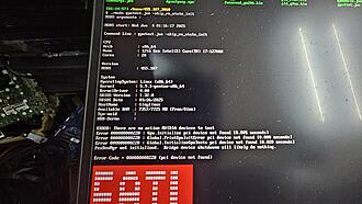

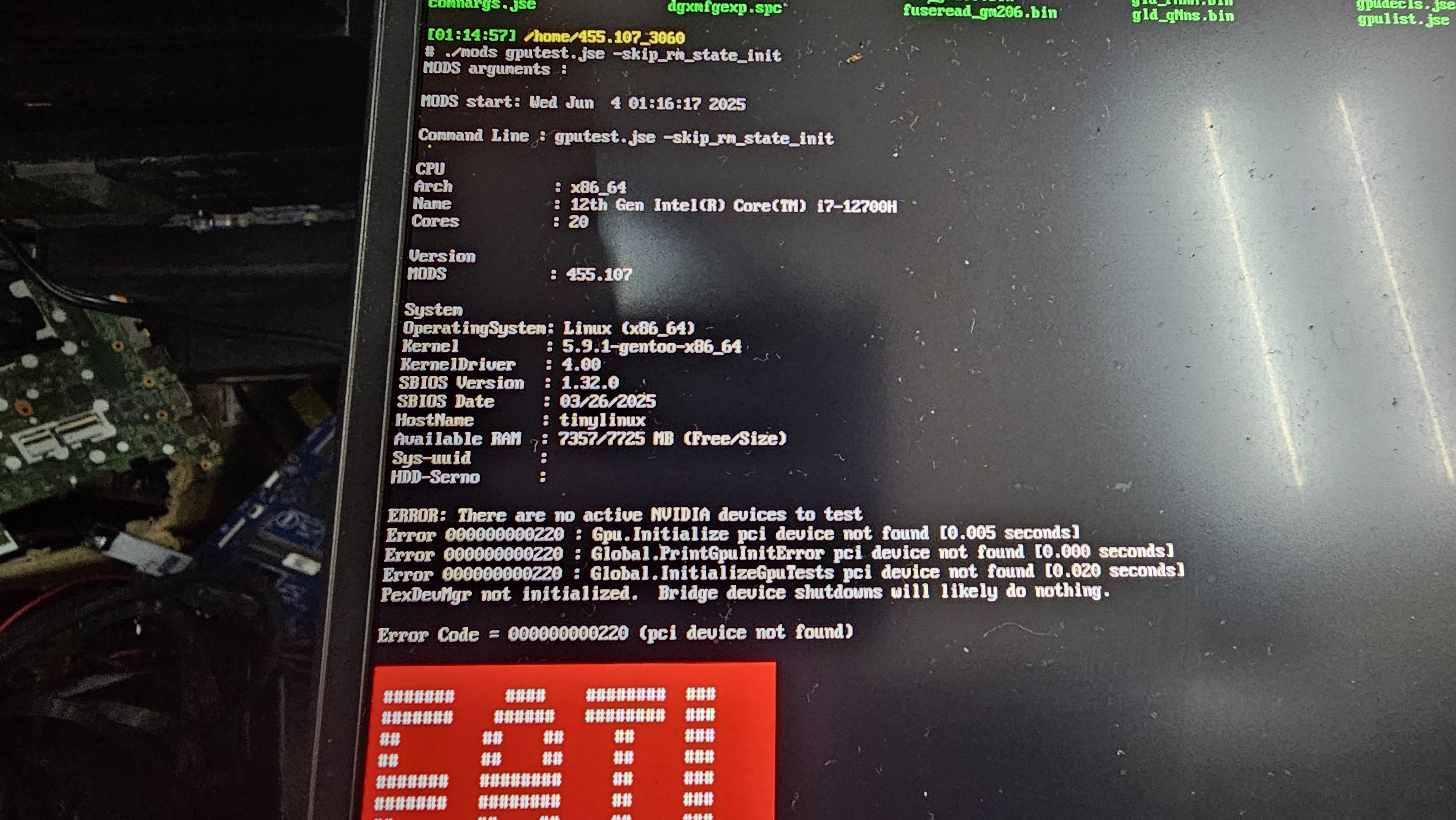

                              Today I decided to put everything back together and run tests with Nvidia mats/mods since I was seeing that in the 12th generation onwards for some reason the graphics stop being detected due to memory failures, so I decided to run a test and this is the result. Click image for larger version
                              The GPU is not detected by these tests, which means that the problem could be due to a lack of voltage or some other unknown fault. I hope this can complement my post.
