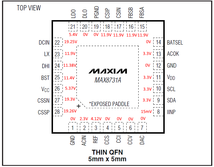

    Hello !
    I have a problem with a Dell Inspiron 1525 computer motherboard. The computer refuses to charge the battery, when I am under Windows it says "Plugged in, not charging" and there is no charging indicator light on the front of the computer.
    However, the computer works without the charger when the battery is already charged, and it also works when there is only the adapter connected.
    I charged the battery with another computer and it charges well, so the battery works.
    I have already made some measurements using the motherboard schematic (thanks JaroTech), and I got these measurements when the adapter and battery are connected to the motherboard:
    (See MAX8731A-AdapterBatteryConnected.png)
    Looking at the MAX8731A documentation I think the measured values are correct, but I don't really understand how the MOSFETs that allow the battery charge are controlled...
    I saw that the signal wire AC_IN# that goes to WPC8763LDG switches well from the high logic state to the low logic state when I connect the charger so I think the "computer" detects well that the battery must charge.
    Maybe the problem comes from the battery charge control MOSFETs but I would like to be sure that the values measured on the MAX8731A are good before controlling the MOSFETs (especially since I don't really understand which ones must be "passing" to charge the battery...)
    Thank you in advance for your help!
    See below motherboard schematic, MAX8731A datasheet and measurements on the MAX8731A :

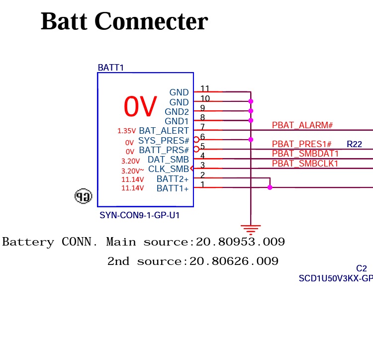

    Test Voltage L14 both sides
    Voltage in battery connector

          I measured the voltage on both sides of L14 and there is 11.14V
          I also measured the voltages on the battery connector.
          The voltage of the CLK_SMB pin varies slightly between about 3V-3.20V, but since it is a clock...
          On the other hand, the battery connected to the motherboard has still some autonomy so I don't know if this could be a problem for the measurements.

            BATT_PRS# Signe is missing 3D3V AUX S5 test the R21 470k

              R21=414khm
              R22=100ohm
              On the 3D3V_AUX_S5 signal I have 3.315V.

                so pin 5 of battery connector 3.3V ?

                  Pin 5 is probably pulled low by battery to indicate to the ec that it is inserted. It has # prefix, meaning low value is true.
                  From max8731 measurements it is hard to say - the gate driving signals should be looked with oscilloscope. Measure mosfets U8, U7, U5 for low resistance onboard and if unclear result then offboard.

                    I think pin 23 & 24 measurement are wrong indicating low side and high side gates of fets are not opening.

                        You advise me to visualize which signals with the oscilloscope?
                        DHI (24); DLO (20) and the gate of U5?
                        Thank you all for your help
                        • SRO2
                          • Sep 2018
                          • 44
                          • FRANCE
                          Re: Need help for battery issue (MAX8731A) on Dell Inspiron 1525
                          I visualized the following voltages with the oscilloscope, and they are all direct voltages, without parasites, very clean...
                          U5 Gate=19.6V Source=19.6V Drain=11.4V
                          U8 Gate=11.2 Source=11.6V Drain=19.6V
                          U7 Gate=0V Source=0V Drain=11.8V
                          Everything looks okay, I really don't see what the problem is.
