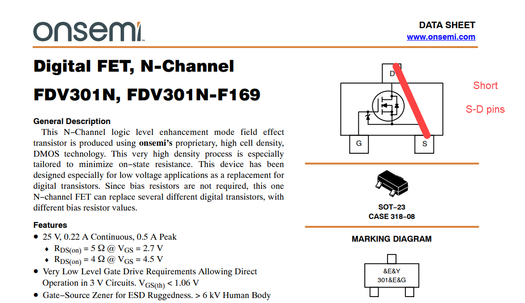

        In general, the mosfet @ PQ1 and/or the series resistor @ PR1 become defective.
        Remove all power. Measure the resistance across PR1. Confirm this part is ~33R.
        Flux and remove PQ1. Bypass this over voltage crowbar mosfet by shorting pins 1-3. Download a datasheet for this mosfet to review the locations for pins 1 & 3 on this SOT-23 package.
        Test again. If still not working, then the EC firmware may be at fault. It is the EC that is the bus master here who pulses this PS_ID line to send out commands to the adapter's ID 1-wire IC. Then the adapter's 1-wire IC will respond back to identify itself to the host and the details are posted inside of your BIOS.

            I measured PR1 resistor in (ohms mode) the reading is varying getting 35 to 37 ohms each time I measure.....

                      Measure the voltage to ground of the H_PROCHOT# signal. You can measure this signal @ PQ12B - measure the voltage to ground on each pin:
                      gate
                      source
                      drain

                        Hi Thanks,
                        PQ12B seems a 6 pin dual Mosfet on the motherboard.....shows up as two distinct Mosfet on schematic.
                        I measured voltage to ground as requested: pin 3= 1.009v, pin 4= 0.000v, pin 5=0.000v
                        Battery Connector SMBUS voltages: pin 6= 3.3, pin 7= 3.3 with adapter only. These pins gives 0v each with battery only connected.

                                  H_PROCHOT# is ok due to the pull-up resistor is @ 1v05.
                                  This implies that the driving mosfet is OFF so this mosfet is open and the pull-up resistor is pulling the line to ~1v05 as in your case.
