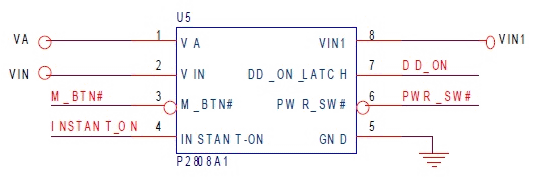

    Dear friends, sharing a shortcut but working solution for P2808 fet. This fet is very hard to get in market and my experience is bad with this particular fet. I ordered it online 2-3 times and none worked. This fet is frequently used on clevo laptops and is invariably burnt.. Here is the solution.
    01. Connect PIN2(VIN) to PIN8(VIN1) with a jumper wire with 20 Ohms resistor placed inbetween the two points.
    02. Connect PIN3(M_BTN#) to PIN6(POWER_SW#) with a jumper wire.
    Leave all other pins unconnected. Works like a charm. Hope it will help others.

              Does apply for P2808B?
              • mcplslg123
                • Jun 2015
                • 7262
                • india
                Re: Mosfet P2808 Solution
                yes
                  not work with me,so any an other idea?
                  • mcplslg123
                    • Jun 2015
                    • 7262
                    • india
                    Your problem lies elsewhere. this solution works 100%.
