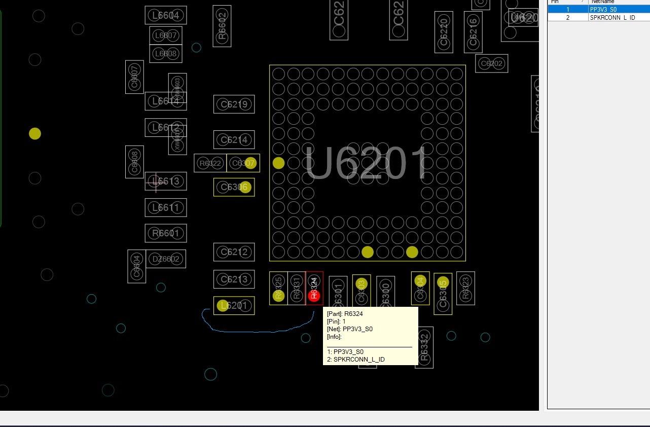

    Is this jumper wire correct? macbook board missing pad.
    2015 macbook pro which has no sound.
    Noticed some corrosion by the Cirrus audio ic. Resister R6324 had corroded off the board, pad indicated in pic is gone.
    So soldered another 100k resister to the pad closest to the ic and ran a jumper wire as per pic to l6201 for the 3v.
    Is that correct or should i be jumpuring to somewhere else?

    Re: Is this jumper wire correct? macbook board missing pad.
    Yes that's fine. Resistor is just a pullup to PP3V3_S0.
    If there is no sound, don't forget to do a PRAM reset to rule that out.
