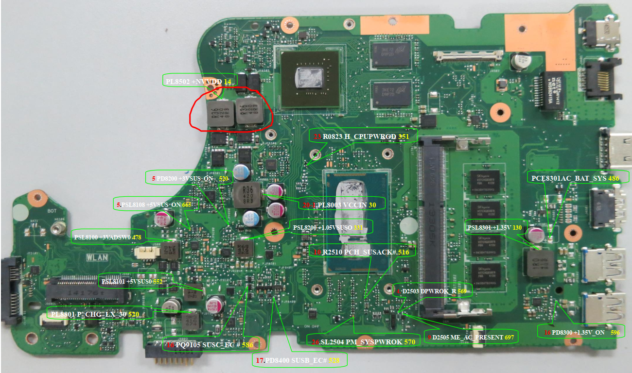

    Asus X555LD Rev. 2.0 no screen on internal
    I have a problem with a X555LD motherboard with an BGA i3 and an NVIDIA GPU. It charges the battery, works fine, but doesn't show a picture on the internal screen.
    Windows will also not recognize the panel.
    PANEL VCC on LVDS is not present - what shall I measure next?

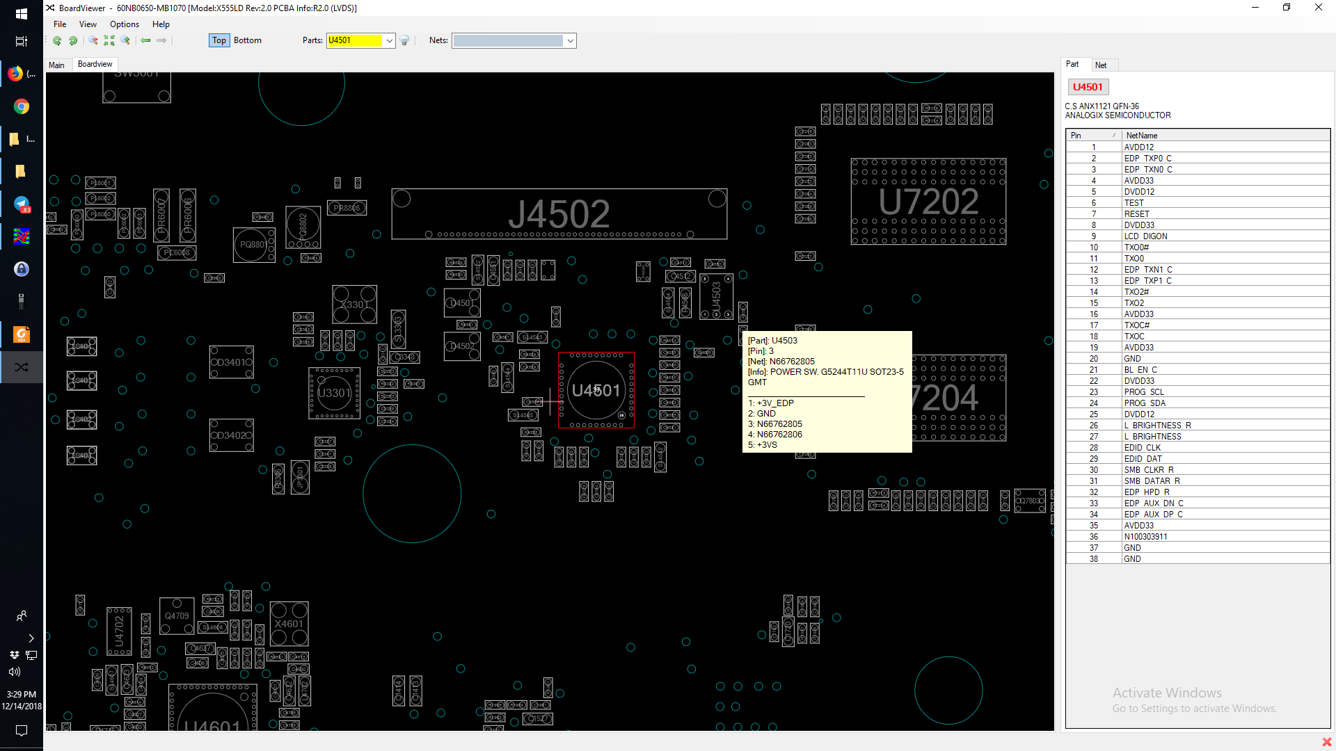

    Re: Asus X555LD Rev. 2.0 no screen on internal
    do you have the schematic
    • Conste
      • Oct 2018
      • 235
      No, I just have the boardview for the board.
          J4601 LVDS connector depends on the ver
          Test
          Pin 123 +LED VCC CAP C4602 C4627 L4607 (AC BAT)
          PIN 37.38.39
              Pin 1,2 and 3 of J4502 - LVDS are 0v.
              C4602 0v on both sides.
              C4627 PIN1 1,08v and Pin2 0v.
              L4607 is not available on Rev. 2.0.
              Pin 37/37/39 of which part?
                      Originally posted by conste
                      pin 1,2 and 3 of j4502 - lvds are 0v.
                      C4627 pin1 1,08v and pin2 0v.
                      L4607 is not available on rev. 2.0.
                      j4502
                      pin 2.3
                      cap c4517 c4512 sl4504 r4530
                      pin 4 j4502
                      u45503 pin 5
                      c4550
                      rn4526 pin2.4
                      test voltage
                        I finally solved. Just a missing supply in U4501 pin7 reset signal must have 3.3v
                            yes there is a broken line from plt_rst line

                                    ok lets stars from 0 whats is your LVDS connector number J4503 or J45__ ?
                                    • Conste
                                      • Oct 2018
                                      • 235
                                      It is called J4502
                                      • Techtiger
                                        • Oct 2014
                                        • 1602
                                        • france
                                        voltage in
                                        pin 2.3.4.21.27.36.38.39.40
                                        one of this components short
                                        C4517 0V on both
                                        C4512 0V on both
                                        SL 4504 0V
                                        R4530 0V on both
                                        test with out power resistance to gnd multimete
