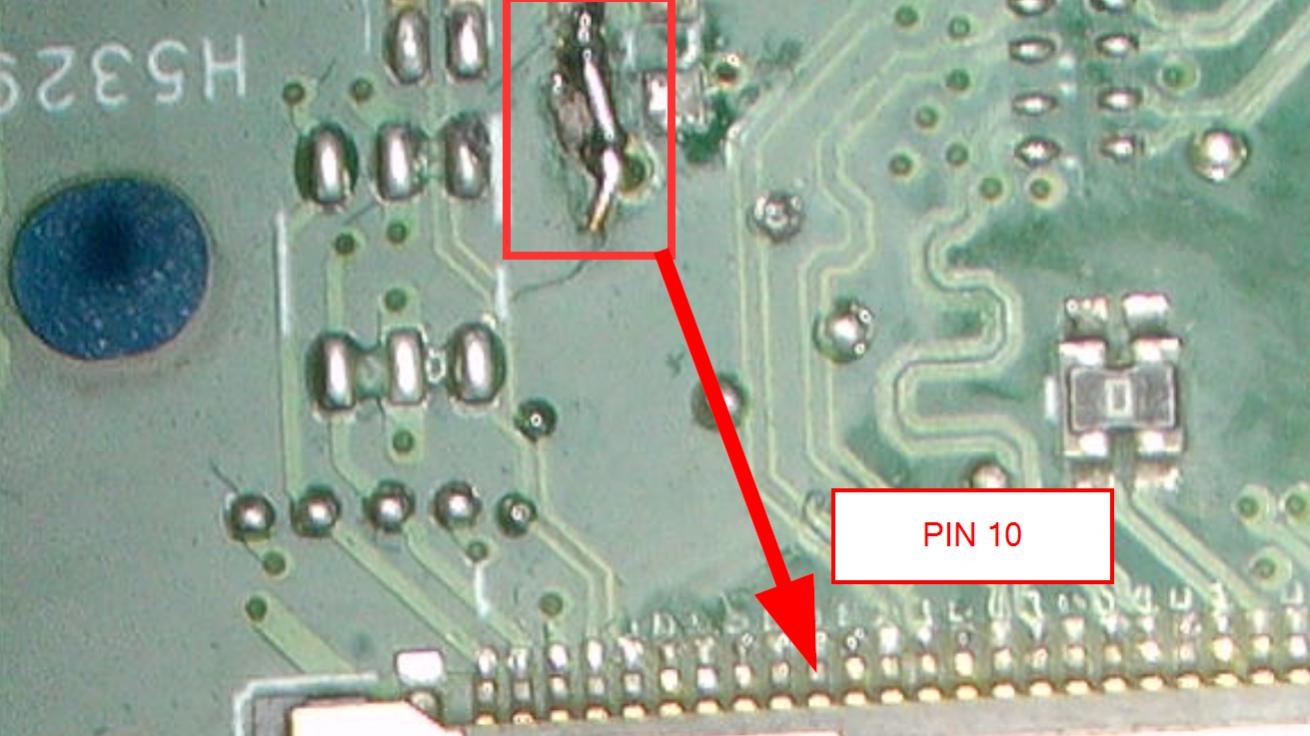

    I've a asus laptop with X751LD rev 2.0 MB.
    The laptop screen remain black but if I attach an external monitor on HDMI port I see the bios screen.
    I checked power lines on lvds and i found 18.78v also i don't find any obvious problem.. like shorted caps or mosfet on lvds connector area..
    there is something that I can check to find the problem?
    thank you

    Hi, give me the voltage of all the pins of the screen connector. We'll start with that.

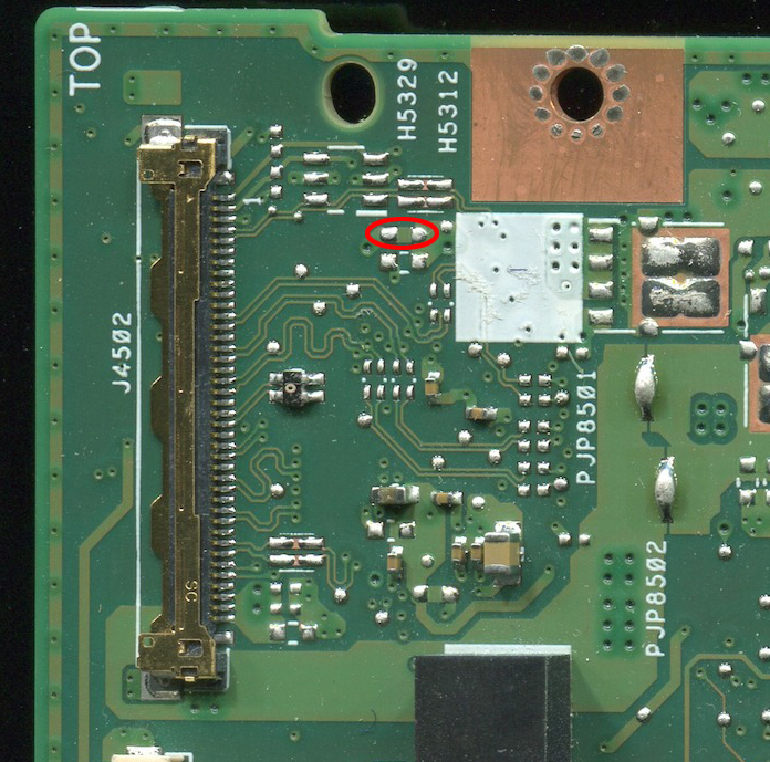

      as first, thank you very much for you support and sorry for the late reply.
      I try do my best to solve the problem on my own... following your suggestion, I checked every single pin and after a lot of troubleshooting I discovered that there are some stranges value on pin 10.
      As first sight I don't see an oxidation on a trace, so i cleaned up the trace, cleaned the pad (that was almost destroyed!) and soldered a wire to rebuild the track and all start work again!!
      Thank you for your suggestion!!
      I leave two pictures attached as reference for other peoples that can have this problem in future.
