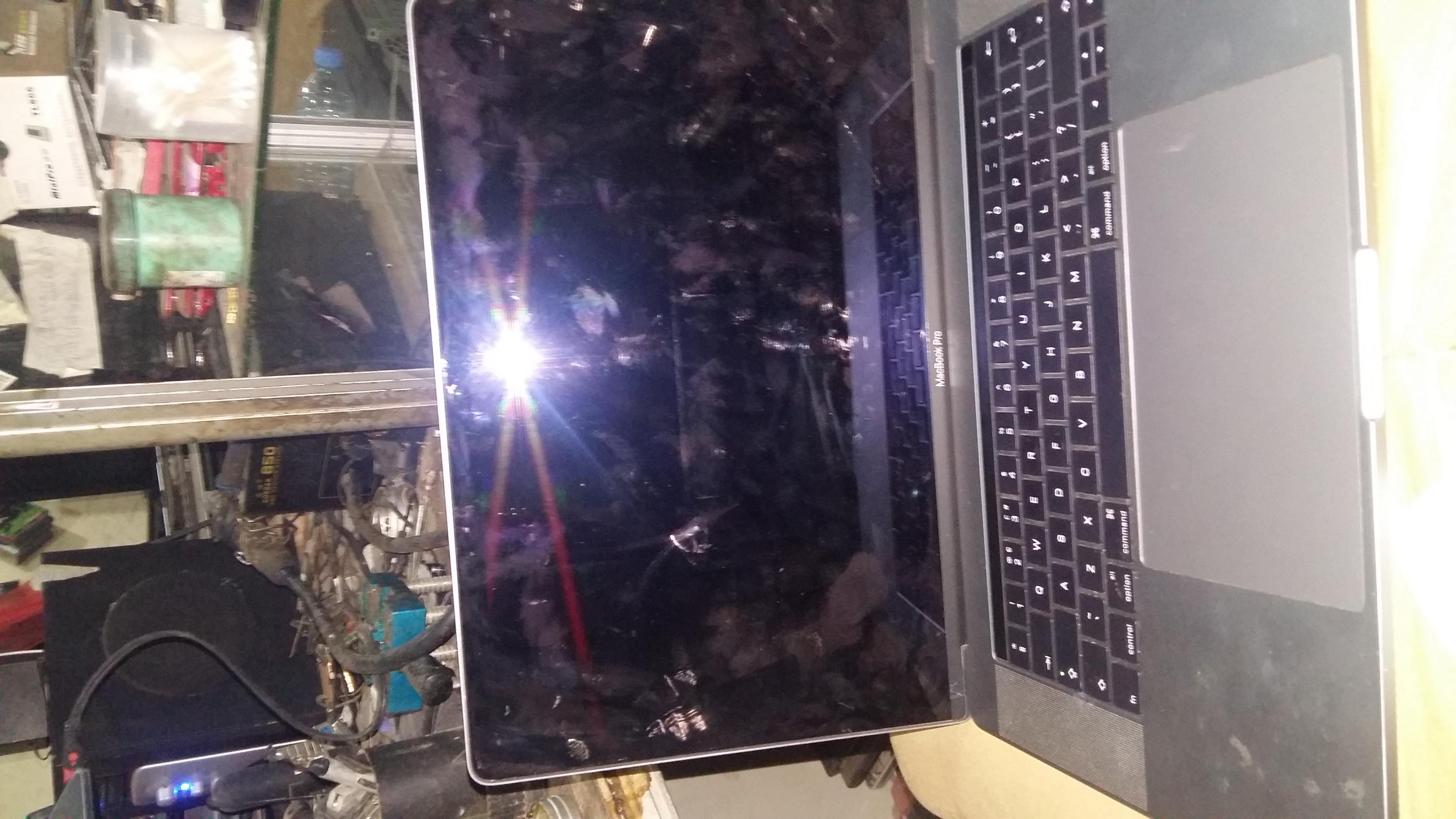

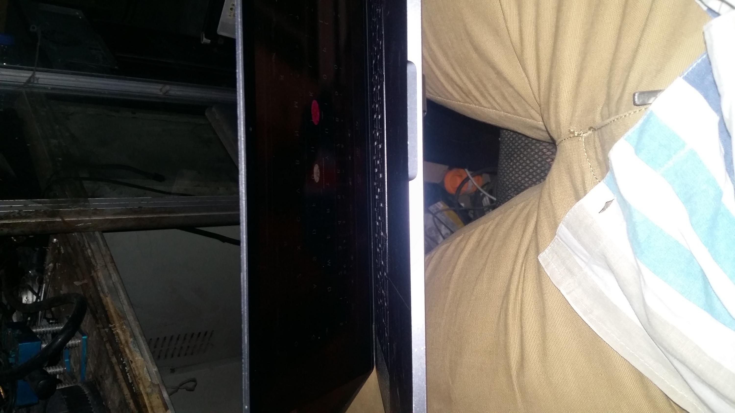

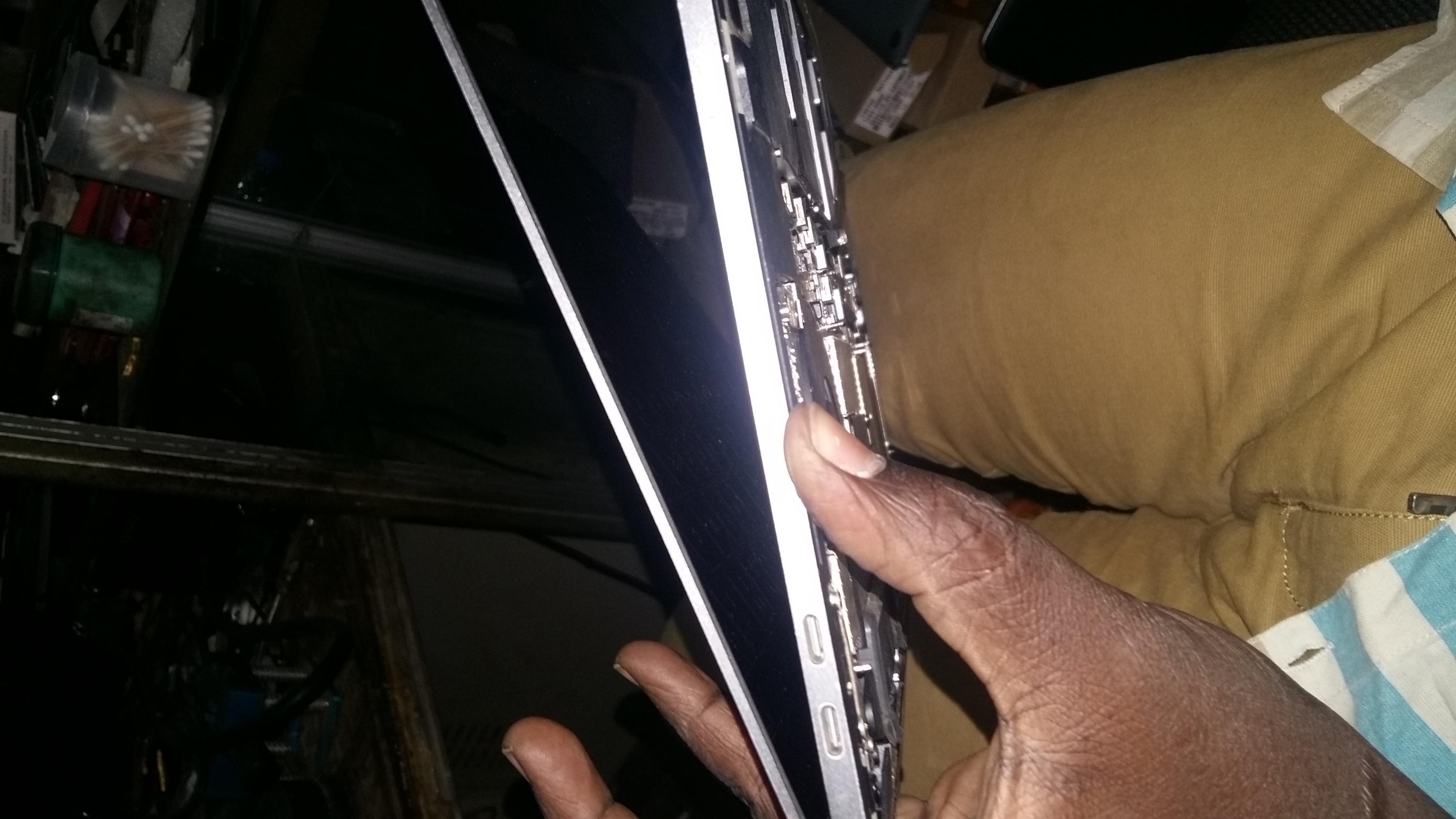

    HI
    I have macbook pro A1707 going black screen win I open screen 90° . I don't know what's problem sensor or other thing.
    Can you help me.
    Just it's work on 30° .
    Attach photo.

    Re: Mack book pro A1707 lcd problem
    Lvds cable is suspect.
      Lvds cable it's OK. I think it sensors.
        the cable is known to be defective on many of those, how would sensors be the cause?
        The lid sensor can probably be tested with software. check if you can find anything for it and better check that cable, because what you describe is exactly that. good luck
          Hate to break it to you, but all A1706, A1707, and A1708 LCD from 2016-2017 have a very known LCD short cable issue that rips within a year or so because it is a few centimeters to short compared to the issue Apple has fixed in 2018 and up models. I do know how to get that LCD replaced for Free but you will have to have a 2017 model to make this happen.
            Hey Stephen, how could I get the LCD to be replaced for free?
              Apple have (or had) a service program for it, however its confined to 2016 models only. Since they were only manufactured from October 2016, it only covers about 3 months worth. It's the same issue, same model, just Apple won't cover it (officially). Last 2017 A1706 I sent up there they refused to cover it and quoted him AUD $1100 to replace the screen. So I don't know how you would get it replaced, unless you were good mates with someone at Apple or an AASP.
              BTW, I've ordered a replacement screen for one off Aliexpress a while back. Cable was same length, so not worth replacing as same issue will happen again. You can however cut the flex cable and extend it with another flex. These models are total shit anyway, with keyboard, battery and screen issues. Not worth reselling if you ask me as they will likely come back.
