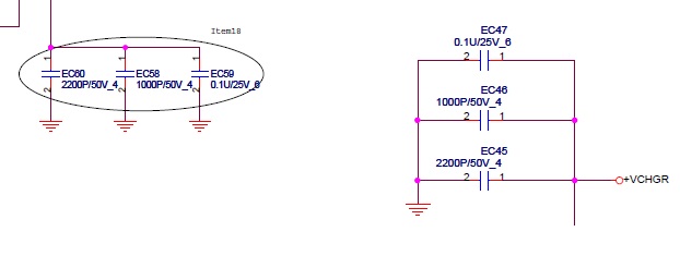

                        Change "EC45""EC46""EC47",change also "EC58""EC59""EC60",Generaly change caps related to "+VCHGR",one or many of thoses caps is the main cause of disabling battery temporary, that's why you see the msg ,thoses caps are the main causes of this msg and also for another problem ,when you see battery charging but the % still the same ,thoses caps also the main causes,change it and it will work ,I have the same pb with dell 3521 same msg changing those caps solve my prob ,also lenovo g580 who still charging but percentage not increase change thoses caps solve my prob also,I hope that help you friends.give us a feedback friend.thank you .

                          Re: Dell Inspiron 17R 7720 "Your Battery is Temporarily Disabled", Battery LED Flashi
                          Thanks for head-up kiraro, appreciated your help, lets try with your suggestion & see if it working or not,
                          EC47 & EC59 looks same (0.1U/25V_6)
                          EC58 & EC 46 looks same (1000P/50V_4)
                          EC60 & EC 45 looks same (2200P/50V_4)
                          any idea where to find & buy these caps? any web link or online store? eBay/aliexpress or any else where?,
                          Thanks.

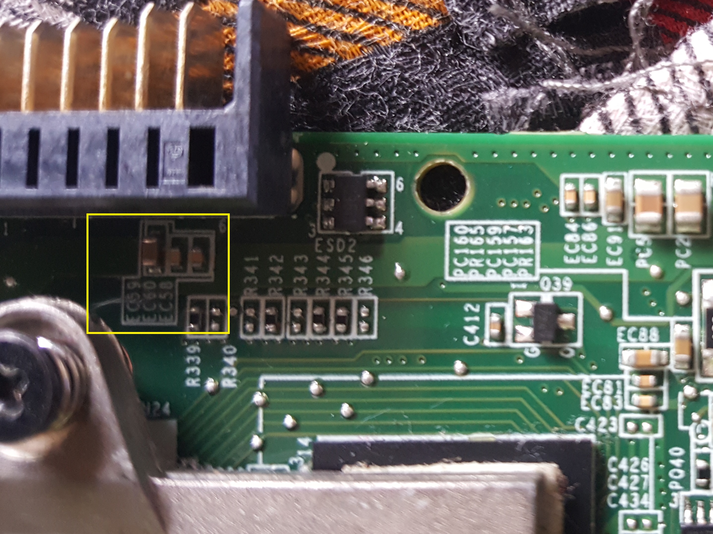

                          • Ali101
                            • Jul 2017
                            • 152
                            • Taiwan
                            Enclosed Motherboard image with EC45""EC46""EC47", "EC58""EC59""EC60" marked with yellow color, just for reference in case it need, hope it will help to advise where i can buy them with what size,
                            Thanks.
                            • mcplslg123
                              • Jun 2015
                              • 7262
                              • india
                              Thanks.
                              Replace these caps only if it shows short, else it doesnt make sense. You can get them in plenty from any laptop scrap mb.

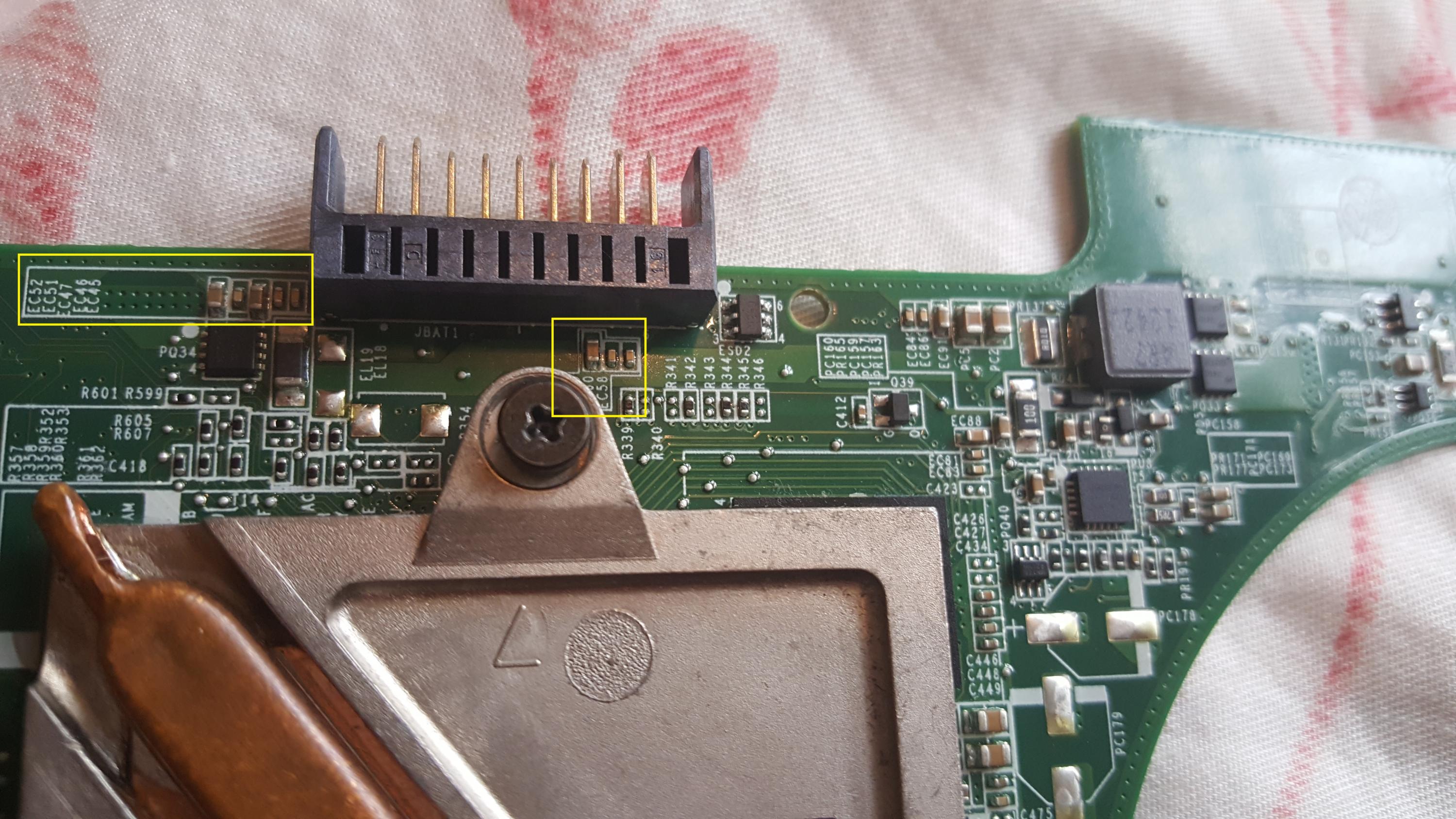

                              • mcplslg123
                                • Jun 2015
                                • 7262
                                • india
                                most likely you have problem in battery output line. Check those lines carefully for any shorted caps or mosfet.(two similar looking pins at the extremes of battery connector-one side is gnd and the other side is output +12v)
                                • Ali101
                                  • Jul 2017
                                  • 152
                                  • Taiwan
                                  sorry for noobi question but how check this, can you advise which section & pin is battery output line?
                                  Thanks.
