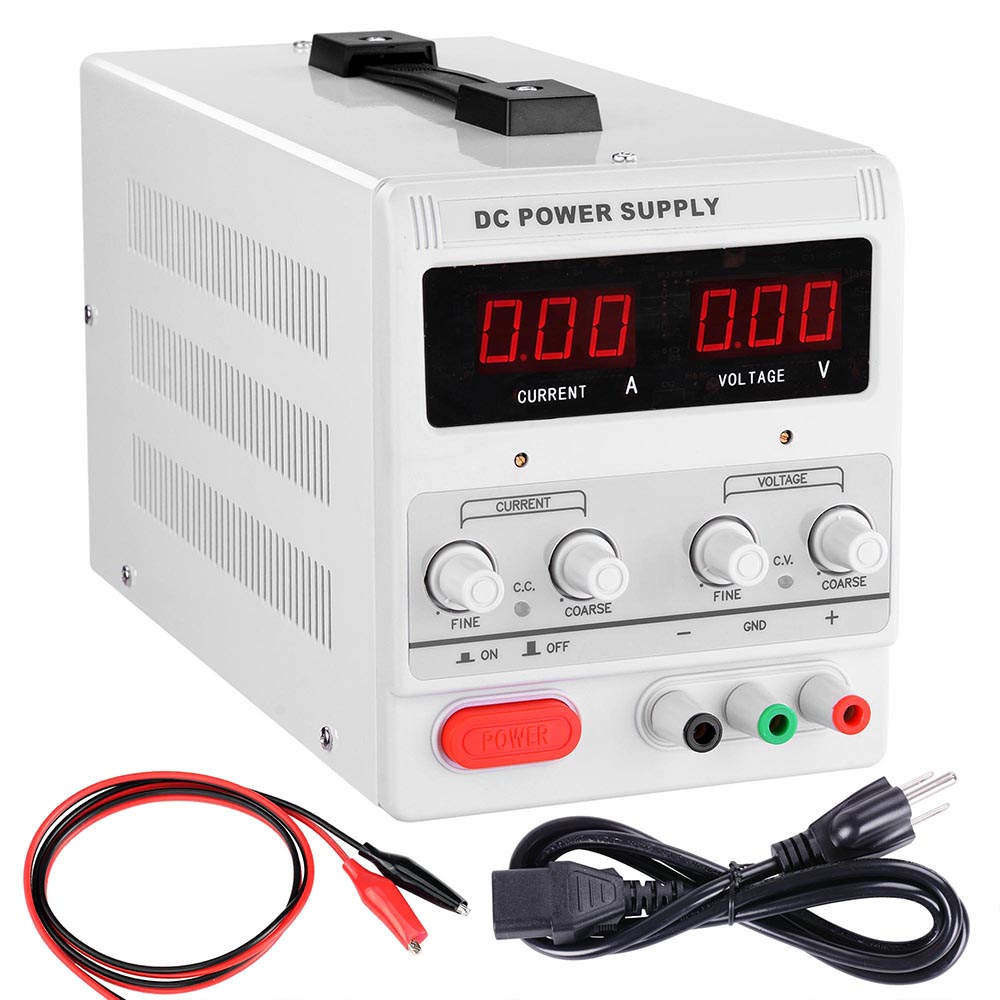

Hello dycc,
thanks for head-up, appreciated your help,
i do have voltages as per it should be, pls check below
Cn4 :pin5 (psid) voltage 3.3v (with battery & without battery)
jbat1: Smbdat0 , smbclk0 voltages 3.3v (with battery & without battery)
jbat1: Pbat_pres# with battery 0.06v & without battery 3v
since my batter drain & goes 0% due to not used so i guess that's why jbat1: Pbat_pres# with battery showing 0.06v, so is there any way i can charges battery without laptop? i do have 110V AC 30V 10A Digital DC Power Supply so if this can charges battery than your help will save my batter to get dead, (attached Digital DC Power Supply image)
your further help will be highly appreciated,
i'll try later, coz seems like PR3, PR6 looks fine, further i'll wait for @dycc instruction whether it need to change or not, coz i did voltages test as advised by dycc & those test looks fine & normal, Thanks for help bro,
that is not possible coz as i said earlier i did checked my both batteries in other same model Dell Laptop and both batteries working fine, so issue is with motherboard, will wait for @dycc further help, hope will resolve this issue,

 no more "operational temperature" notification, charging works as expected, anyway
