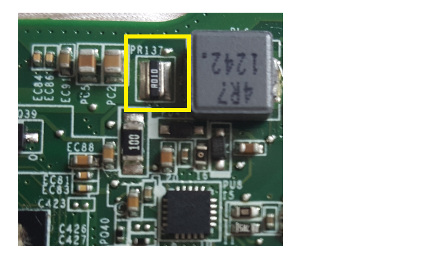

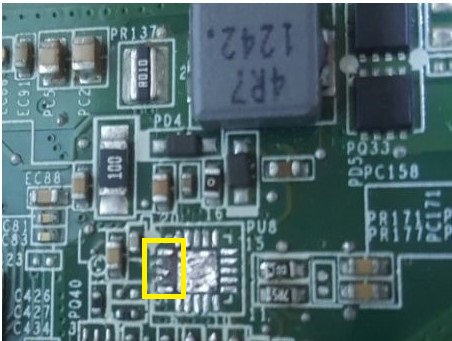

This type is of issues normally happen when there is a short circuit on the vbat line, in the case of your board or schematic, +vchgr line, the battery voltage line. When this happens a short circuit is introduced into the battery pack and subsequently disables(shorts) the communication lines; sda and scl.The host in this case, the motherboard(charging IC and EC) not seeing any communication from the battery pack will assume the battery has being disabled internally and hence post that kind of notification to your screen that your battery is disabled temporarily. To solve this problem, remove PR137 and check for short at both sides of it. the side that shows a short to grnd, u inject about 12v to the line and inspect any heating components. remove and replace the component and your problem is solved.
