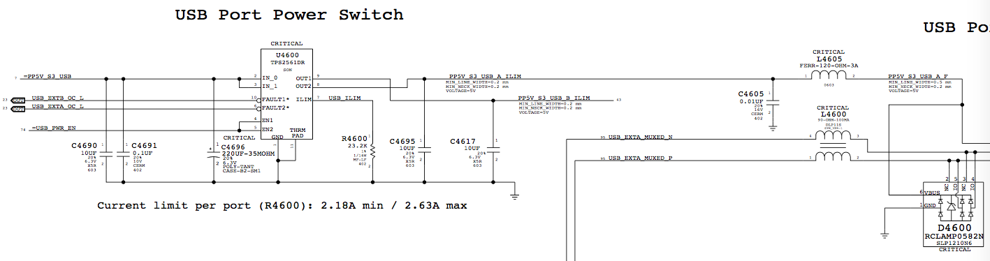

    On a mid-2012 MacBook Pro 15" Unibody (820-3330 logic board):
    This issue seems to have started after using the USB ports to charge R/C aircraft. I've tried SMC and PRAM reset, unplugging the internal battery, but no change.
    The front port (closest to the SD slot) seems to be completely dead, and doesn't supply power to devices at all. Haven't checked with a powered hub yet, but I have a feeling that the data lines probably work fine.
    The rear port (closest to Magsafe) works, but when I try to charge an iPhone, for example, it only works for a few seconds. I think it's requesting higher charge current, and then it cuts off. Other low-power USB devices seem to work fine on the rear port.
    Looking at the schematic, it seems maybe U4600 is responsible for distributing the power to the two ports. I haven't tried any measurements yet, but wondering:
    - is there a common failure point in this circuit? or...
    - do these symptoms point to a specific component?
    - any suggestions on where to start with measurements?
    I have a friend who has equipment to handle surface mount soldering, once I can figure out the component(s) in need of replacement. Thanks in advance for any suggestions!

    u4600 receive 5v on pin 1 and 2 ?

        I guess you mean pin 2 & 3
        pin 1 is ground
        @RandyOo you can use a needle as a probe

          Thanks. Got a chance to check today: 5.0 volts on pins 2 & 3, as expected. Also pins 4 and 5 have the expected 3.3 volts. Pins 9 and 8 match the values I measure at the USB ports: 4.7V on port A, and 2.0V and dropping on port B.
          R4600 and the adjacent cap seem okay. And L4605 has continuity...
          I'm starting to suspect D4600 for my problems with port A, because pin 1 to pin 6 of D4600 is low resistance. (D4700, service port B, showed "overload" when I checked reverse bias)
          Will start with that one, since it's fairly simple. My friend happens to have a "donor board", so we can do some comparison measurements on that one, too.
            Re: MacBook Pro: one USB port "dead", other works (sort of)
            Came back to report that after replacing the TI TPS2561 IC, I got 5V back on both USB ports, and they both work fine.

              Hi. Did you use TPS2561DRCR or TPS2561DRCT? I see a difference in Max static drain-source on state resistance, 50 vs 70 mOhms.
              I have the same problem that you had.
                I used the TPS2561DRCT, and Mr. Stohn had used the TPS2561DRCR.
