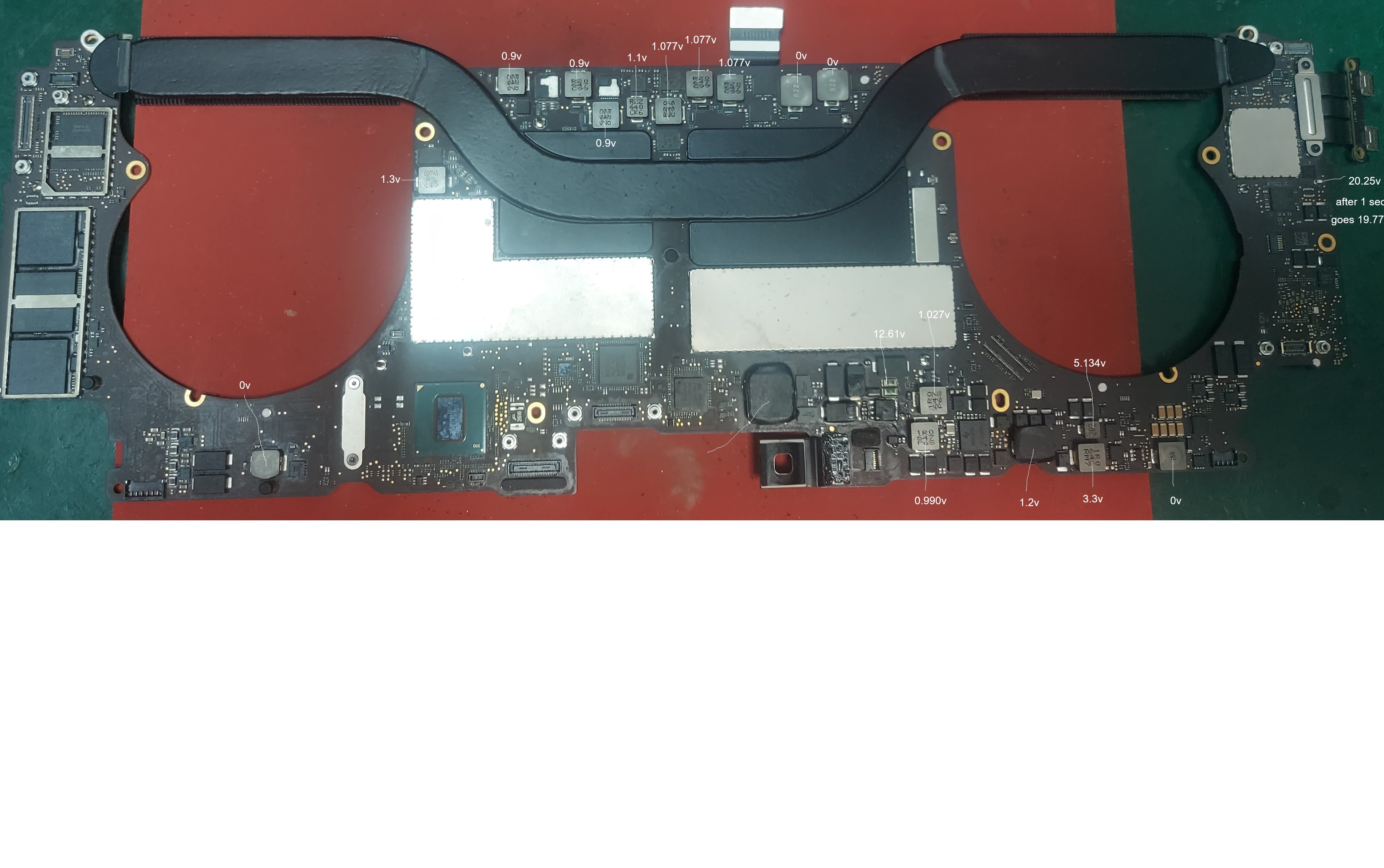

    require some help on this 820-00281-A macbook motherboard came in dead and the pch bga U1100 (SR2NH), u5000 , Q7056 , U7000 and bios U6100 ,looks like these have been tampered with ..also the battery is swollen..
    adapter usb c 20.5v 4.7a 96w , i persume it should power on mb without battery..
    update:
    when adapter plugged in , power switch which 3.3v on it , when power button pressed both fans come on after 6 secs for about 20secs approx then goes off , nothing on the display stays as blank.. the voltage at the usbc out start from 4.96v to 20.25v after 2 to 3 secs they drop to 19.77v
    attached a photo of the mb with all the voltages on the top side which i managed to note down are wdotted down on the attached photo of mb,
    i only get these voltages when the battery is disconnected and the adapter is connected, when battery flex is connected the macbook does not respond to anything no voltages except the usb c voltages
    i was thinking of flashing the bios to start with but not able to find the right one for it , so have not touched until i get a repnse from yourside
    these voltages i only get when the battery flex is disconnected from the mb
    thankyou in advance

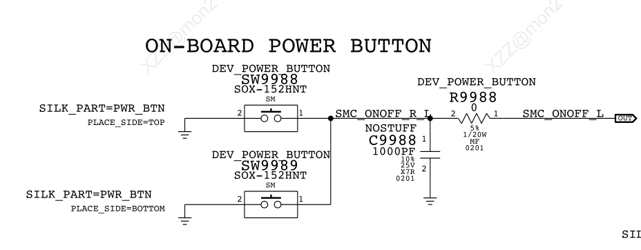

                Fan spin often is linked to missing the detection of the sensors in the trackpad. This results in high fan spin and the CPU will be throttled.
                Disconnect the trackpad cabling and test if the results are the same. The logic boards should feature shorting pads to mimic the power on/OFF button using tweezers.

                  Without trackpad the fan spinning super fast, like turbine. Shorting pads of DEV-POWER BUTTON do nothing.
