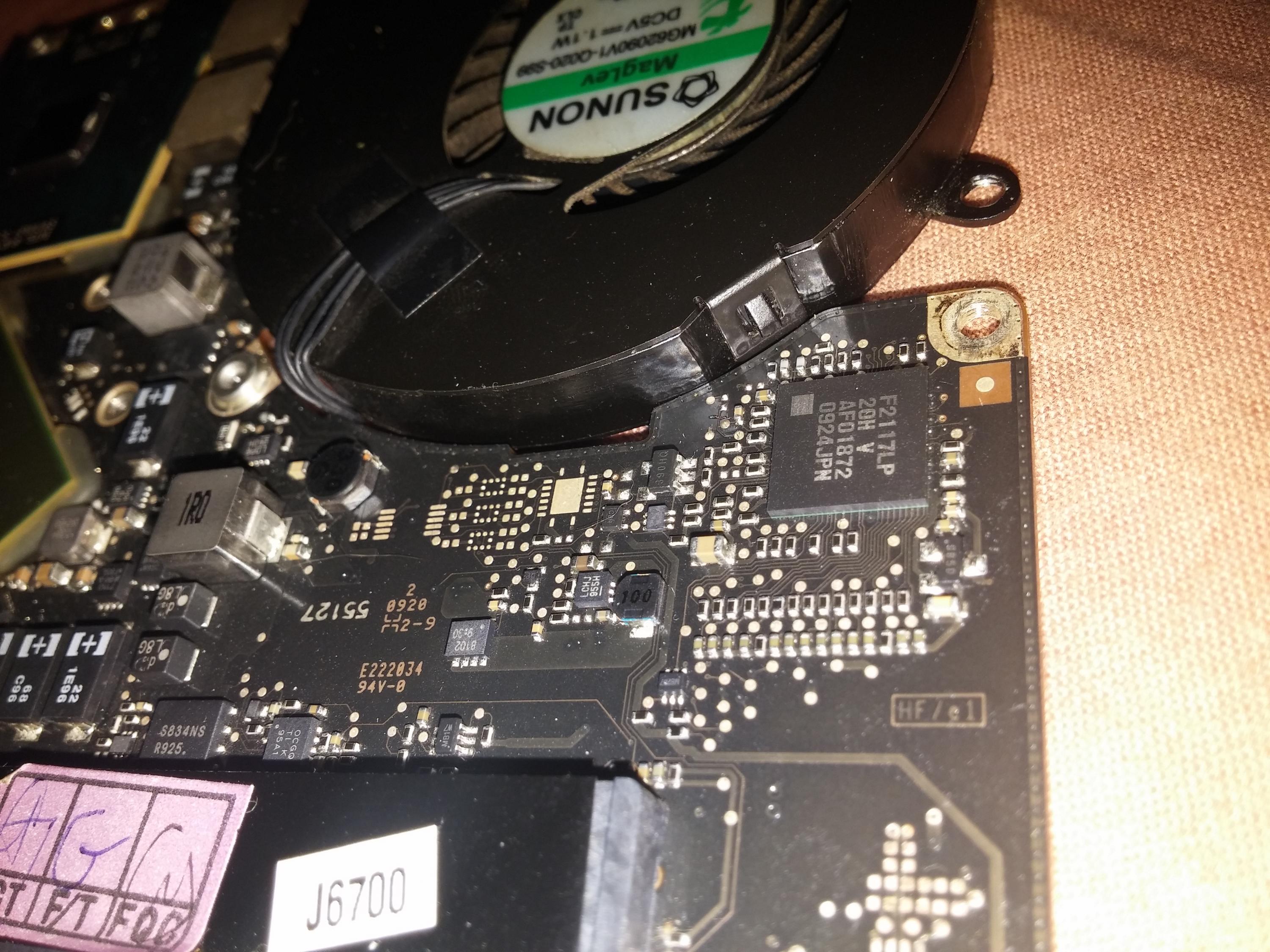

          Re: MacBook Pro 2.66Ghz mid2009 MB 820-2523-b to repair
          Originally posted by dellxps15
          check boardview pressing N and look for smc_onoff_l
          u should have one spot in the other side of the board, hear hdd cable keyboard cable, speaker cable..... that zone. and yes they are 2 bigger pads near smc chip u4900. if magsafe has green light try shorting that 2 point with a tweezer. let us know if macbook start.
          Hi, can u please tell me more precise where it's those two pads ?
          I think this is somewhere around here, cercle in white are SMC_ONOFF_L circuit.

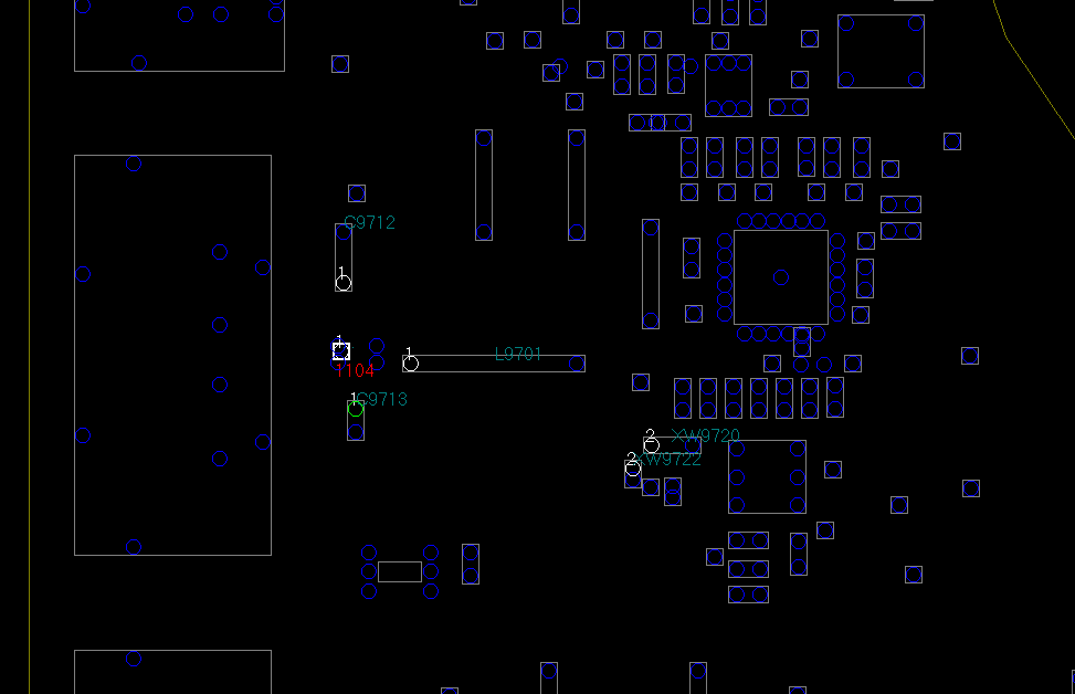

            Ok sry i wasn't understand what you mean.
            I have shorted SMC_ONOFF_L (probe 1330 Pin1) to the ground (C5710, pin2, GND, probe1) , did the probe shorted have any importance ?
            The Motherboard have start, fan spinning at maximum. So i rebuild it on the Mac, and test it but no change happen
            Thanks for your help.

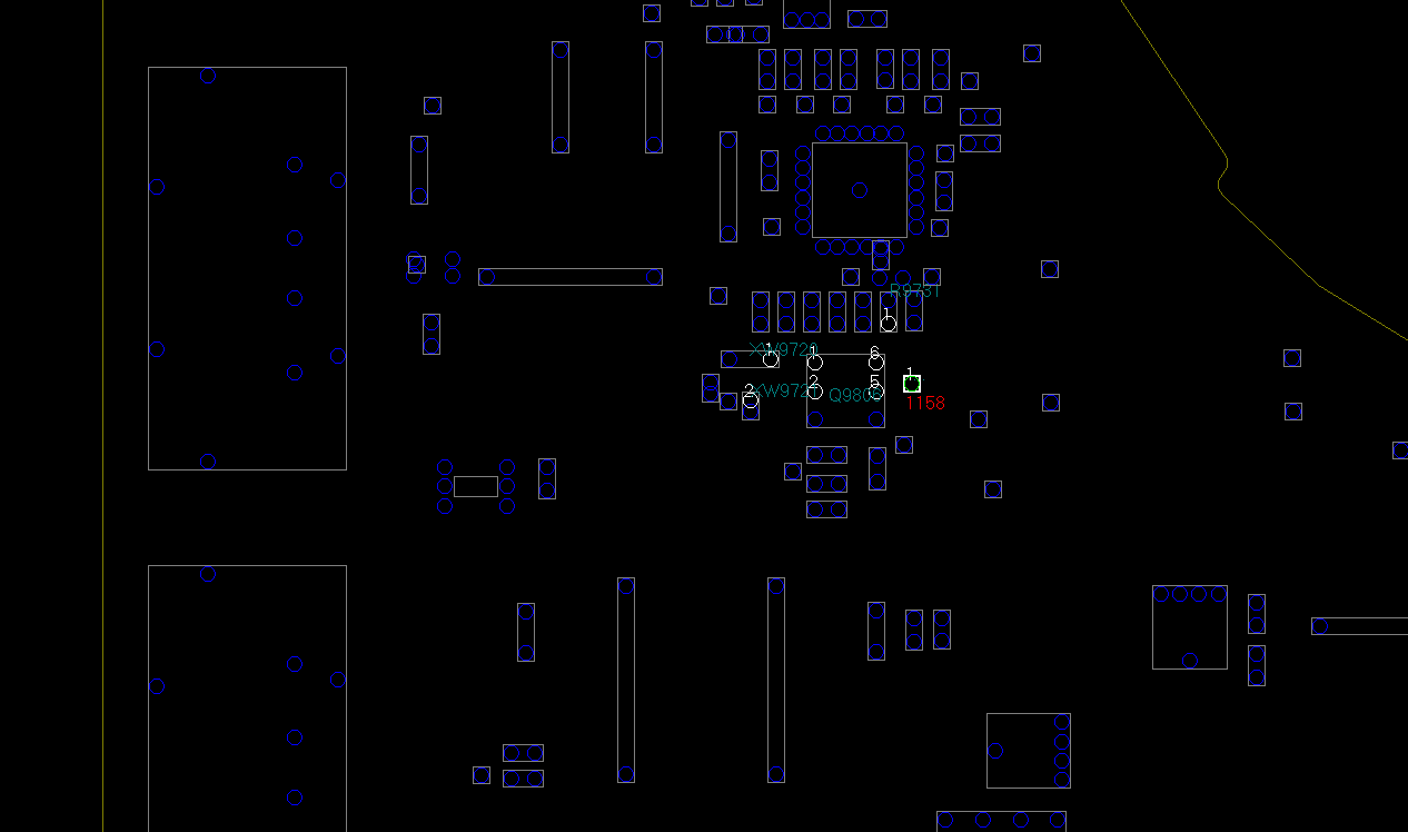

                  • Hijo
                    • Feb 2016
                    • 22
                    • Belgium
                    #29
                    1st put back heatsink with thermal paste.
                    Done.
                    second look on boardview (keyboard connector) without keyboard plugged in and look for smc_onoff_l pin (should be number 5) and short it with ground.
                    Already done for first diagnostic, macbook start, no change.
                    macbook start too ?
                    MacBook start when shorted pin5 to Ground but then i have no acces to the coil. So i have shorted SMC_ONOFF_L (probe 1330 Pin1) to the ground (C5710, pin2, GND, probe1) to have acces coils.
                    when doind that bypass, check again coils volt voltage.
                    L9701: Pin1: 0.00V (after unplug magsafe, on power off: 1032 to 600 ohms on pin2 then 330 to 440 ohms on pin1 and then, each times begin at 100 and stabilize at 399ohms on pin1&2)
                    Pin2: 0.00V
                    L7260: Pin1: 2.92V
                    Pin2: 3.34V
                    L7220: Pin1: 4.24V
                    Pin2: 5.06V
                    L9560: Pin1: 1.72V
                    Pin2: 1.82V
                    L9510: Pin1: 1.10V
                    Pin2: 1.10V
                    L7030: Pin1: 12.60VV
                    Pin2: 8.80V
                    Pin3: 0.00V
                    L8920: Pin1: 0.95V
                    Pin2: 1.00V
                    L7770: Pin1: 1.06V
                    Pin2: 1.06V
                    L7560: Pin1: 1.05V
                    Pin2: 0.97V
                    L7330: Pin1: 1.40V
                    Pin2: 1.50V
                    L6995: Pin1: 3.24V
                    Pin2: 3.41V
                    L7660: Pin1: 0.74V
                    Pin2: 1.06V
                    L7100: Pin1: 0.02V
                    Pin2: 0.02V
                    L7101: Pin1: 0.02V
                    Pin2: 0.02V
                    EDIT: I have tested PPVIN_BKL and have 0.00 Volts on each probe.
                    PPBUS_S0_LCDBKLT_FUSED: 12.6V Probe:1157 Pin:1 part:...
                    PPBUS_S0_LCDBKLT_PWR: 0.00V on probe: 1158 pin:1 part:...
                    SO i suggest Q9806 is the culprit..
                    Thank for your help !

                      That would be dependent also on backlight enable. PPBUS_SO_LCDBKLT__EN_L if this is also setting at 12.6 volts it means it is not turning on so Q9806 will not turn on. What is Probe 1158 and 1157?

                        edit: f9800 should be ok.
                        check r9809 if 147k and voltage both side.
                        report q9807 voltage pin 2-3-4-5

                              #34
                              R9731 & R9701 have 0.00 volt on each side. (running or not)
                              Q9807 have 8.71V on Pin3 and 0.00V on other pin. (0.02V on pin6 when logicboard running)
                              R9809 have 9.69V on Pin1 & 8.70V on Pin2. (running or not running)
                              Can you tell me how can i take measure for 147k and what is it please ?
                              thanks.
                              I think a prrobe is a way, a circuit. probes have the same name so, for example SMC_ONOFF_L is always on probe 1330.
                              Hope this answered your question
                                At first look it would seem the circuit is working as there is voltage drops through the circuit. I will have to look up the specifications to make sure 2.91 volts will turn on Q9806. Q9806 may be bad but something on it's output could had damage it. With the unit off you might want to put your negative/black probe on the output of Q9806 and the positive probe on gnd. and set your meter to it's lowest Ohm scale and see what you measure. You are reversing the probes from how you would read a voltage reading because you do not want to measure through the protection diode built in to Q9806.
                                147K just means the 147,000 OHM resistor which is label R9809 If you look just below the R9809 you will find the 147K
                                So what I can tell from the data sheet Q9806 should be on. I would still Ohm out its output, but I believe this P-channel FET needs to be replaced. I have attached its data sheet. You may also want to wait til dellxps15 confirms this.

                                        Q9806 has a 12.6 volt reading on the source. It has a 9.69V reading on the gate. There is a -2.91 drop from gate to source. Threshold for turn on is -0.8 volts gate to source. The drain has 0 volts on it. If you follow the drain output it will go to a voltage divider of a 300K ohm to 100K ohm before enable and IC. One side of the 100K Ohm resister is tied to ground. This ground will be felt on the drain of Q9806 to complete the circuit from source to drain of Q9806. Q9806 should be turned on with the-2.91 volts and the 12.6 volts should be on the drain. The junction of the 301K ohm and the 100K ohm should measure 3.15 volts. The junction of the resistors is on page 85 section B6. 301K ohm resistor is R9731?
                                          ur right but why q9807 pin5 is 0volt ?
