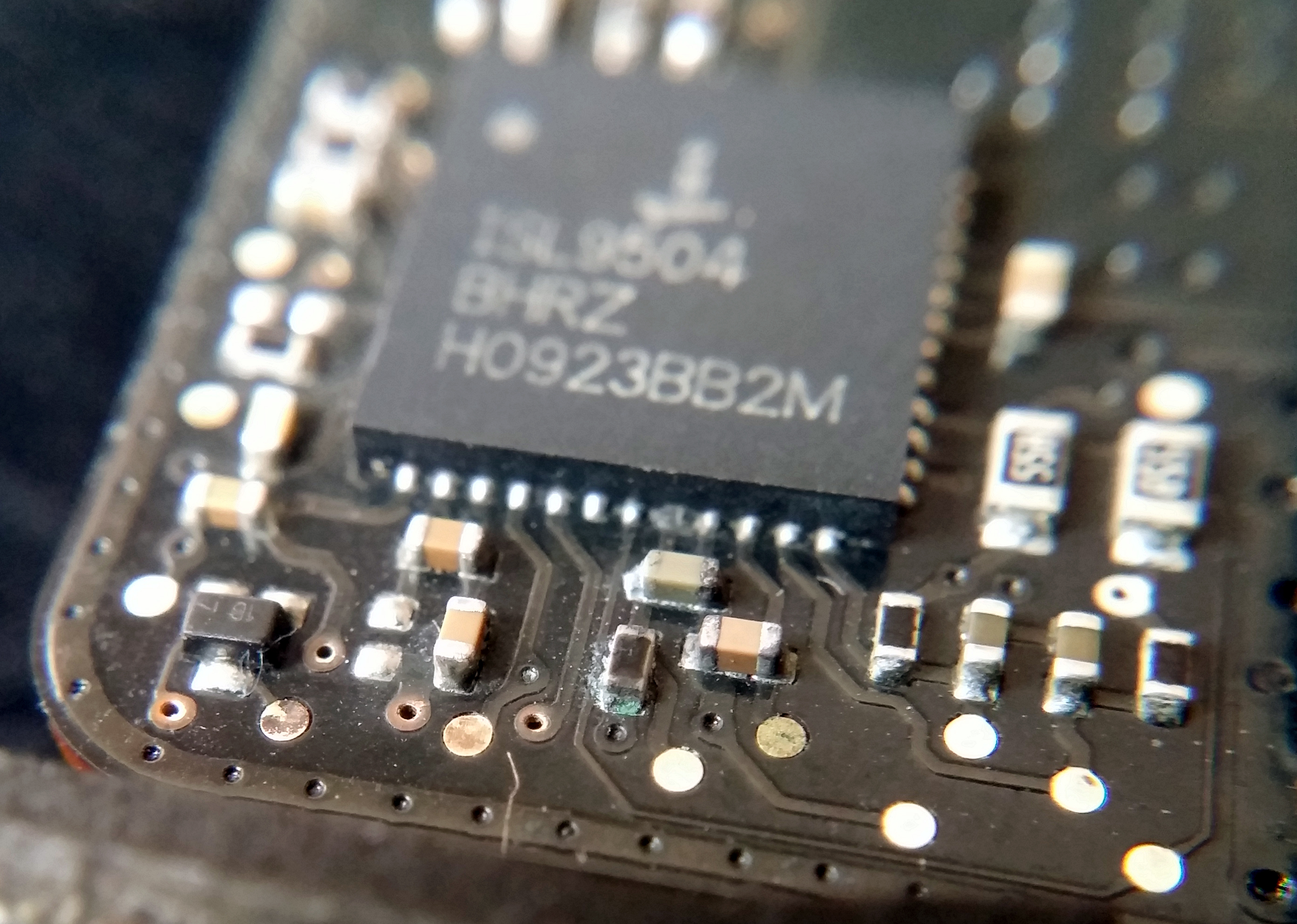

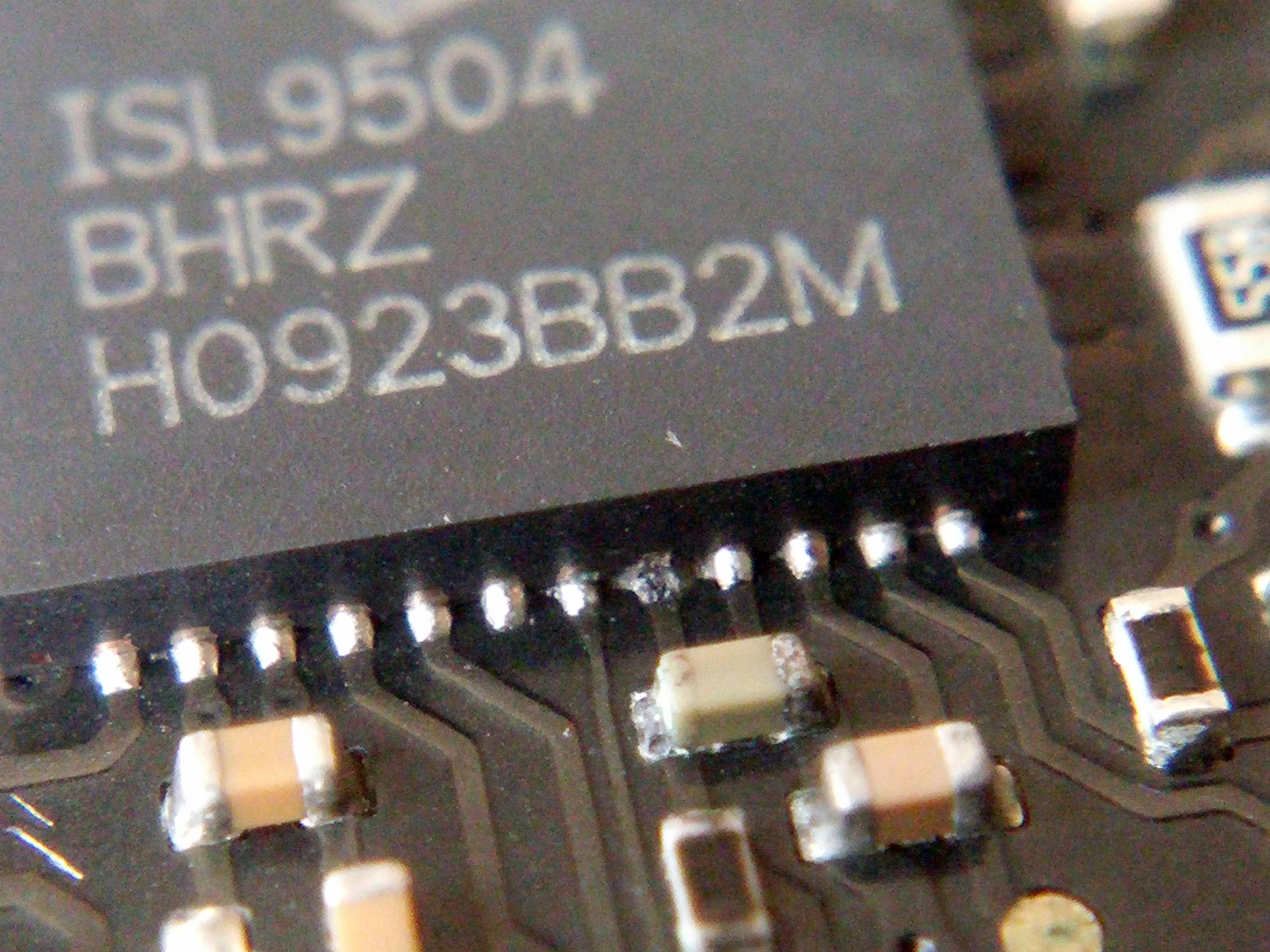

                Nice one, Pin20 was corroded with R7120. I have clean this space with 94°Alcohol and now we can see the pin20 and R7120 sux. (pic attached)
                Edit: I've just broke R7120 by trying take continuity on it. I'm gonna wait to receive precision probes i have order, to take voltage, because the space between the elements is very small.
