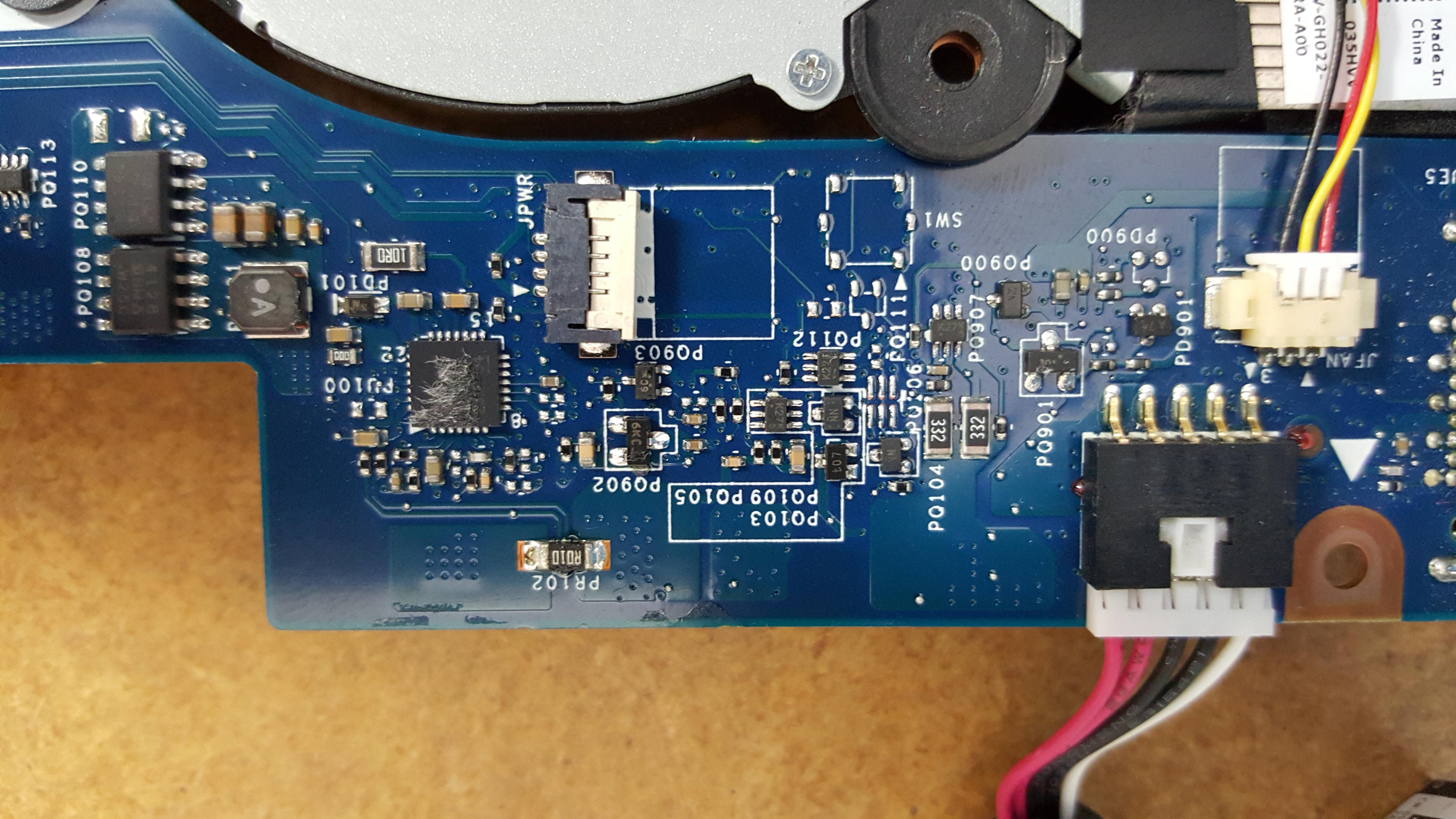

    Dell Inspiron No Power SHORT
    Dell Inspiron
    Reg Model P25F
    DPN PGMYp A02
    Mobo qcl00 la-8241p rev 1.0 a00

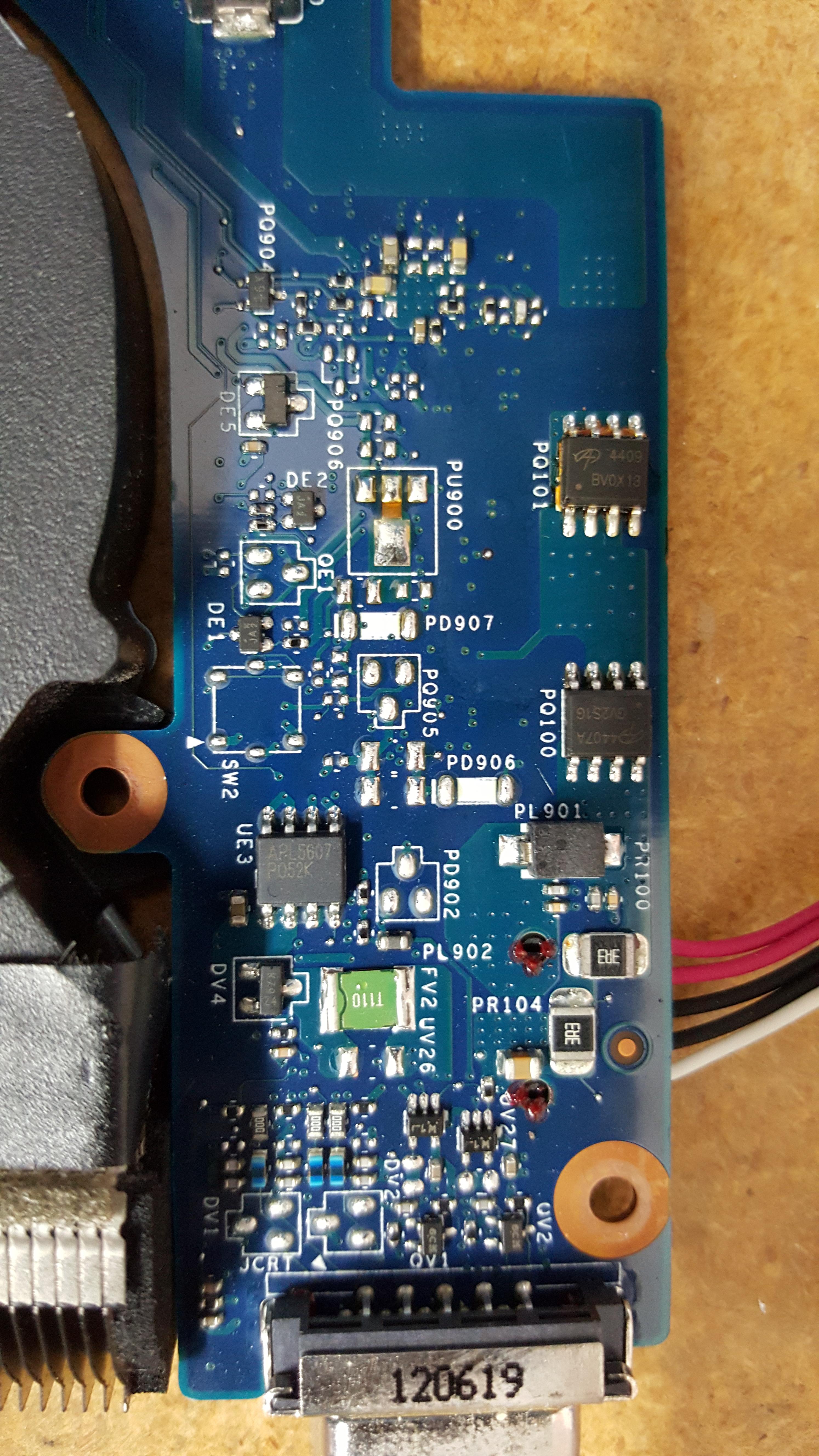

    Immediately after plugging in power the LED on the power brick shuts off. P-channel FET PQ101 (alpha omega 4409 https://cdn.badcaps-static.com/pdfs/...ddc92bc03e.pdf) was shorted from when measuring across drain-source (all pins). I replaced the FET and the light on the LED stayed lit for a second then I smelled magic smoke. Tested FET and it was shorted. It has an internal diode across the drain-source which is what I am guessing is shorting.
    How do I figure out what is causing the short?
    Any help is much appreciated.Thanks

    Re: Dell Inspiron No Power SHORT
    inject voltage
        start removing tiny non-polar capacitor to find out short one of charging section.
          So, I found one that was shorted but how do I determine what value it was supposed to be?
            remove it and check it will start without this cap.
