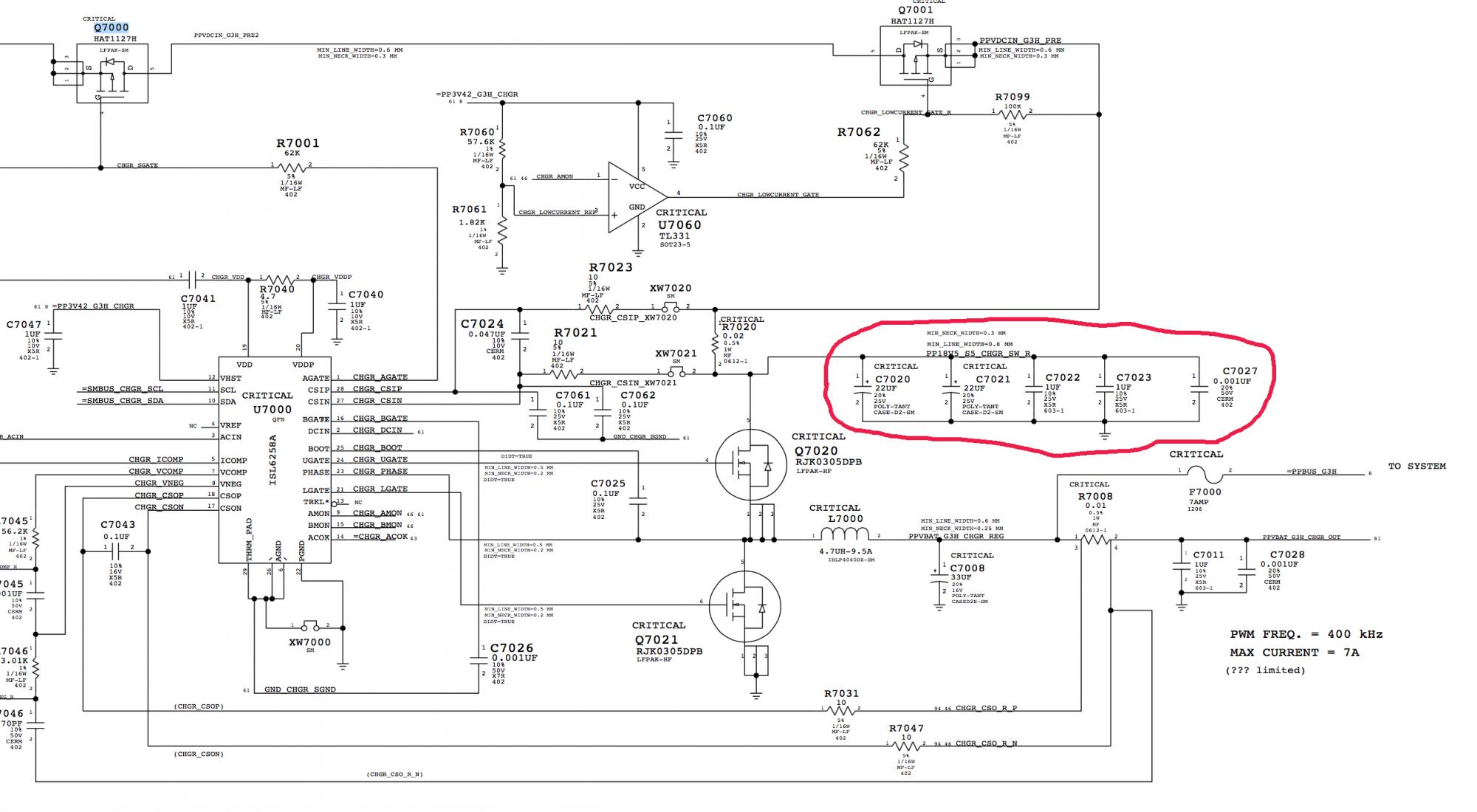

    For the first time I'm trying to repair a Macbook logic board
    No green light on charger (just a very low alternative light switching between green and orange), SMC bypass not working. No sign of life whatever I do ! System is also not doing anything when trying to start it from a known good and fully charged battery !
    I got schematics and brd and I started to look for the issue !
    What I've seen when the magsafe power is connected is :
    - Fuse F6905 is OK
    - G3Hot is OK (3,44V)
    - Q7001 pins 1/2/3 are 0V (instead of 16.44v as measured on another board) ! After checking, it appears that it is shorted with ground ... What I've also seen is that U7060 output is 0v (instead of 14.36V as measured on another board).
    - Q7000 almost OK (pins 1/2/3 : 16,97V, pin 4 : 15,44V but pin 5 which is connected to pin 5 of Q7001 is -0.06V instead of 16,97V)
    At this point it is not clear to me where I should check to continue progress ! Could anyone help me to understand what could be the issue ?
    Check page 59 of attached document to find schematics related to my issue
    Thanks !

      Pin 5 (ACIN) of U7000 is 3,95V not sure if it's OK ?

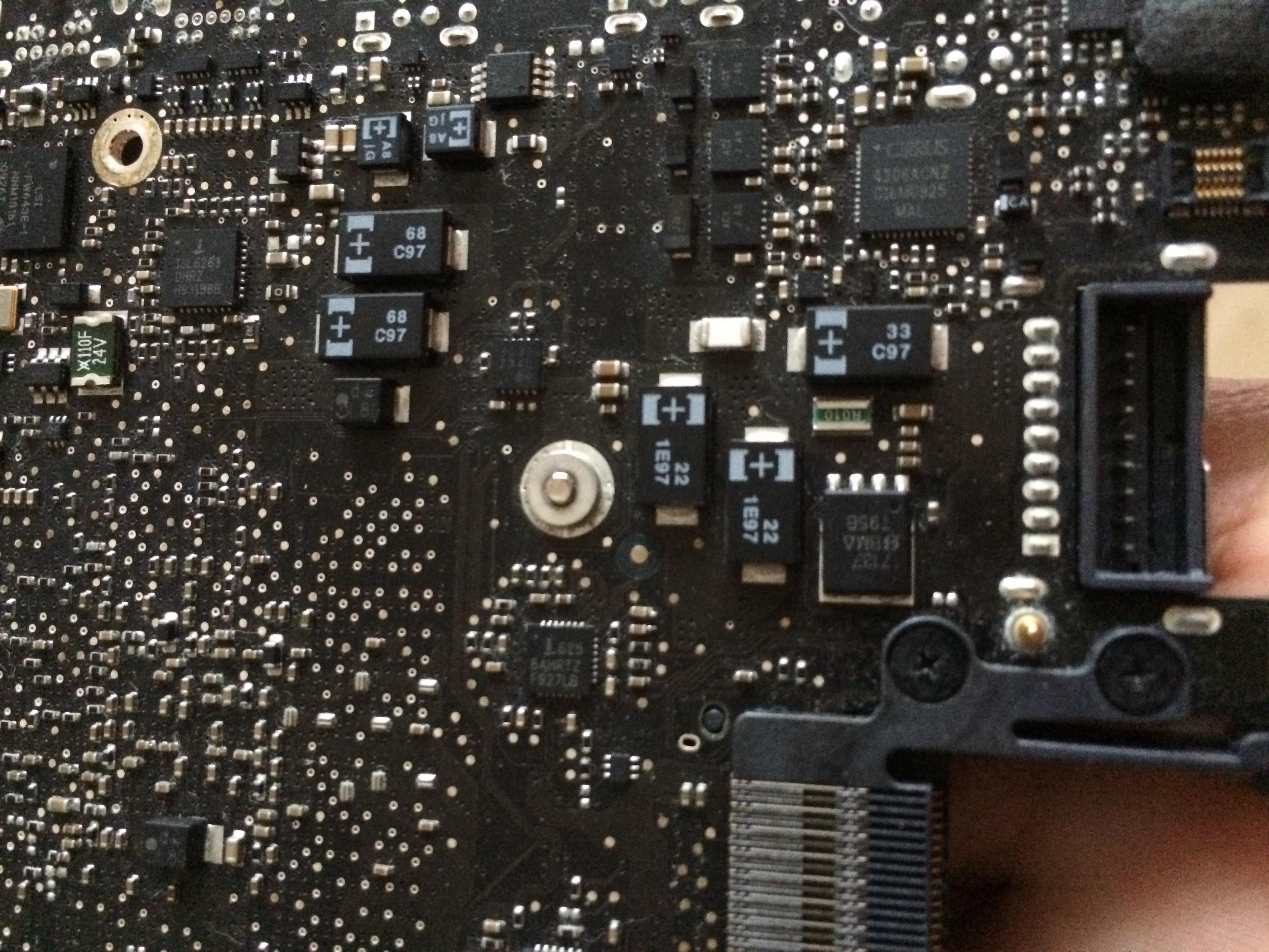

      I've found that C7020/C7021/C7022/C7023/C7027 capacitors (parallel mounted) are grounded (O ohm to ground) ... Maybe one of them is dead ? I guess that I have to remove them to check them, but before doing that I'd like experts point of view ...
      About pin4 of q7000, I have a working board (a little bit different as it's a late 2008 and not a mid 2009) and when there is no battery plugged (not tested with battery plugged) I have the same voltage on pin4 of Q7000 !

        Ok I removed C7020 that was actually the problem ! At least a part of the problem !
        Now the Macbook is booting from battery but not yet from magsafe (led is now low intensity green)!
        I'll try to find a replacement capacitor and see how it's working once replaced
        Could anyone help me to find the reference of this capacitor ?
        It's one with 22 1E97 written on it, the data sheet gives :

            Regarding the capacitor I have to replace, I think that it's the package is "EIA 7343-20 (Kemet V, AVX Y) : 7.3 mm x 4.3 mm x 2.0 mm".
            I just have to find some of them online now

                      Pretty sure CHRG_DCIN should be the voltage that the main power rail coming in reads. Around 16V-18V.
                        Re: Macbook 13" A1278 2009 (K24) No power
                        You're right, on a working motherboard I have 16.55V for CHRG_DCIN !
                        VDD & VDDC are supposed to be 4V also ...
                        I measure 96kohms between VDDP & ground on a working board, on the broken board I measure 0 ohm ...
                          check if l7000 is shorted.
                          check if q7020 q7021 are shorted.
                          if not remove u7000 and see if pin 2 voltage comes.
                            Q7021 seems to be shorted (between pins 1/2/3 & 5, I have 42 ohms in both ways)
                            How to check L7000 ? It seems to be 0ohm, but I have the same when checking L9701/L7400/L7401 ... I not sure my multimeter is very precise (I'll test with a better one tomorrow if needed) ...
                            I've ordered a replacement chip for Q7021 (RJK0305DPB), I'll have to wait to receive it to check if it solves all issues ...
                            Thanks a lot for your help
