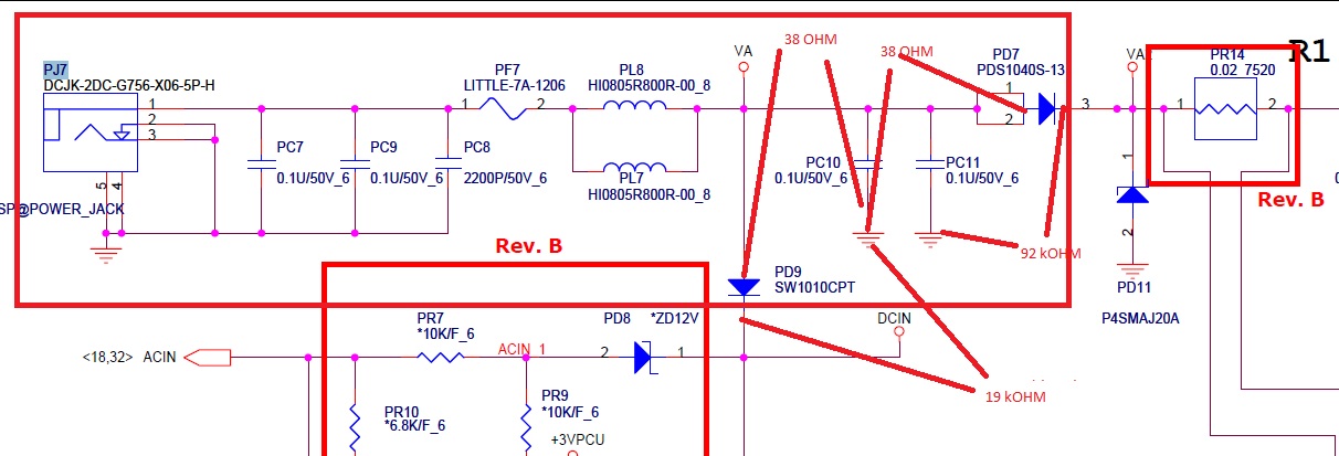

    Hi, i got this notebook and it has blown charger. The DC jack was burned and work only by battery. It wont charge and i have 28ohm between + and -.
    Please advise what to check. On pin 19 of PU11 i have no shorting.
    I do not understand where go "VA" on page 33.

    Re: Acer 7730ZG power problem
    i think "va" is voltage adapter, so its 19v. after system protection and stabilizing was ok, become vin as voltage input to dc/dc regulator.

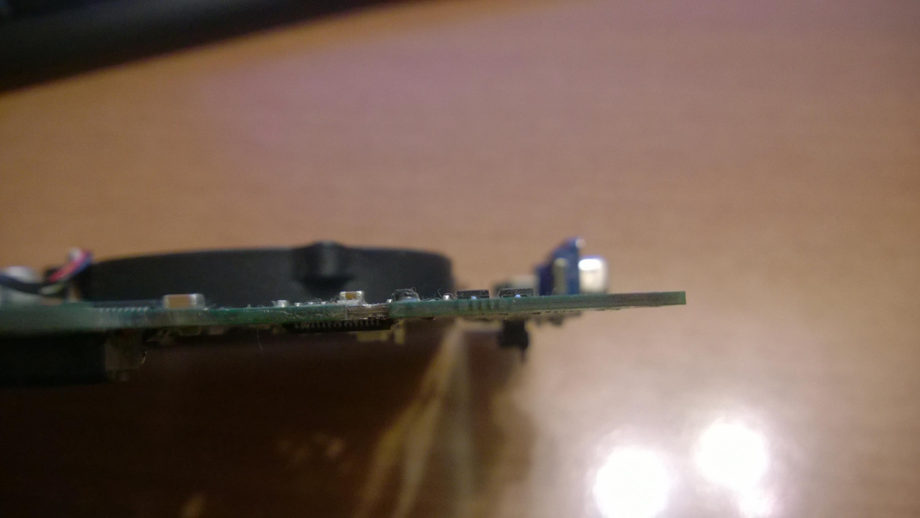

                    uhh i think i found problem. When the plus pin from DC jack burned it connected the layer inside the board. I try to poke it with wooden stick and it changed resistance to 150kOhm.
                    here is the pic.
                    how can i fix this??
                    ...the quieter you become the more you are able to hear...

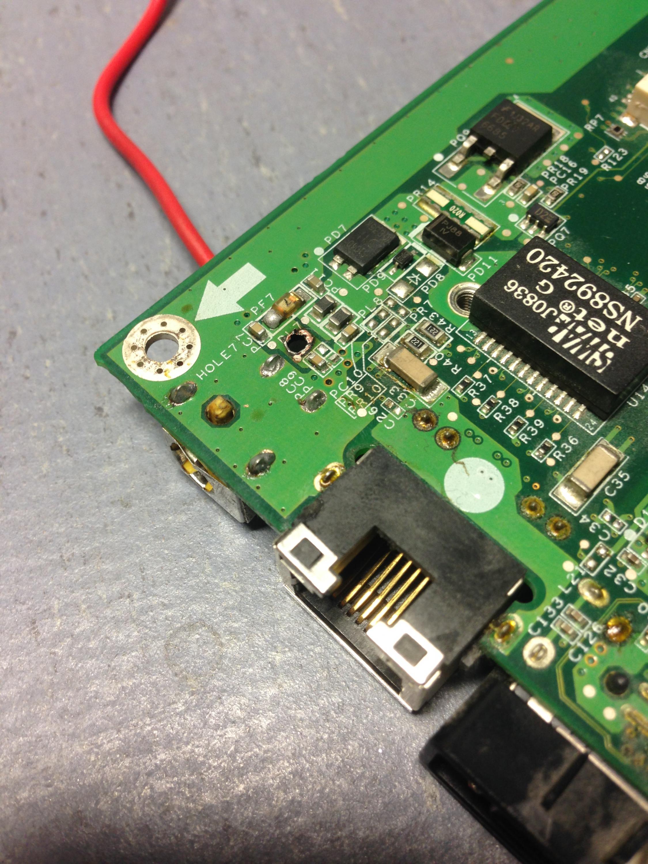

                              This is why photos should come first - it would be obvious from the damage to that hole, that it's the first thing to check
                              Maybe you can clear the hole with a drill? Not usually advisable, but in this case it might be a good idea. Then scrape some soldermask away and solder your wire to the trace, through the hole.

                                hello, i chean the burned hole and laptop worked for one day and now again burned in that area. Can i bring 19V from DC jack to battery terminal and with that isolate the DC jack part of board??

                                  my advice is: fixing layer burn is very very hard and when it burn, the smell is terrible.
                                  i tried to fix a board acer with that problem with a dremel and metallic tip. passed it perfectly alligned and straight and orizontal to the hole to try to make each layer isolate. after that a good amount of solder mask can keep the problem away.
                                  that board was almost all killed ans some component in the back was damaged and for a old pentium m740 a good repair worth its value, plus lcd connector on mainboard got burned too.
                                  http://i62.tinypic.com/sdhd1v.jpg

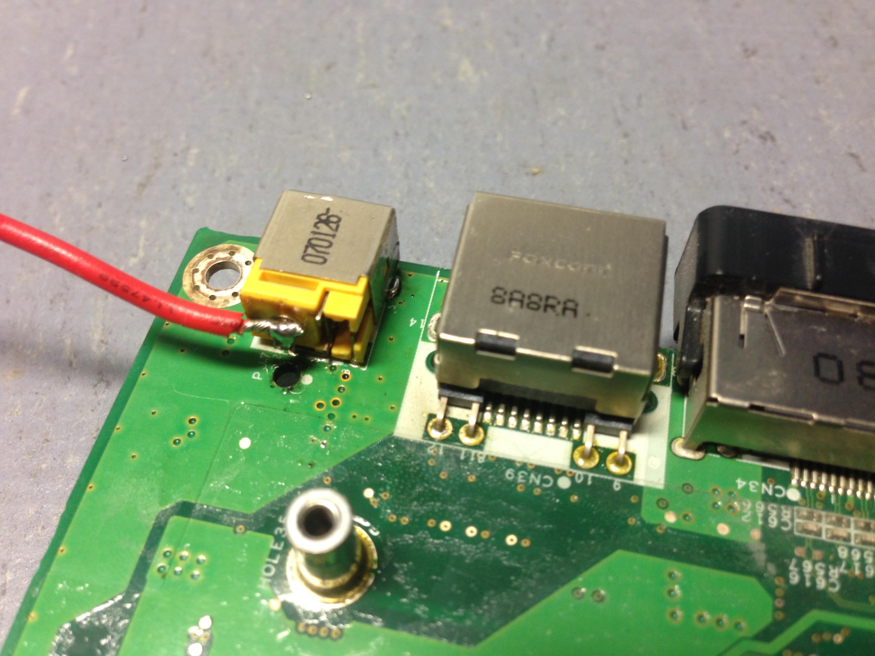

                                    Is there any way to bypass the burned area?? So i can connect 19v direct to some component
                                      Yes, you can connect the DC in to anywhere on the left side of the fuse shown in post 8. The wire doesn't have to be thick if it's kept very short. Wire from an IDC HDD cable easily handles 5A.
