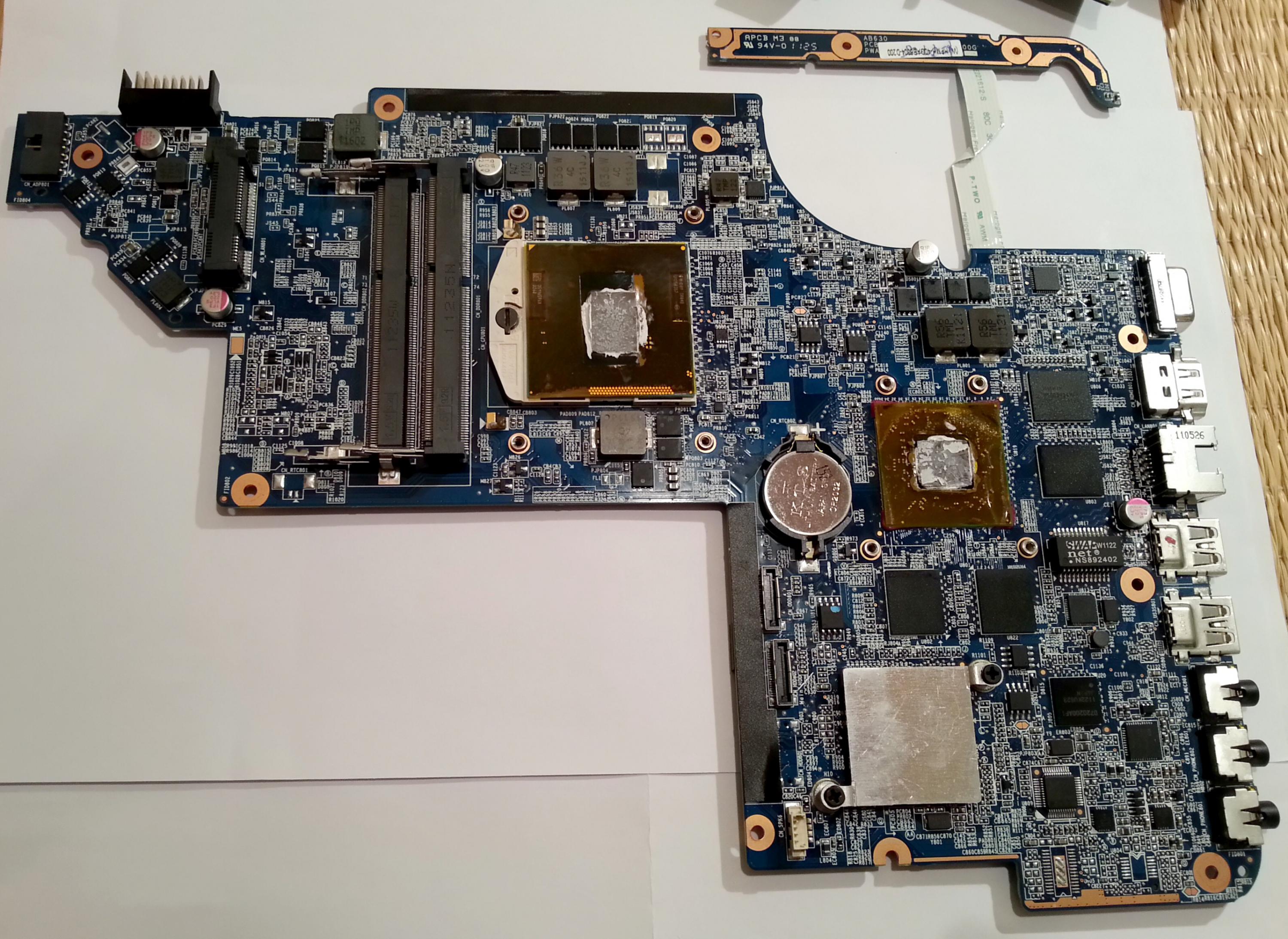

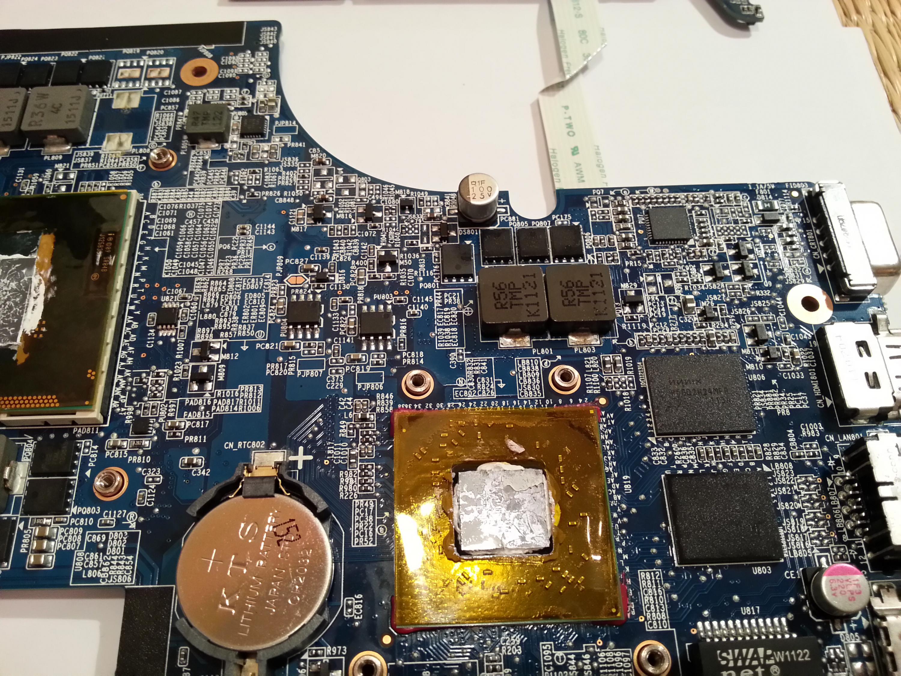

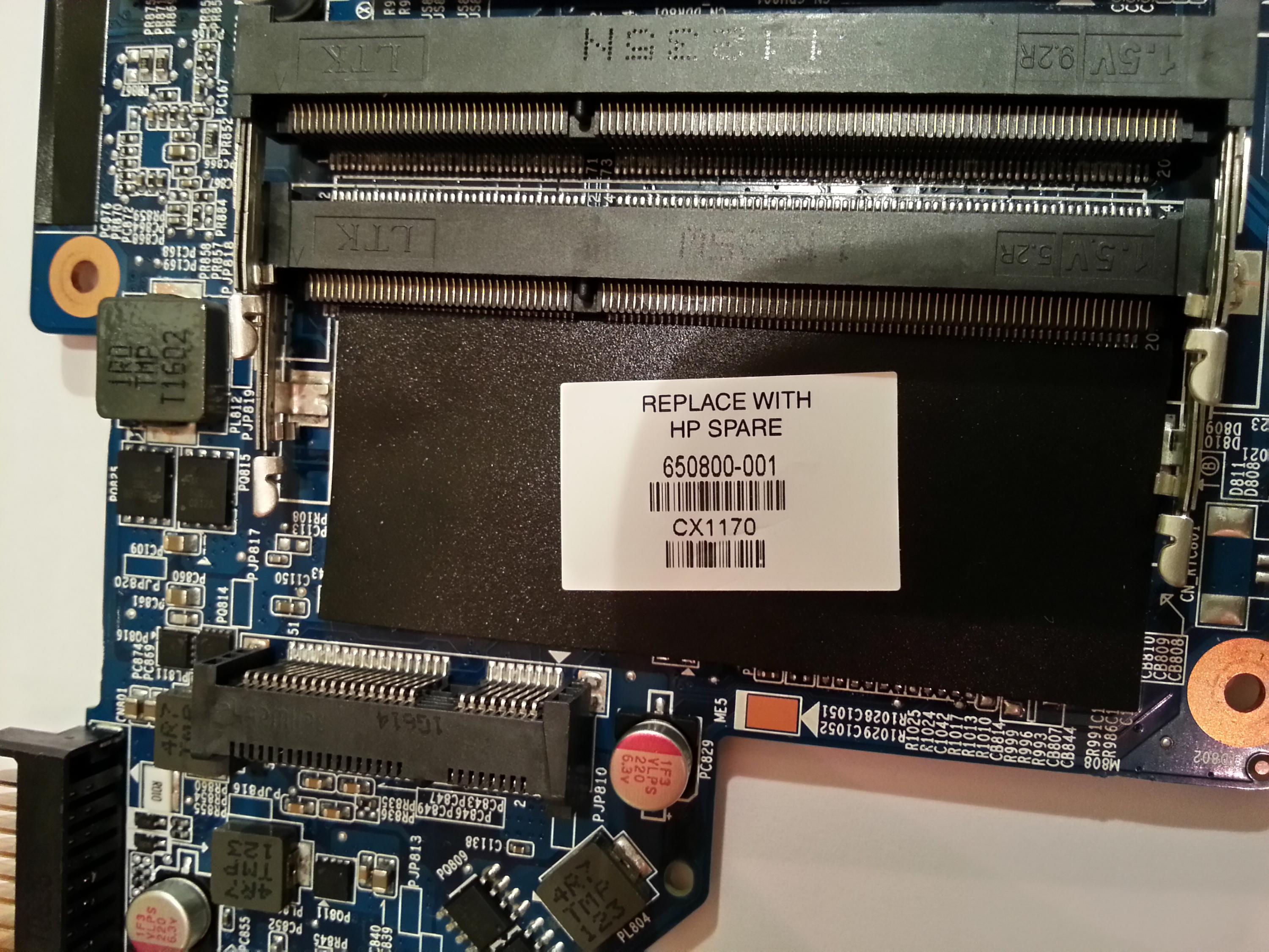

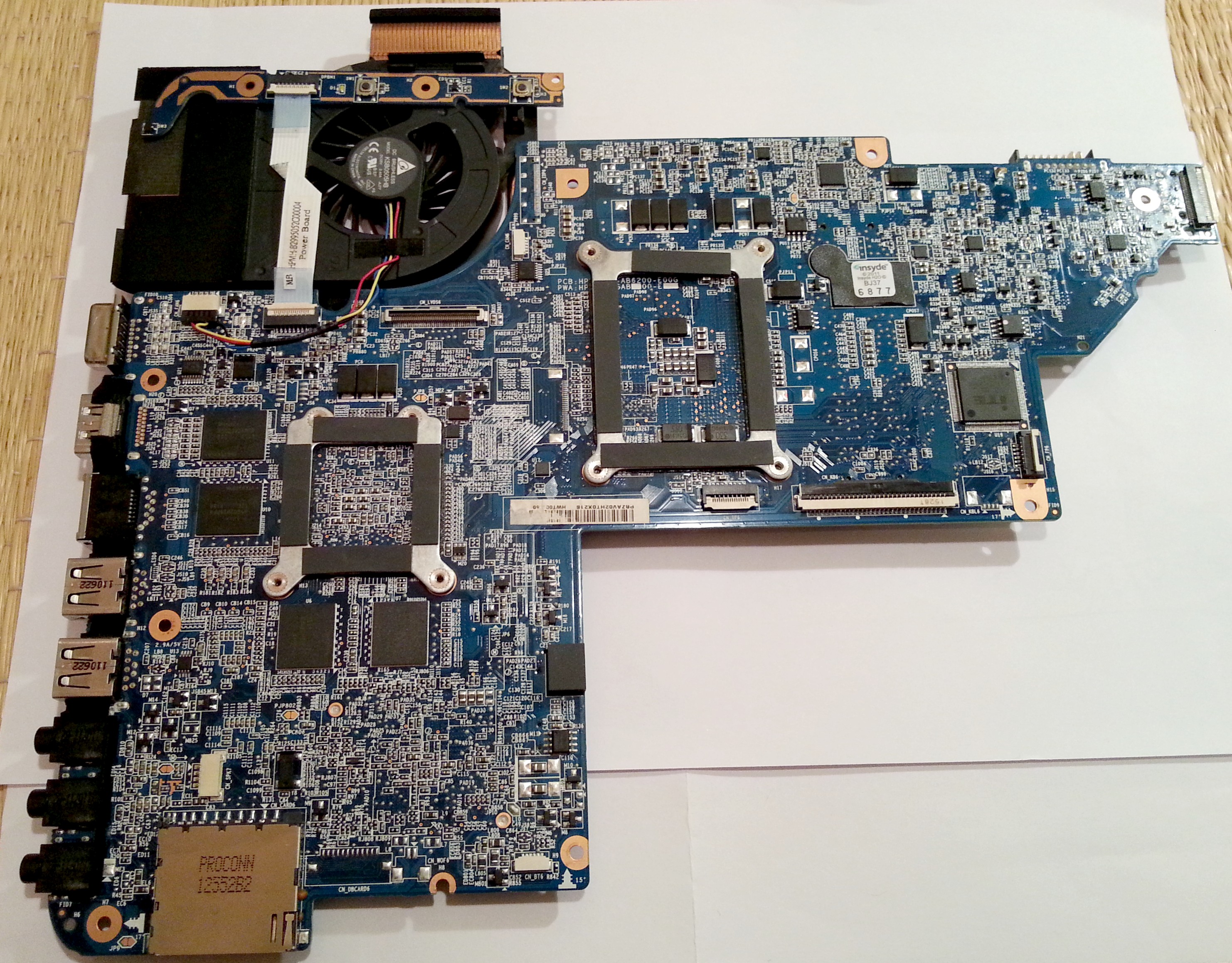

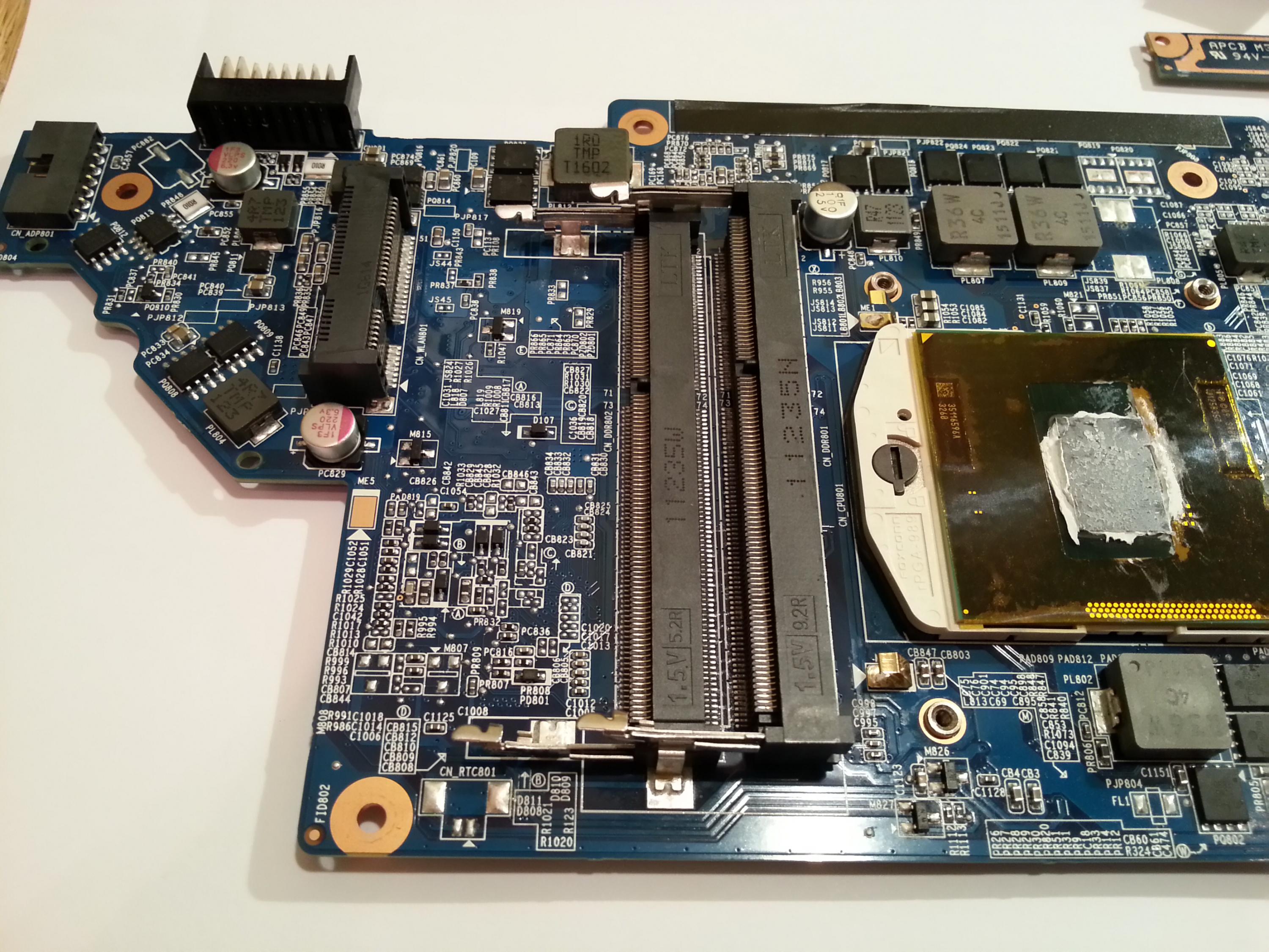

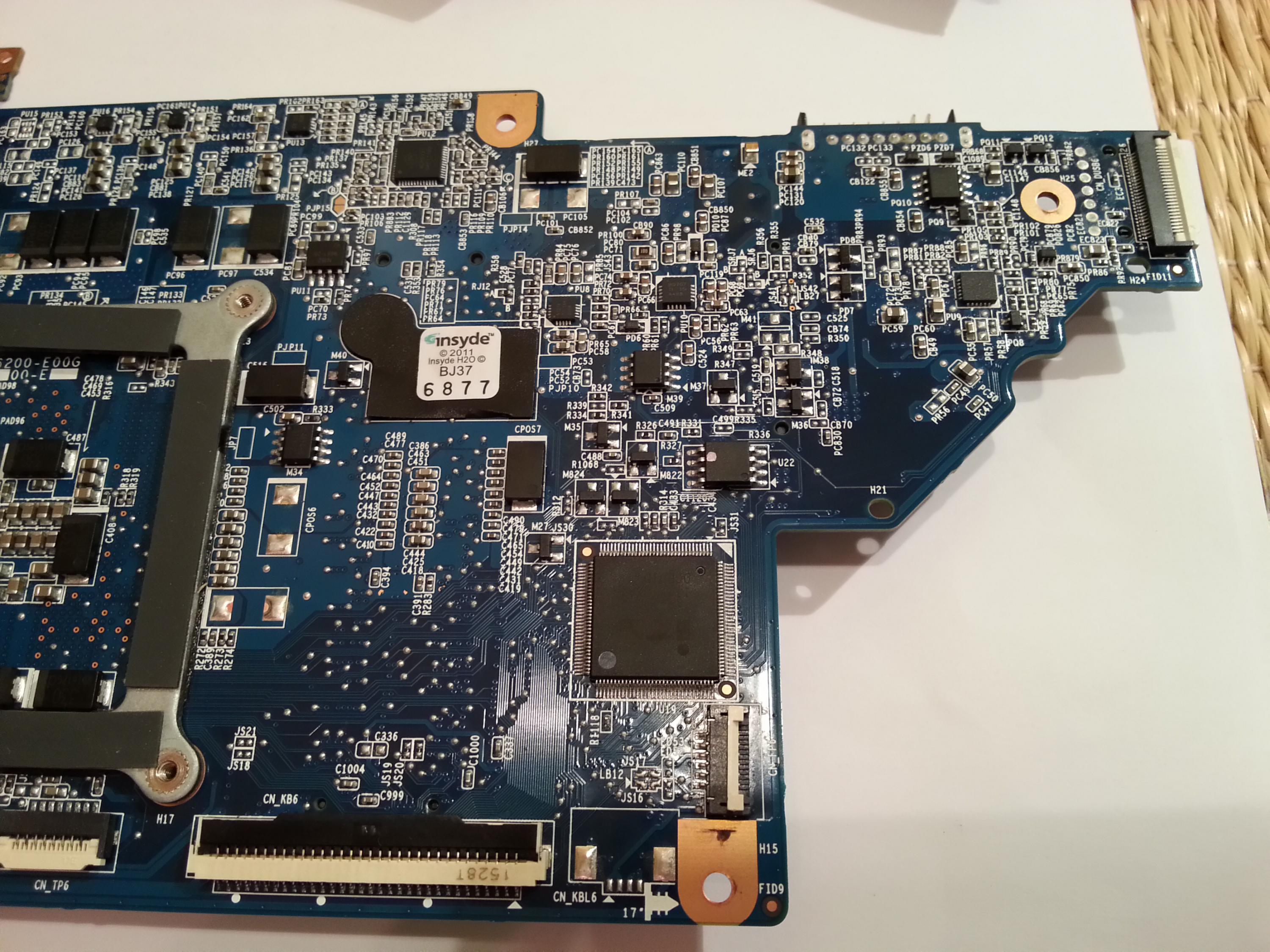

    Hello! :-)
    I got this HP DV6 6170em laptop from a friend to repair it for myself or use it for parts. It's a nice looking laptop with 2GB ATI graphics and 2.3Ghz i5 dualcore CPU. I'm looking forward to repair it and use as my DJ-ing laptop. But...
    Here are some initial facts:
    1. user spilled some cola on the laptop. He immediately powered it off, disassembled (he did quite a lousy disassembling job, btw), he cleaned all cola residue and assembled the laptop
    2. after cleaning he claims laptop worked and powered on few times for some time (15-30min), but than stopped responding
    3. when power button is pressed power LED light up for a fraction of a second, fans spins just a little bit and than powers off. After about 5 seconds it powers on-off again and again in a loop every 5 seconds. (take look at a video)
    4. when in on/off loop it does not responds to anything, not even to long press of power button. It always stays in a loop until battery is ejected.
    5. no any picture on LCD, no backlite
    6. when connected to AC adapter battery recharges OK, battery LED works.
    7. same behavior on AC adapter and on battery.
    8. nothing heats too much. In fact it runs quite cold.

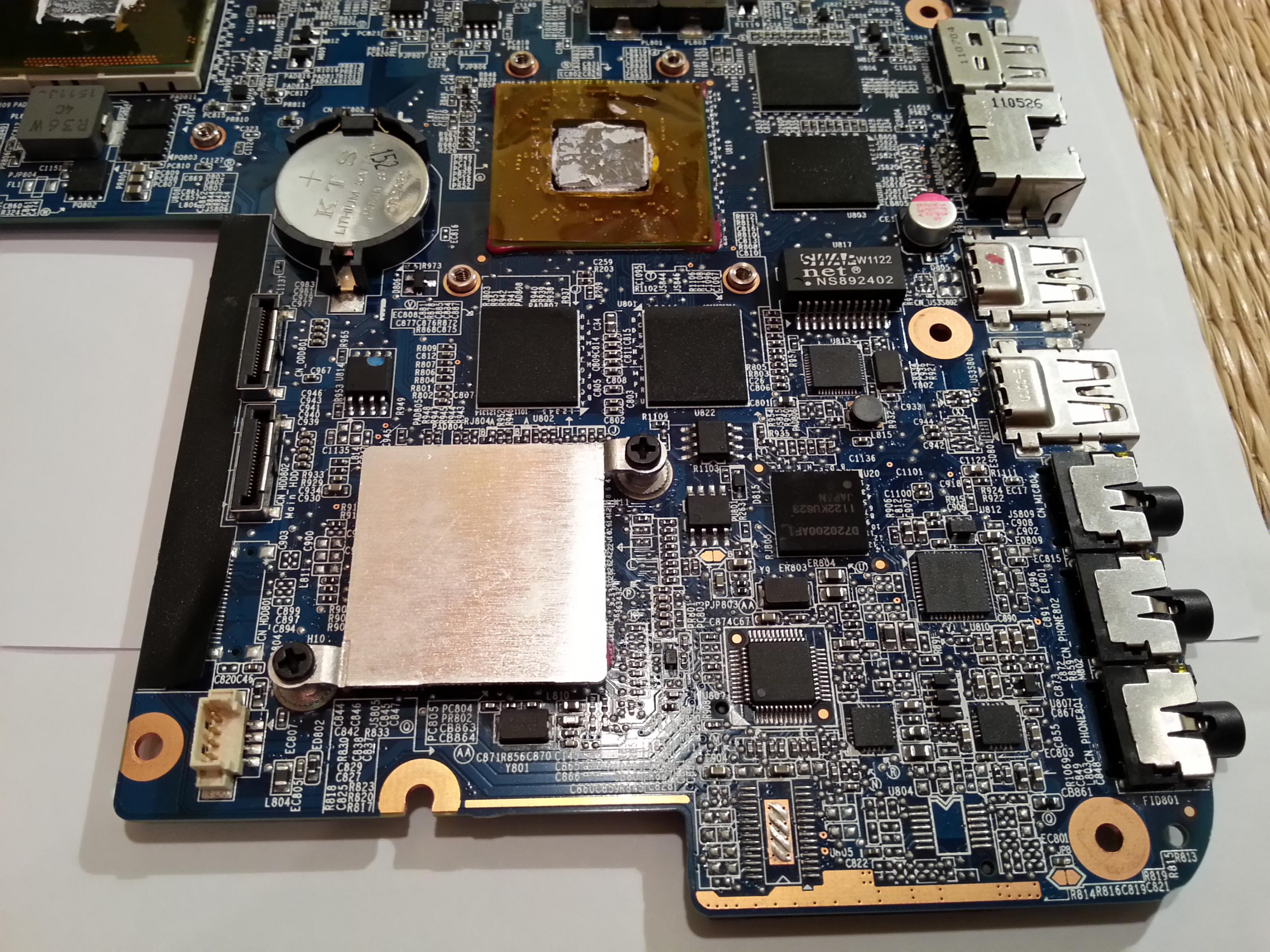

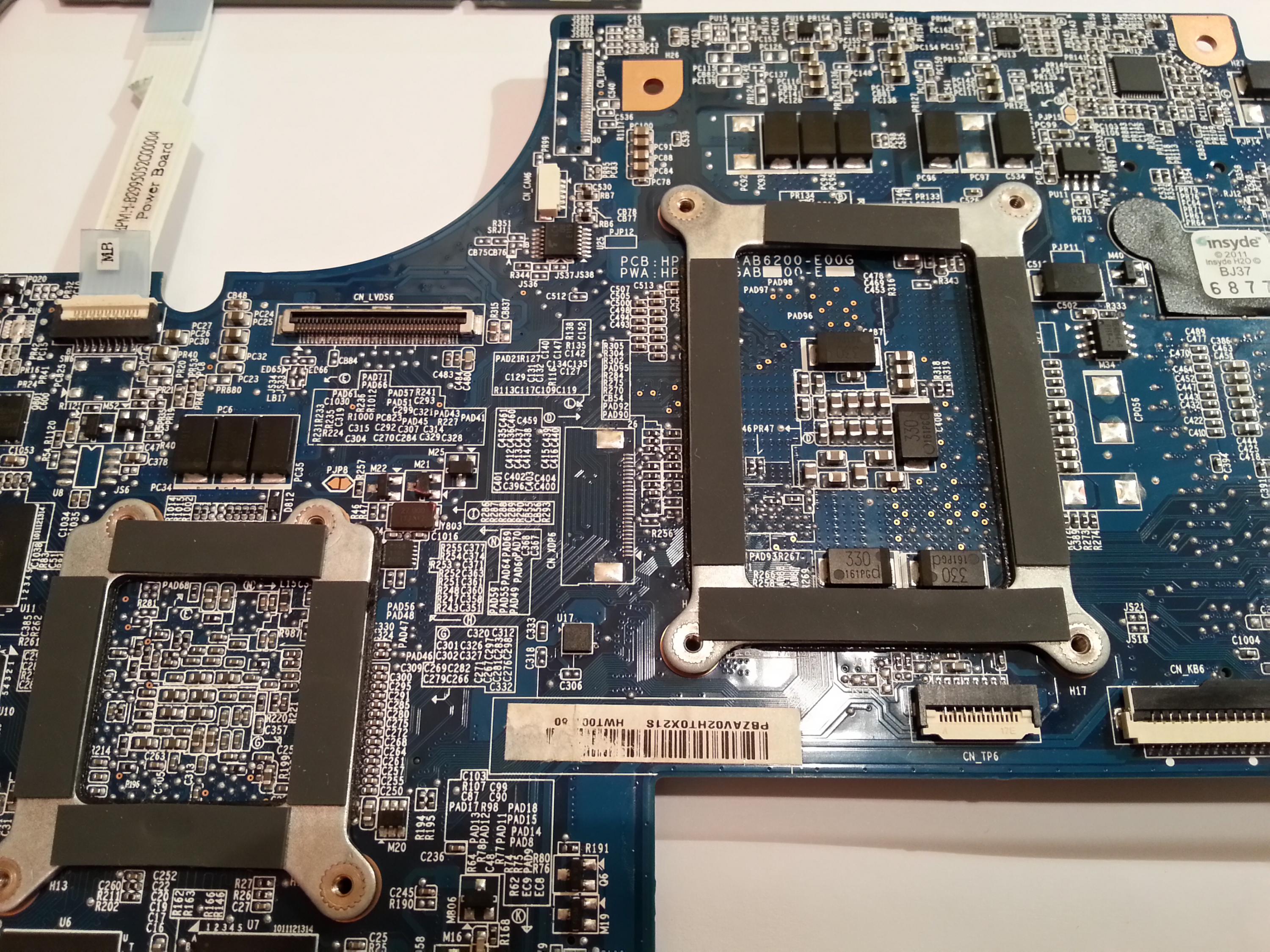

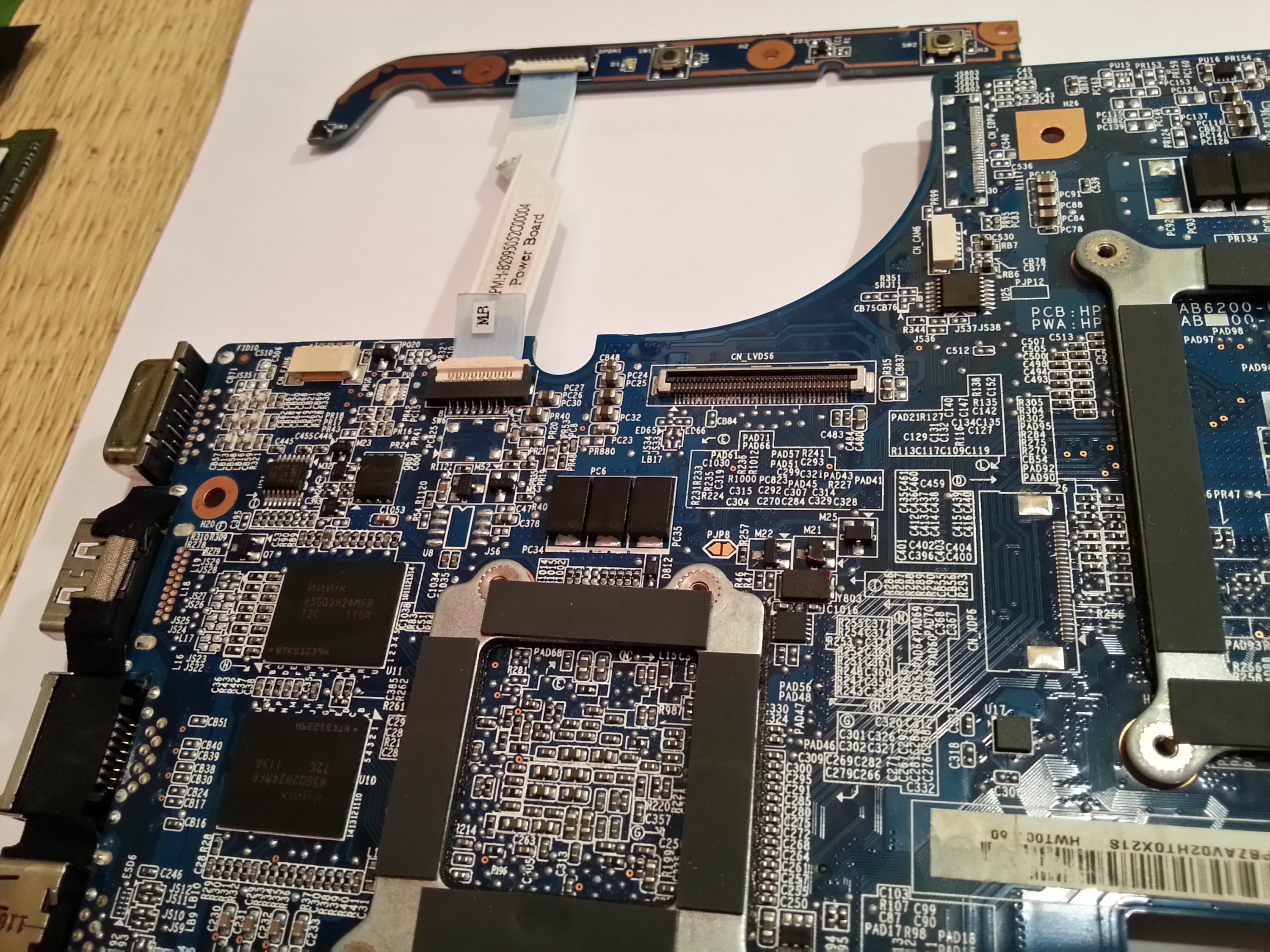

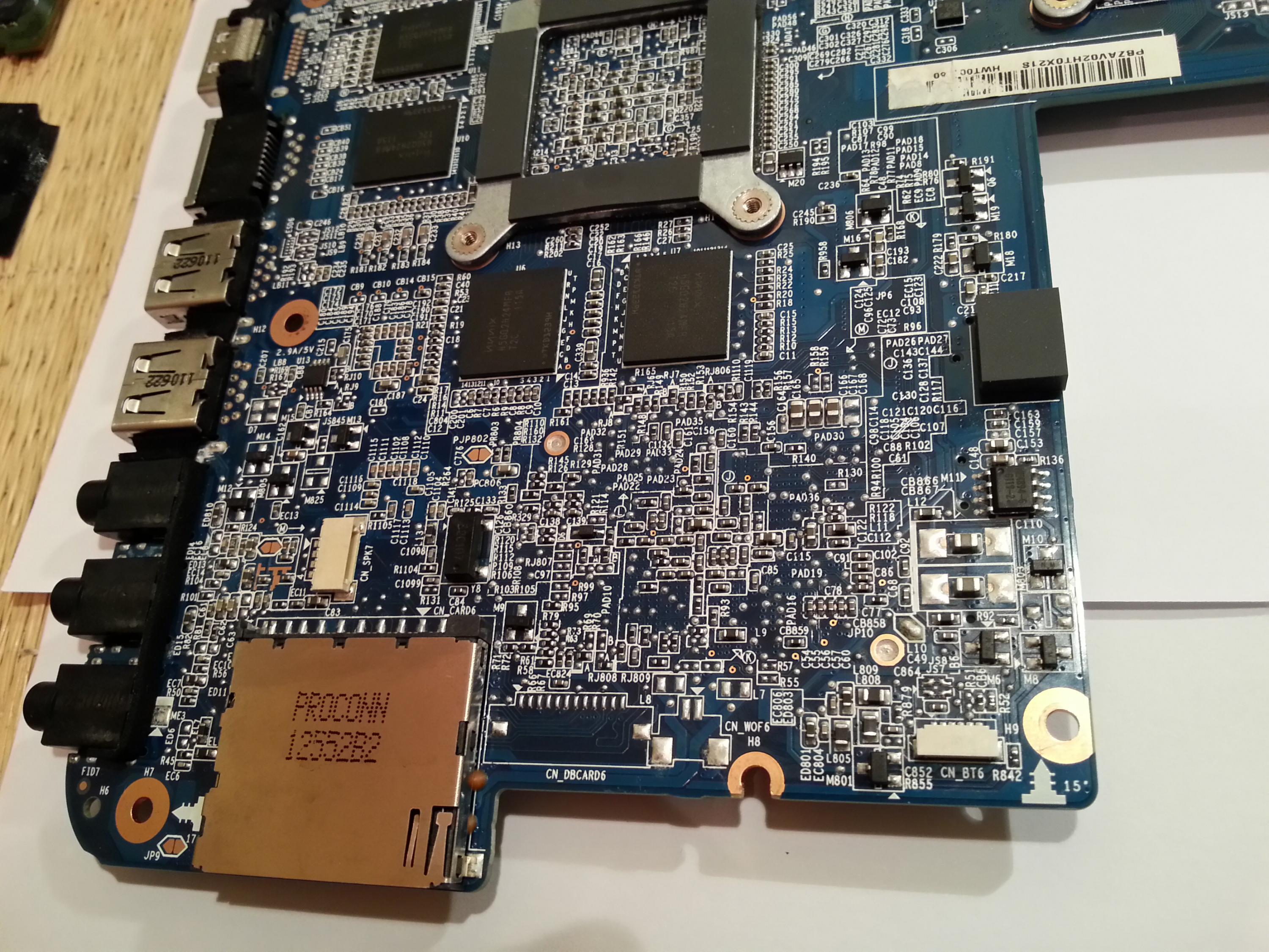

    9. PCB and components look OK, no corrosion or burned components. (take a look at pictures)
    What I did so far:
    1. disassembled the laptop completely step by step following service manual
    2. removed everything removable from the motherboard (heatsinks, fan, RAM, CPU, CMOS battery, insulation)
    3. thoroughly cleaned the motherboard with soap and warm water, than with demineralized water and finally with Kontakt WL spray (highly evaporate electronics cleaning solution) after thorough drying with hairdryer and compressed air
    4. additionally cleaned CPU, RAM and all connectors
    5. result - same as before
    My questions:
    1. what do you think, is there any chance for repair?
    2. what should I try first? What to measure? Power supplies? Where? (I have 60Mhz oscilloscope, DVM, decent soldering station, reflow station...)
    3. is there a chance CPU is dead? How to test it without a spare CPU?
    4. can it be BIOS failure? (keep in mind it does not respond or switch off after long press to power switch...)
    This is my video of the motherboard, powered on and in a loop:
    http://youtu.be/nXX73IDOrv4
    Attached are detailed pictures of the motherboard.
    Any advice and help is more than welcome.
    Thanks in advance,
    Cheers!
    Suad

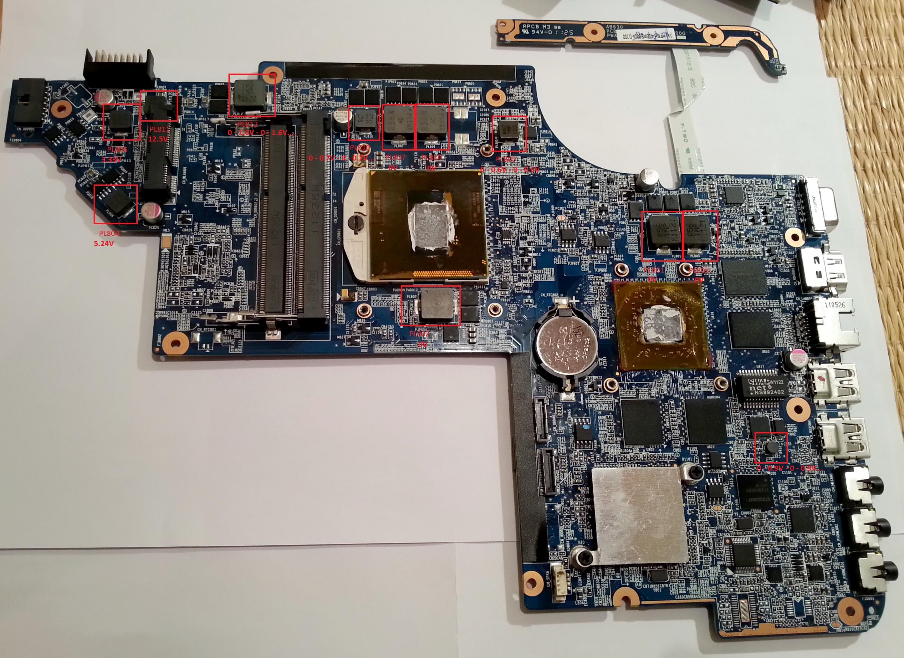

                I checked all coils when laptop is on battery. Some voltages are consistent, some voltages are missing and some voltages shows briefly and insufficient at the moment when power LED flashes and fan spins a little bit, repeats in a 5sec. loop.
                Results:
                PL801 - 0V
                PL802 - 0V
                PL803 - 0V
                PL804 - 5.24V
                PL805 - 0V - 0.6V - 0V - 0.6V... (shows 0.6V briefly in the moment when power LED and fan briefly come to life - repeats in a 5sec. loop)
                PL806 - 3.33V
                PL807 - 0V
                PL808 - not installed
                PL809 - 0V
                PL810 - 0V - 0.7V - 0V - 0.7V... (shows 0.7V briefly in the moment when power LED and fan briefly come to life - repeats in a 5sec. loop)
                PL811 - 12.5V
                PL812 - 0V - 1.6V - 0V - 1.6V... (shows 1.6V briefly in the moment when power LED and fan briefly come to life - repeats in a 5sec. loop)
                L - 815 - 0v - 0.9V - 0V - 0.9V... (shows 0.9V briefly in the moment when power LED and fan briefly come to life - repeats in a 5sec. loop)
                Look at all readings on the attached picture.
                So, it looks to me like it retries to power up but something is missing or shorted... but nothing gets hot as I see.
                What do you think? What to do next?
                Looks like we are making some progress, right? ;-)
                Thanks!!!
                Cheers,
                Suad
                • hazardus
                  • Apr 2014
                  • 105
                  Re: HP DV6 6170em - motherboard dead after liquid (cola) spill. Please help!
                  I don't have the right schematic for this board that's why I wrote the wrong numbers. If you have the correct schematic share it so we can help you. Tomorrow if I'll have some time I'll try to find a schematic for your board.
                  • hazardus
                    • Apr 2014
                    • 105
                    Looks like you have 5V and 3.3V too. So that's good.
                    Next step remove the CPU and check resistance to ground on PL807 PL809 PL801 PL803 and PL802.

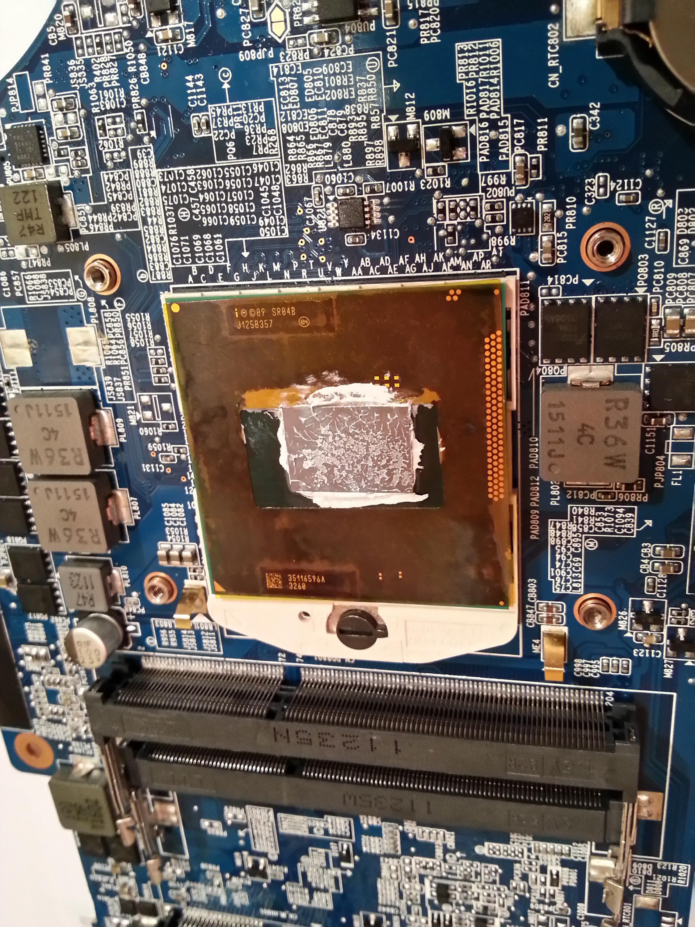

                      Here are measurements to ground (CPU removed):
                      PL807 - open
                      PL809 - open
                      PL801 - 9.5ohm
                      PL803 - 9.5ohm
                      PL802 - open
                      PL810 - 39ohm
                      PL812 - 0.92Kohm
                      PL805 - open
                      PL801 & PL803 9.5ohm?! hmm...

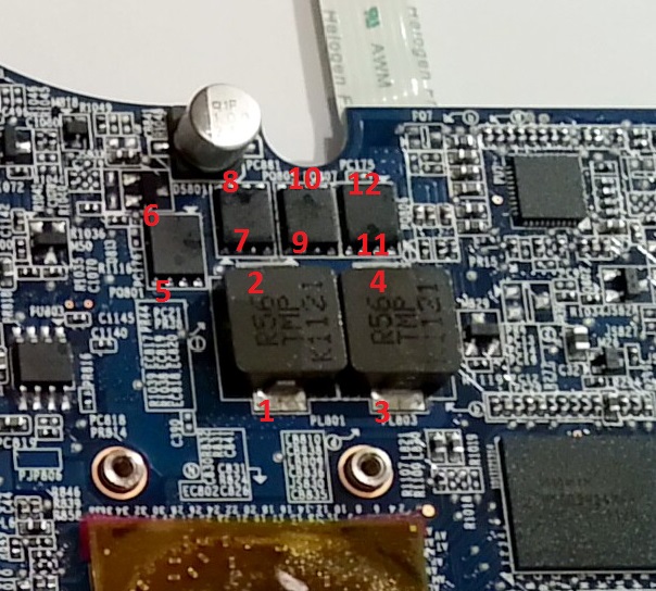

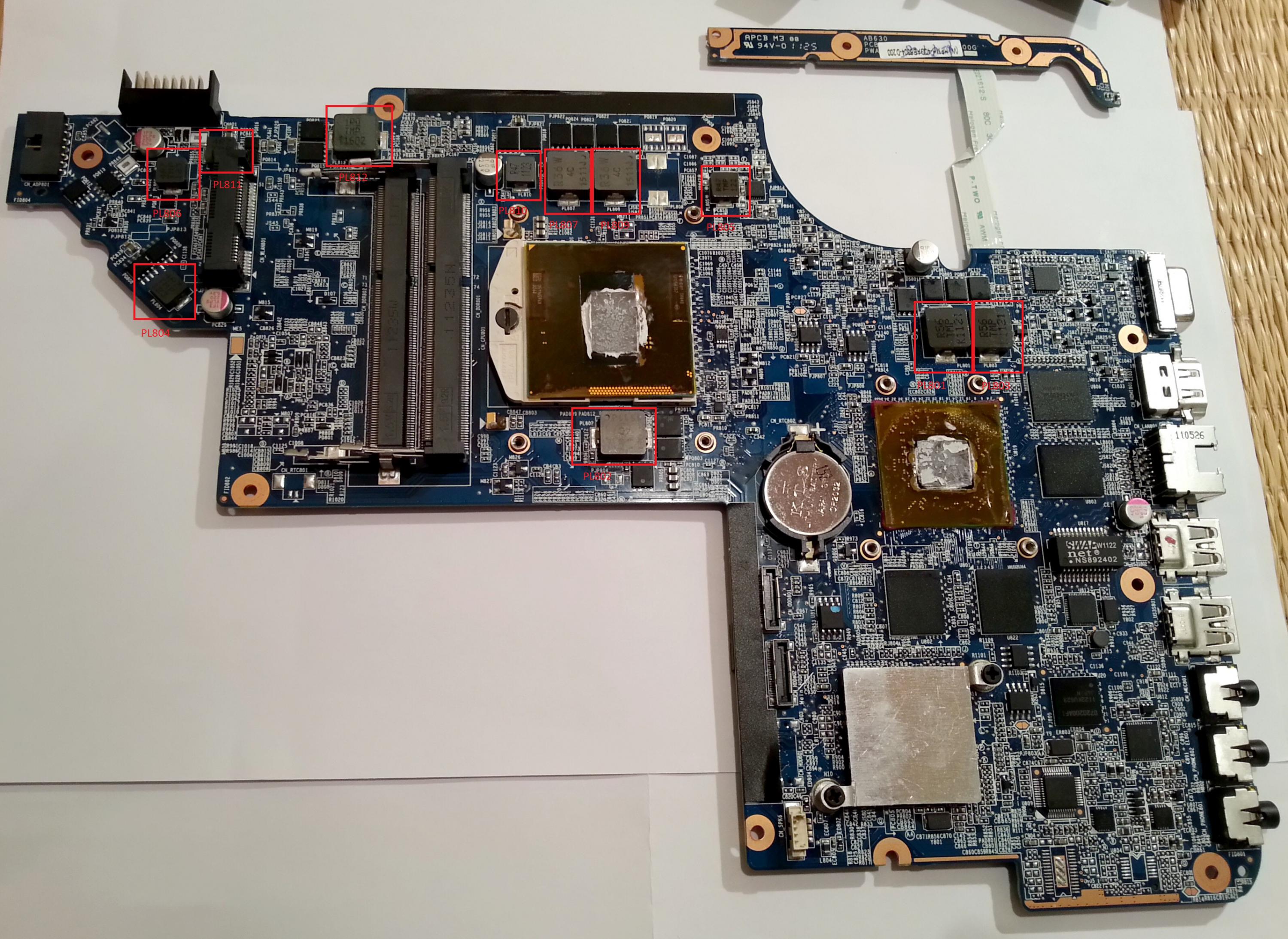

                              It would be great if you can test the following (assuming two motherboards have same components):
                              Check the pictures.
                              Do all resistance measurements with CPU and memory removed.
                              1. resistance between 1 and 2 (important)
                              2. resistance between 3 and 4 (important)
                              3. resistance between 5 and 6
                              4. resistance between 7 and 8
                              5. resistance between 9 and 10
                              6. resistance between 11 and 12
                              7. resistance between 1,2,3,4,5,6,7,8,9,10,11,12 to ground
                              First two measurements are most important, don't bother with the rest if you don't have enough free time.
                              Thank you very much!
                              Best regards,
                              Suad

                                  Don't give up on it! I finally got time to do the resistance measurements.
                                  Sorry about taking such a long time I was really busy with school and work and didn't have enough time disassemble my whole laptop.
                                  Anyway I finally did it... but there is a problem... I forgot the file with the measurements on the computer at work.
                                  I'll try to post them tomorrow afternoon.
