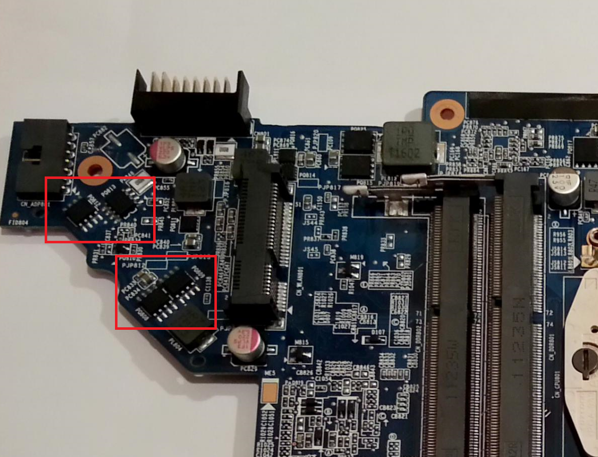

            Re: HP DV6 6170em - motherboard dead after liquid (cola) spill. Please help!
            Have you tested the FETs (or at least I think they're FETs) in this picture?
            Keyboard not detected, press F1 to continue...
                Originally posted by reaper57
                How is the repair going? Did you manage to repair it?
                Dear Reaper,
                First, thank you very much for your time and effort for trying to help me to the level that you actually took your own laptop completely apart. That kind of support is simply astonishing :-)
                From your readings I can tell that mine 9-10ohm looks OK, although that part of the motherboard is quite different than mine.
                As for the FET's on the left side, I think they're OK and they do 5V and 3.3V or something... I think I'll quit this repair, for now...
