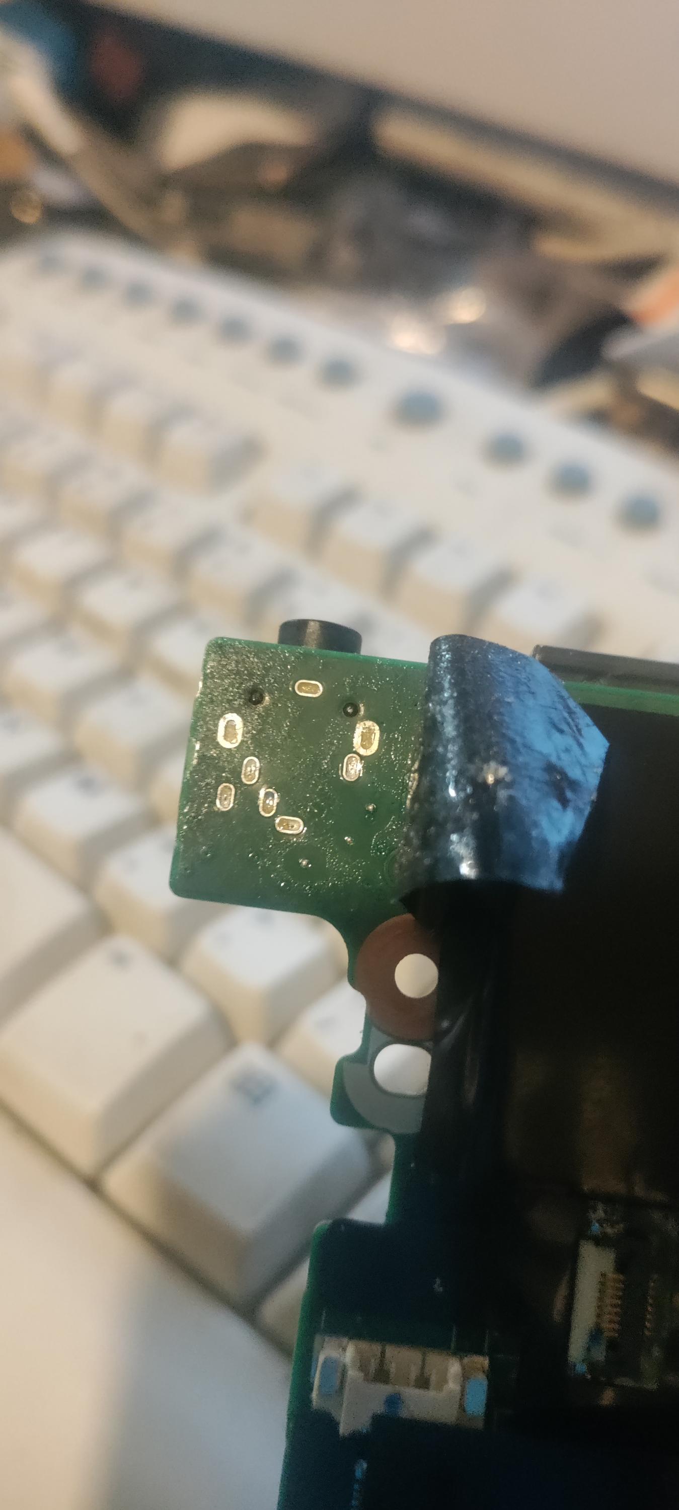

    Tore town my Lenovo T440s to see if I could find a compatible 3.5mm headphone jack... No dice. Very common failure from what I've seen online.
    Pics attached. Didn't find anything on eBay or digikey... Did find a reference to a currently-deleted AliExpress listing but obviously that's of no help.

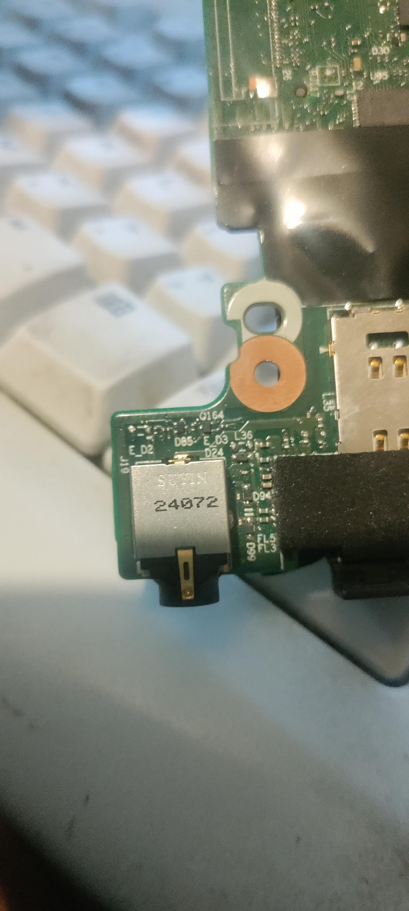

          Was able to desolder the jacks and swap the dead board's jack over... and no change. Right channel still dead.
          Must be a faulty sound chip... bleeping lenovo Oh well... sadly, the three places I though I could use this thing (my wife, my dad, and church) all need working 3.5mm audio and I'd prefer to avoid USB adapters. Heck IDK.

              Posting from it: Looks to be a software issue... as on a reboot to Windows 10 (it's a dualbooted arch x64 and 10 x64 setup) I am getting sound on both channels just fine (with a fair bit of intermixing, almost seems to mono but I am getting some left/right separation). Before the jack swap, my headphones didn't seem to plug in right and I had a dead channel on both OS's.
              I used a different audio setup on the Arch install on the T460 the succeded this (converted from pulseaudio to pipewire; needed better graphic equalizers to band-stop a gnarly harmonic issue with that particular model)... may try that. Otherwise, I dunno... Depending on what happens with this thing it may end up as Windows 10 only.

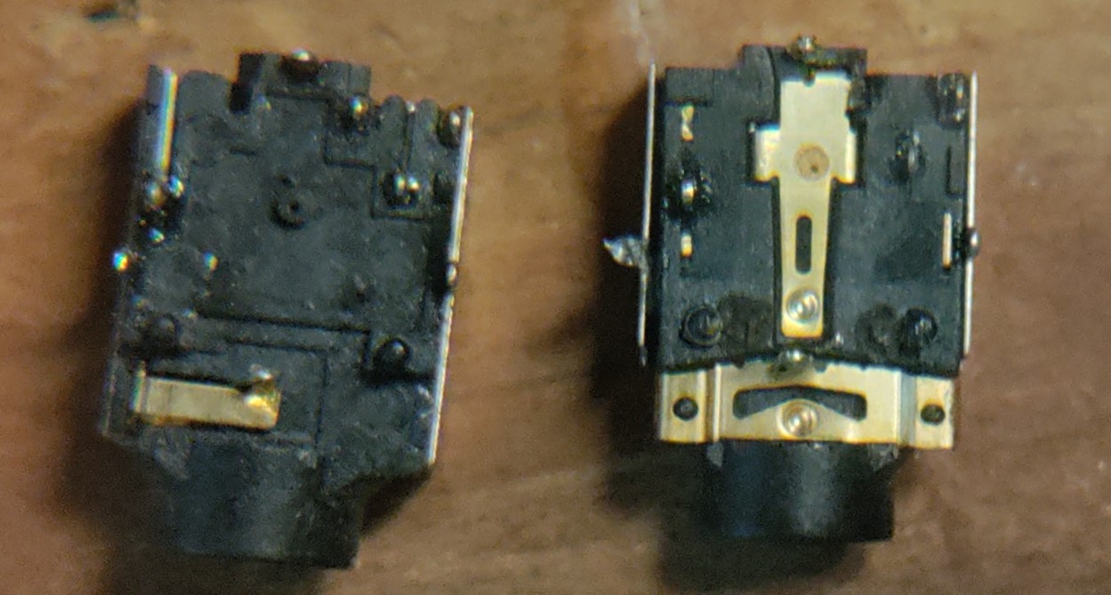

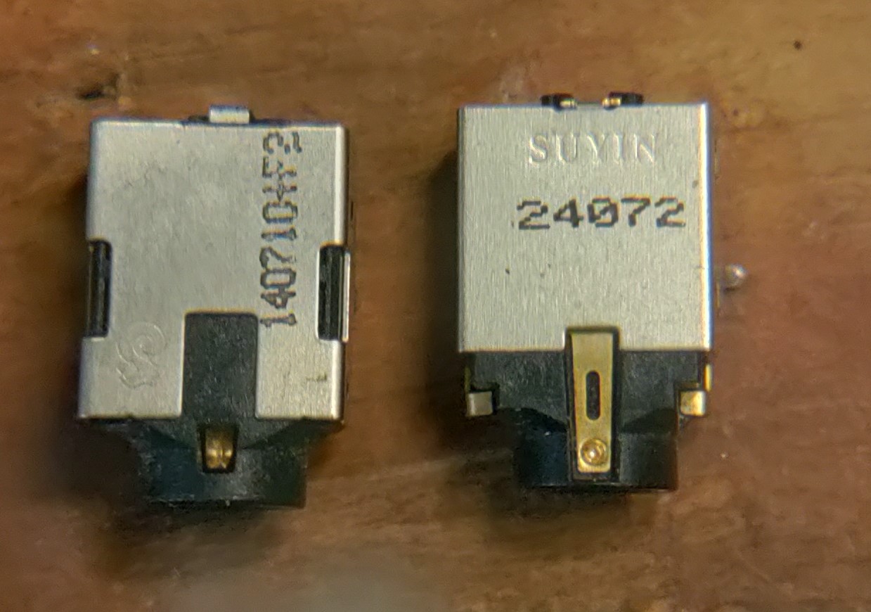

                  Pictures:
                  The "new" good jack is on the left, the "old" bad jack is on the right.
                  Notice that the bad jack has a lot more exposed copper... not sure if that's to blame. Seems the "S" jacks are good, and the "Suyin" jacks are garbage?
                  On the repair itself: I was able to wick everything but three of the four shield/ground plane joints (two on the new jack, one on the old jack. I was able to use some tweezers to carefully heat and wiggle the shield joints to extract the jack; the shield bent and fell off the old jack in the process, more evidence of it being a cheaper flimisier design (I straighened it and reinstalled for the pictures). Once removed, I was able to use a pick and some wick to clear the remaining shield hole. Soldering the new jack was uneventful. I needed everything my 60W iron could give... these flush through holes combined with modern lead free solder and heavy ground planes (on the shield joints) made things tricky. Several holes required multiple wicking attempts (where each time more of the lead free solder was mixed with and removed by the 60/40 leaded solder I was adding).
