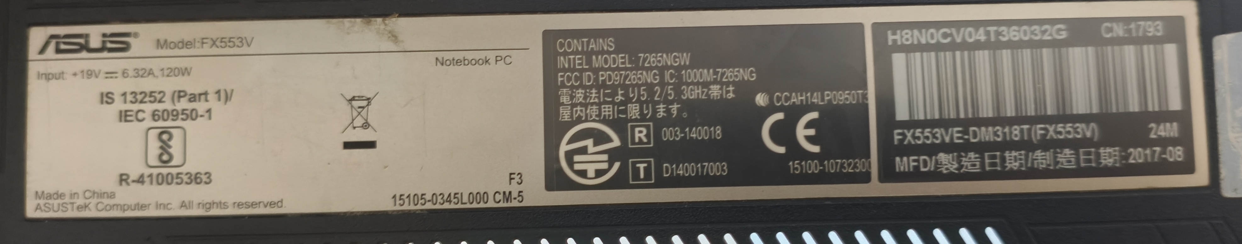

FX553VE-DM318T(FX553v) not POSTING

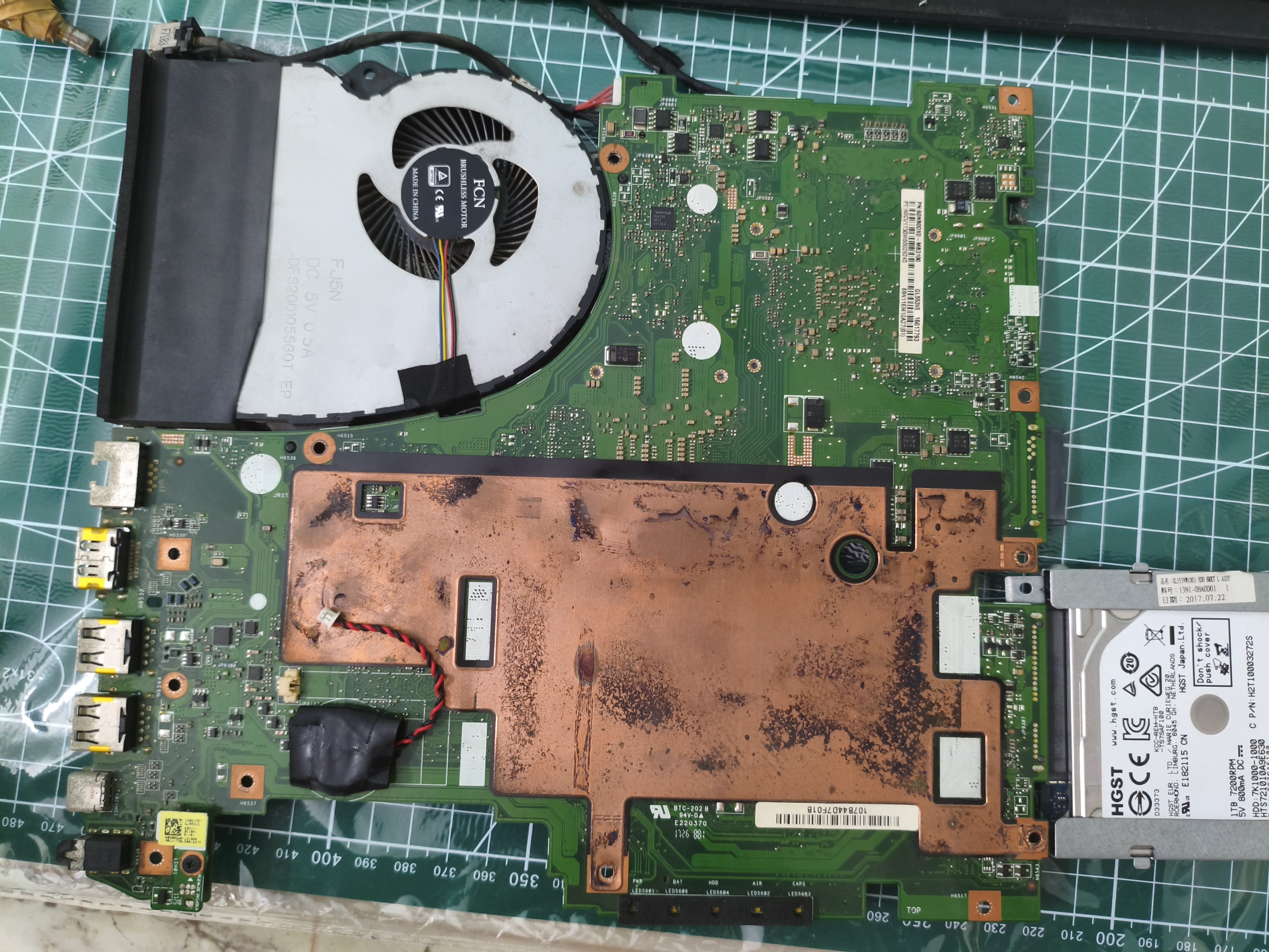

    Cpu i7-7700hq Ram - 8gb samsung, 32 gb sk hynix
    Gpu - nvidia geforce 1050ti
    Ssd orion o700
    Hdd hgst721010A9e630
    See images
    What's not working right?
    The system does not even POST, display is black,
    LEDs on - power led, aiplane mode, capslock fpr few seconds in the start(when connected to ac power) only.
    When did the problem happen?
    My laptop had dual boot setup, ubuntu and windows 10.
    It already had a moklist error, that would occur when i tried to boot ubuntu.
    When i upgraded my laptop

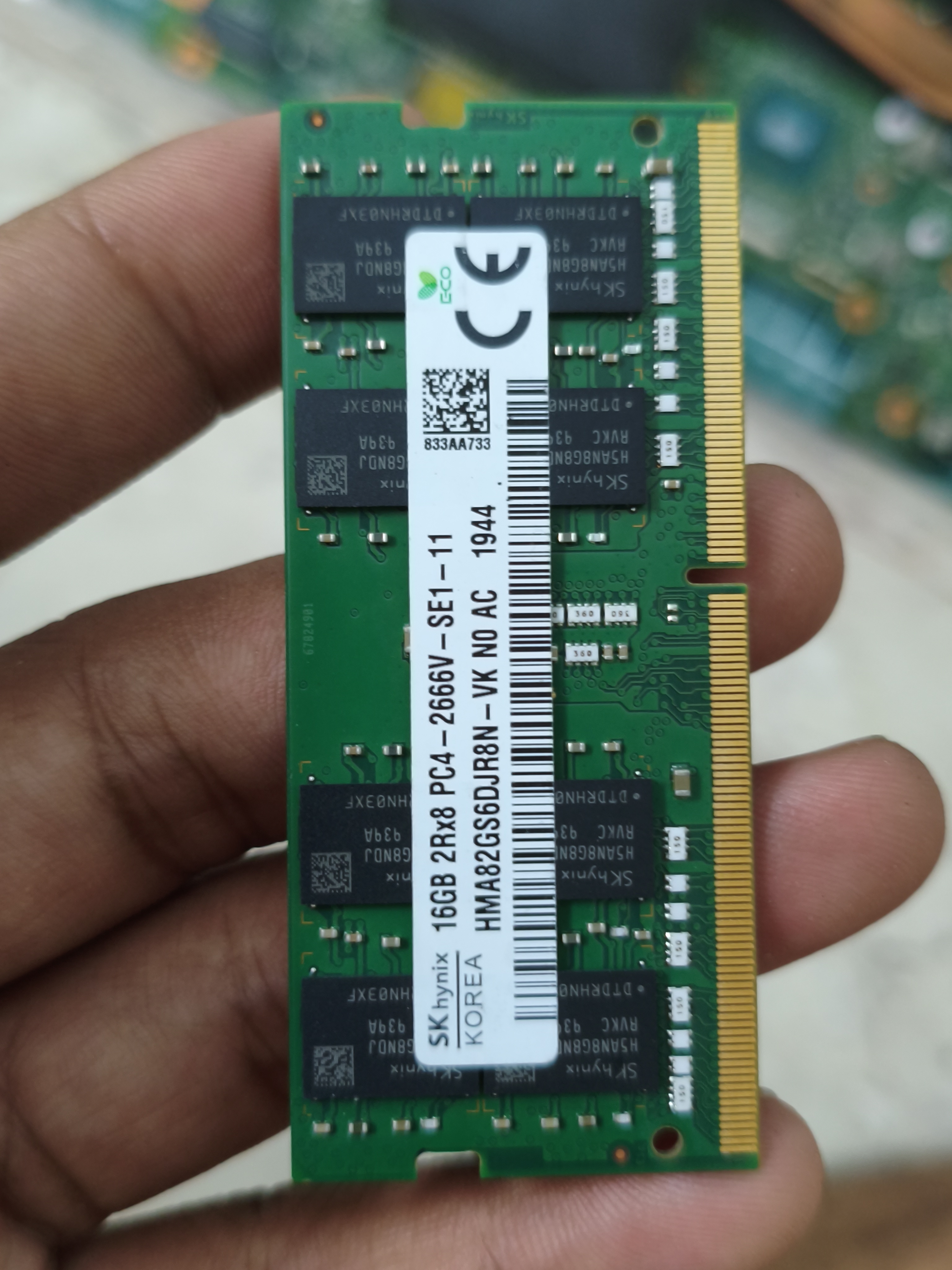

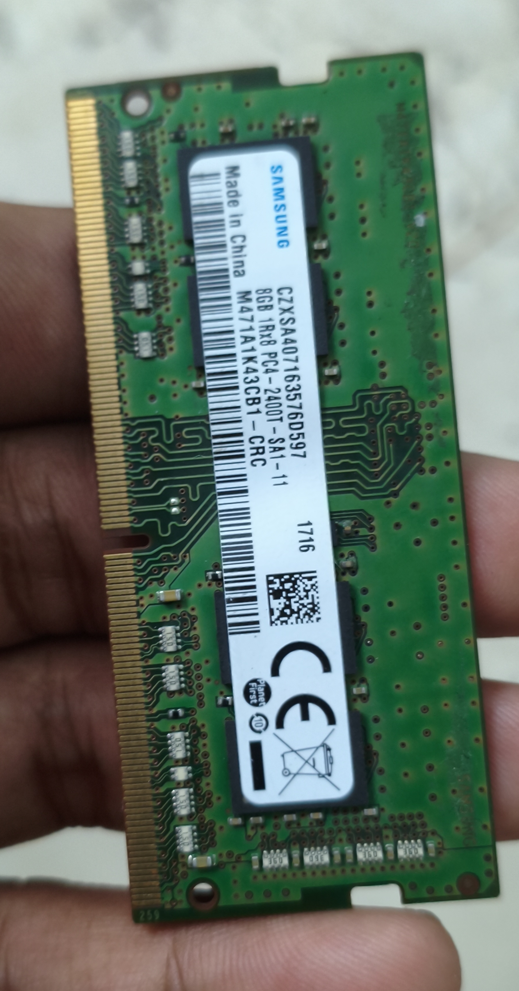

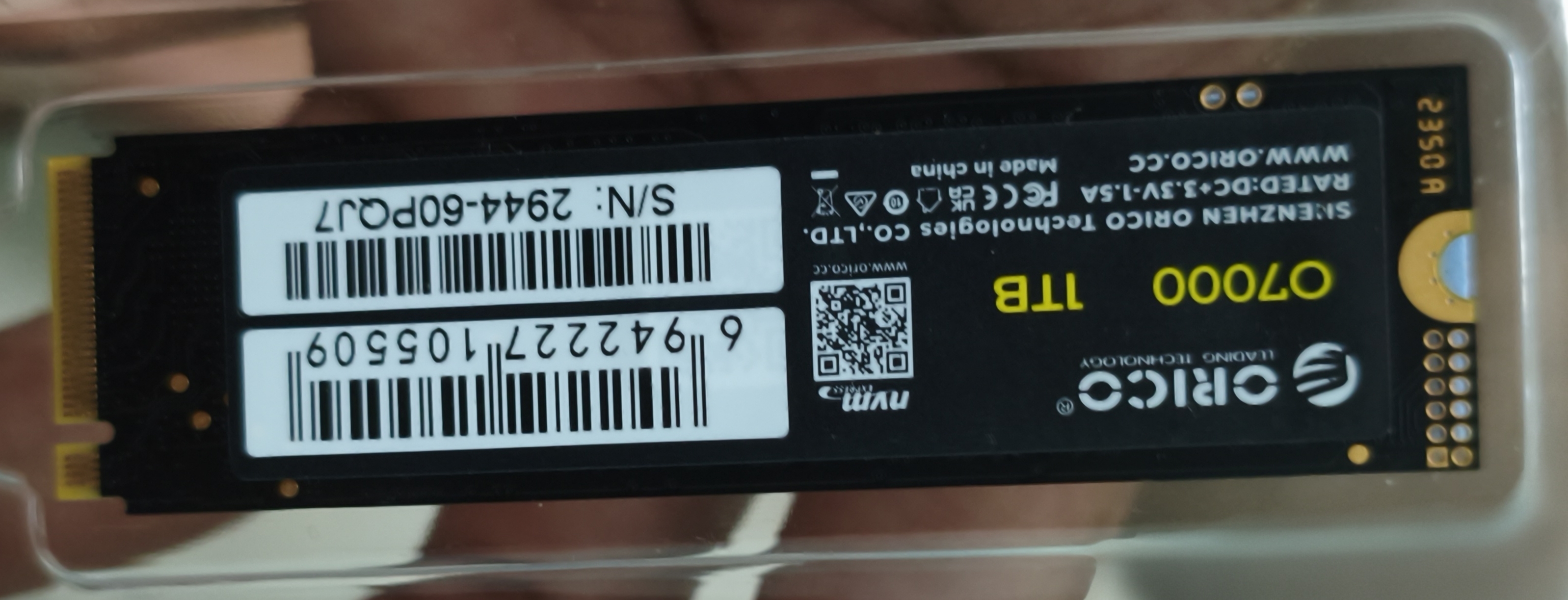

    I changed from samsumg 8gb ram ddr4 to sk hynix 32(16x2) ram ddr4.
    I attached one o700 orion ssd.
    The pc did not boot immidiately.
    But after several tries it did.
    Then i used my laptop with 32 gb ram, 1 tb hdd (windows) and 1tb ssd(unintialized) for 15 days min.
    The plan was to protect all personal data in hdd while merging partitions, removing windows and ubuntu and efi, etc partitions. Install windows on ssd.
    To implemet this i thought to
    1. intitialize my ssd transfer my data(that needed to be saved 500gb) from hdd to ssd. Done sucessfully.
    2. Removed ubuntu partition, merged and formatted. Only left partitions are windows, efi, etc. Done succesfully
    3. Created a live usb of puppy linux to boot into and merge remaining partitions and transfer back my data to hdd(merged) and get ready for fresh windwos install to ssd - failed
    a. usb plugged in - done.
    b. Boot menu change - failed. Could not open boot menu.
    c. Boot to Bios - failed. - could not open bios, laptop freezes like the current situation(answer 1)
    d. Reset cmos and removed battery- still failed. Still could not open bios , same reason as c
    e. removed usb, the bios can still not be opened from key press but system boots to windows, normally. Thought it was a grub issue. Removed grub - still cannot boot to bios.
    f. Removed hdd, one 16 gb ram, the bios opens up.
    g. Set bios to boot live usb with ssd only. Success.
    h. Connected hdd to motherboard, still cannot boot, system freezes, black screen no lpgo or stuck at logo.
    i. The bios settings revert back to last saved.
    j. Tried to boot with old ram stick with hdd, only ram and no drives, no ram and no drives.
    Evertime after j, results the same - 3 leds, (power(keyboard), charging and airplane) capslock led flashes in the begining.

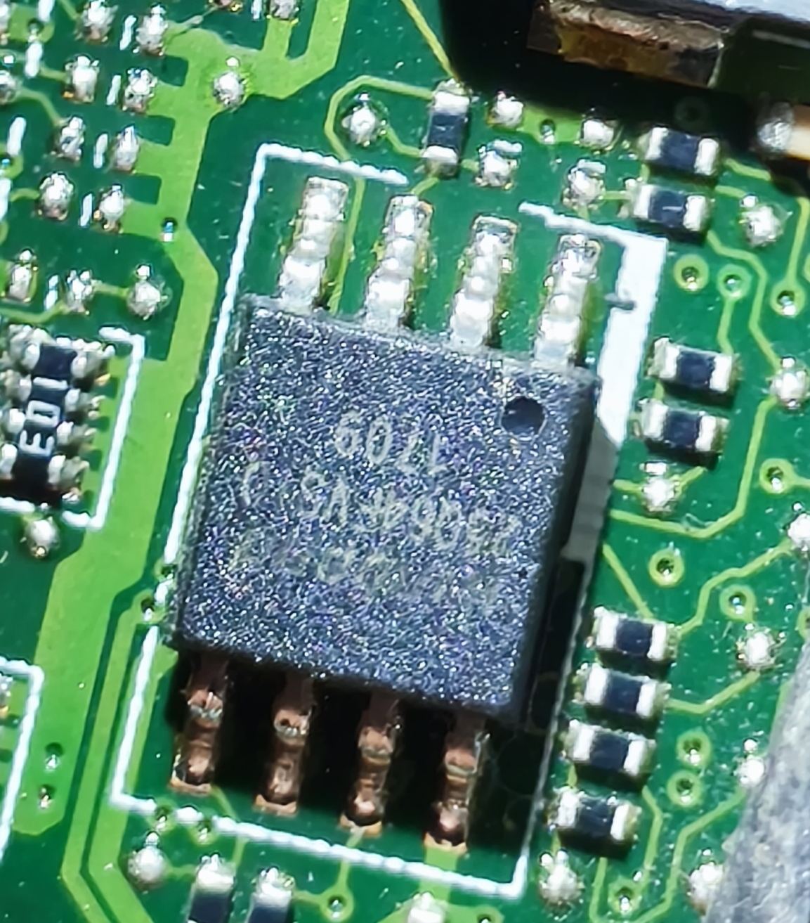

    I'm not completely sure, but it could be a bad/corrupt BIOS by looking at b, c, h, i, check the voltage on the RTC battery first (2nd picture, with 2 wires)
    In that case, you'll need an external programmer, make a backup of your current BIOS, then make a new thread (or find an existing one for your model) in the BIOS request subforum attaching the required information and your BIOS backup (read the rules there first)

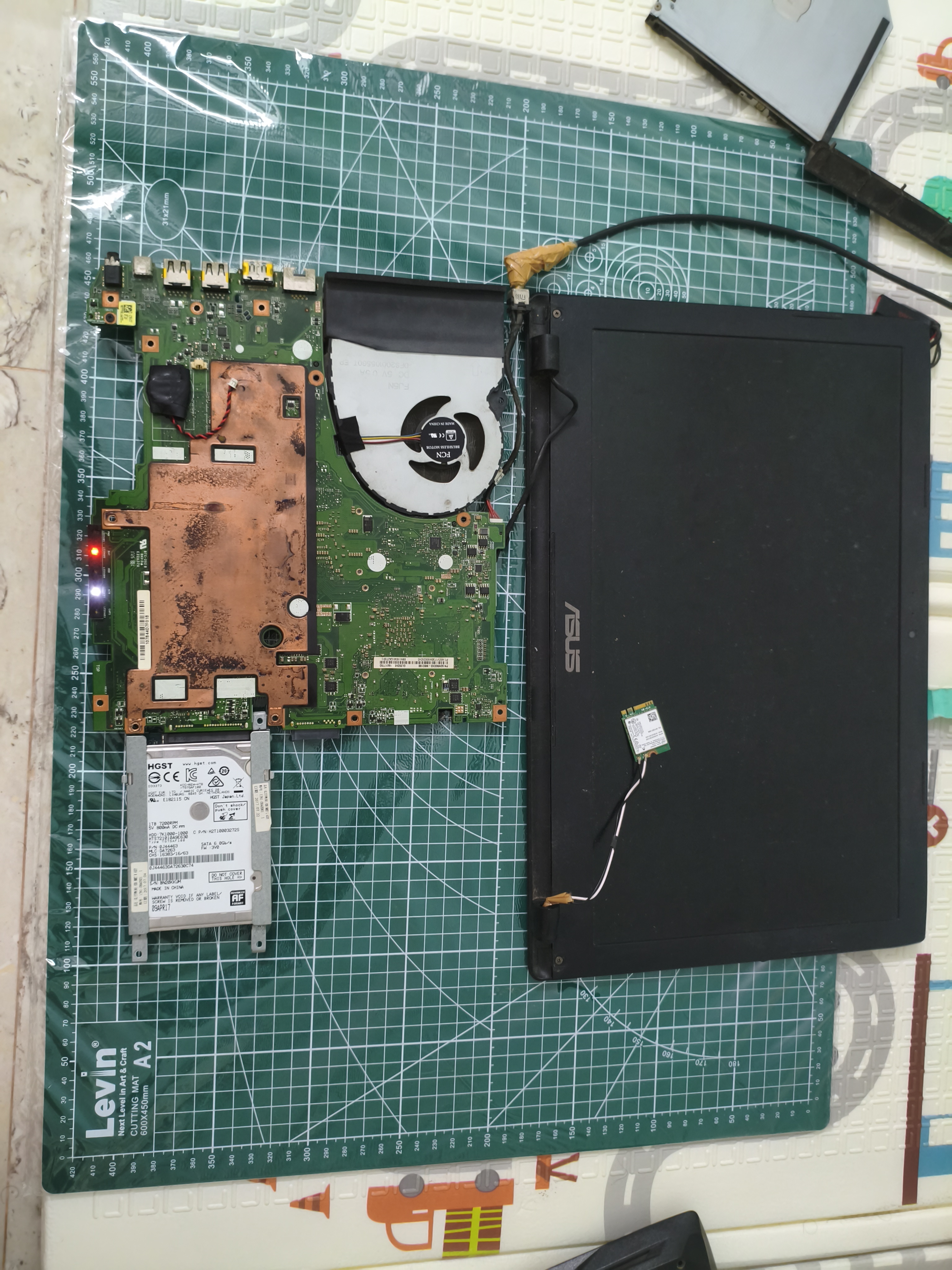

      Today i tried to put everything (disassembled) back together.
      it magically booted to windwos.
      It still has issues booting to bios.
      its probably corrupt.

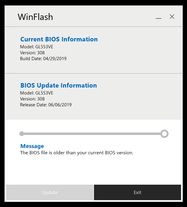

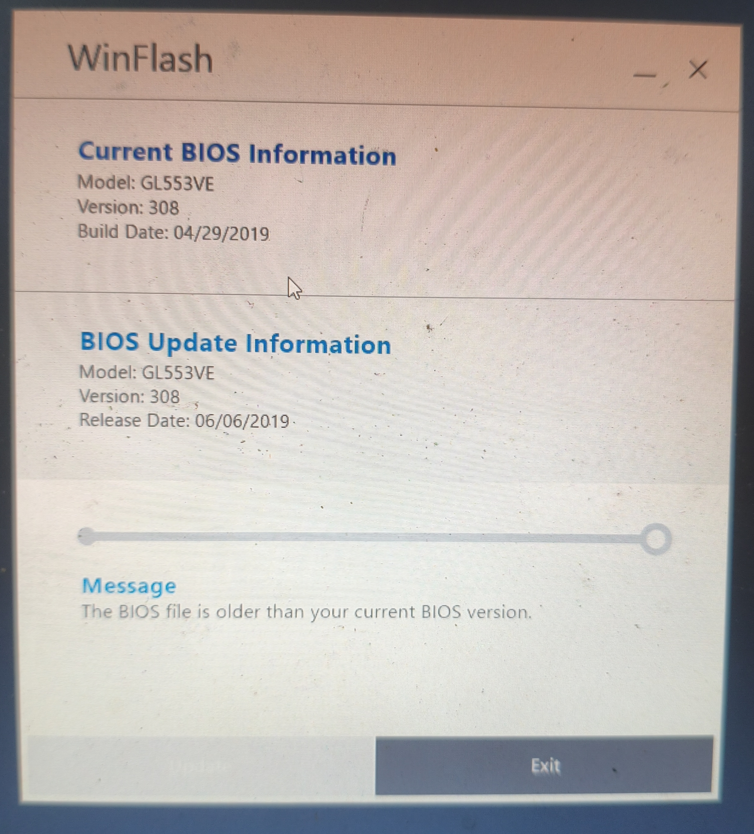

        Here is what the winflash utility shows.
        • m1ch43lzm
          • Mar 2019
          • 1116
          • Peru
          Only if there was a way to enter EZ Flash without entering BIOS setup, as you have to go to Advanced menu to enter EZ Flash (you mentioned issues entering BIOS)
          https://www.asus.com/support/faq/1008859/
          You have to copy the BIOS update onto a USB drive formatted FAT32
          https://www.asus.com/supportonly/fx553ve/helpdesk_bios/
          It's best to update BIOS from the built-in updater in BIOS itself, at least there's an option for it on ASUS laptops, similar to their desktop boards
          For the winflash utility check here
          https://rog-forum.asus.com/t5/rog-ga...sh/td-p/166819
          You have to run winflash.exe /nodate
          If for some reason it fails, you need an external programmer to flash the BIOS, check here
          https://www.badcaps.net/forum/troubl...rces-and-tools

                  • claws77
                    • Apr 2024
                    • 103
                    • India
                    Click image for larger version  Name:	image.png Views:	0 Size:	11.8 KB ID:	3641397
                    I tried the WinFlash method, it failed. the BIOS still does not open. but while updating with Winflash, it looked it everything went smoothly. ez flash utility automatically opened.
                    but alas, no success.
                    NOTHING CHANGED
                    guess external prgrammer is the only way!.
                    now i have to worry about backing up my bios too
                    how do i backup my bios? with external programmer only?

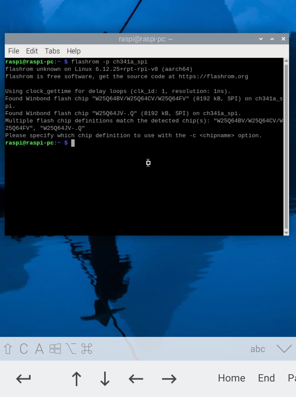

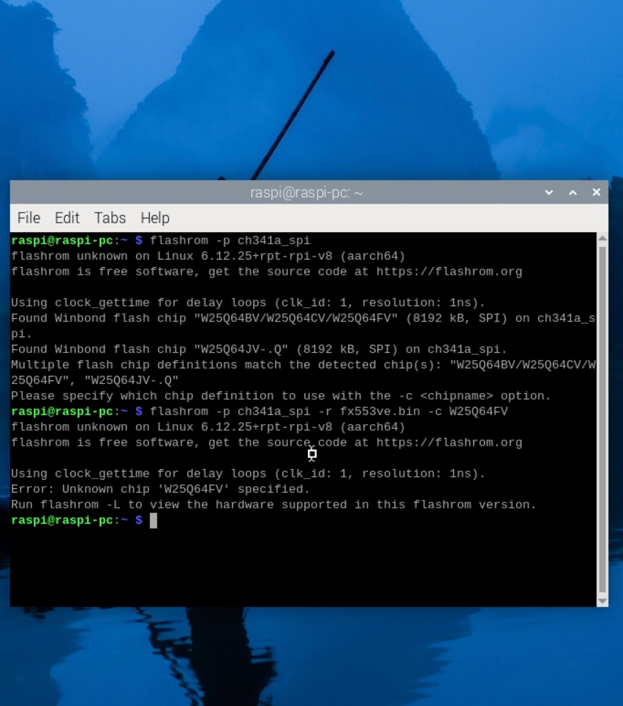

                          Finally bought the rom flashers
                          black and blue ones both(ch341a), test clip.
                          ​​​​​they arrived today.
                          Got everything setup correctly
                          I am using raspberry pi with vnc to flash bios, using flashrom utility.
                          I am getting these errors.
                          i know my chip is w25q64fv. It says so on the ic.
                          what when i use -c W25Q64FV, it does not work.
                          Any guidance....
                          • m1ch43lzm
                            • Mar 2019
                            • 1116
                            • Peru
                            Try -c "W25Q64BV/W25Q64CV/W25Q64FV"
                            Or -c "W25Q64.V"
                            I advise to read the chip 3 times, and compare the dumps if they're identical to each other with a hex editor
                            Otherwise borrow a Windows PC and use AsProgrammer software
                            https://github.com/nofeletru/UsbAsp-flash/releases
                            For Linux I found another software called IMSProg, I haven't tried it
                            https://github.com/bigbigmdm/IMSProg
                            https://www.onetransistor.eu/2023/10...mer-linux.html
                            Maybe there's a build available for the raspberry pi

                              Got new errors.
                              raspi@raspi-pc:~ $ flashrom -p ch341a_spi -r filename.bin -c "W25Q64BV/W25Q64CV/W25Q64FV" flashrom unknown on Linux 6.12.25+rpt-rpi-v8 (aarch64)
                              flashrom is free software, get the source code at https://flashrom.org
                              Using clock_gettime for delay loops (clk_id: 1, resolution: 1ns).
                              Found Winbond flash chip "W25Q64BV/W25Q64CV/W25Q64FV" (8192 kB, SPI) on ch341a_spi.
                              Reading flash...
                              cb_in: error: LIBUSB_TRANSFER_TIMED_OUT
                              ch341a_spi_spi_send_command: Failed to read 4100 bytes
                              Read operation failed!
                              FAILED.
                              raspi@raspi-pc:~ $ flashrom -p ch341a_spi -r filename.bin -c "W25Q64.V"
                              Error: Unknown chip 'W25Q64.V' specified.
                              Run flashrom -L to view the hardware supported in this flashrom version.
                              raspi@raspi-pc:~ $ flashrom -p ch341a_spi -r filename.bin -c "W25Q64FV"
                              Error: Unknown chip 'W25Q64FV' specified.
                              • m1ch43lzm
                                • Mar 2019
                                • 1116
                                • Peru
                                This one appears to be the correct command
                                Try on another PC

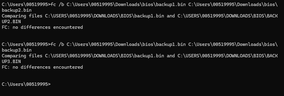

                                  • claws77
                                    • Apr 2024
                                    • 103
                                    • India
                                    yay!
                                    finally read the bios dump 3 times.
                                    i am using asprogrammer
                                    compared the dump files with "fc /b" in cmd
                                    please find attached. everything ok?
                                    i'll post it in bios forum too
                                    • m1ch43lzm
                                      • Mar 2019
                                      • 1116
                                      • Peru
                                      Try again, the files are empty, full of FF FF...
                                      Nothing that looks like the BIOS from Asus website
                                      Sometimes the clip makes a bad connection

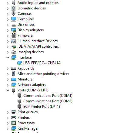

                                        i installed both of these drivers. Click image for larger version
                                        my device manager shows like this
                                        the asprogrammmer does not detect the programmer automatically, i select everything.
