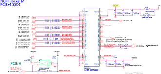

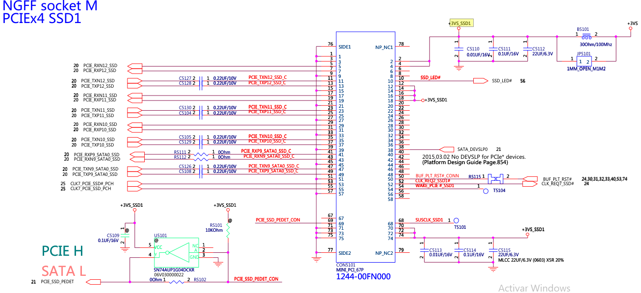

            #45
            Originally posted by claws77
            m1ch43lzm
            I think i have figured it out.
            its my ssd.
            If i remove my ssd, my bios boots up fine.
            But my ssd is new.
            Orion o700, 1 tb
            https://amzn.in/d/47cMxk1
            How to verify if my ssd is faulty, or port or a compatibility issue?
            Only way to test if SSD is faulty, is to test it on another PC if it causes the same issue
            As PCIe Gen 4 SSD should be backwards compatible with PCIe Gen 3 host, like your laptop, it will be limited to Gen 3 speeds (max 3200MB/s) so there's no point spending more on a Gen 4 SSD, unless you plan to reuse it later on a newer PC
            Amazon reviews from the link you posted say that it runs hot, assuming it draws more power than a Gen 3 SSD
            I'm assuming the BIOS detects properly the SATA HDD, and you can access its contents from a live USB
            Measure resistance across B5301, it should be 0 ohm, it connects 3.3V to the M.2 connector, your board either has that part installed, or it has a solder blob across JP5101
            If B5301 is faulty, you can close JP5101 with a solder blob
            If instead of B5301 you have a solder blob at JP5101, ignore what i said
