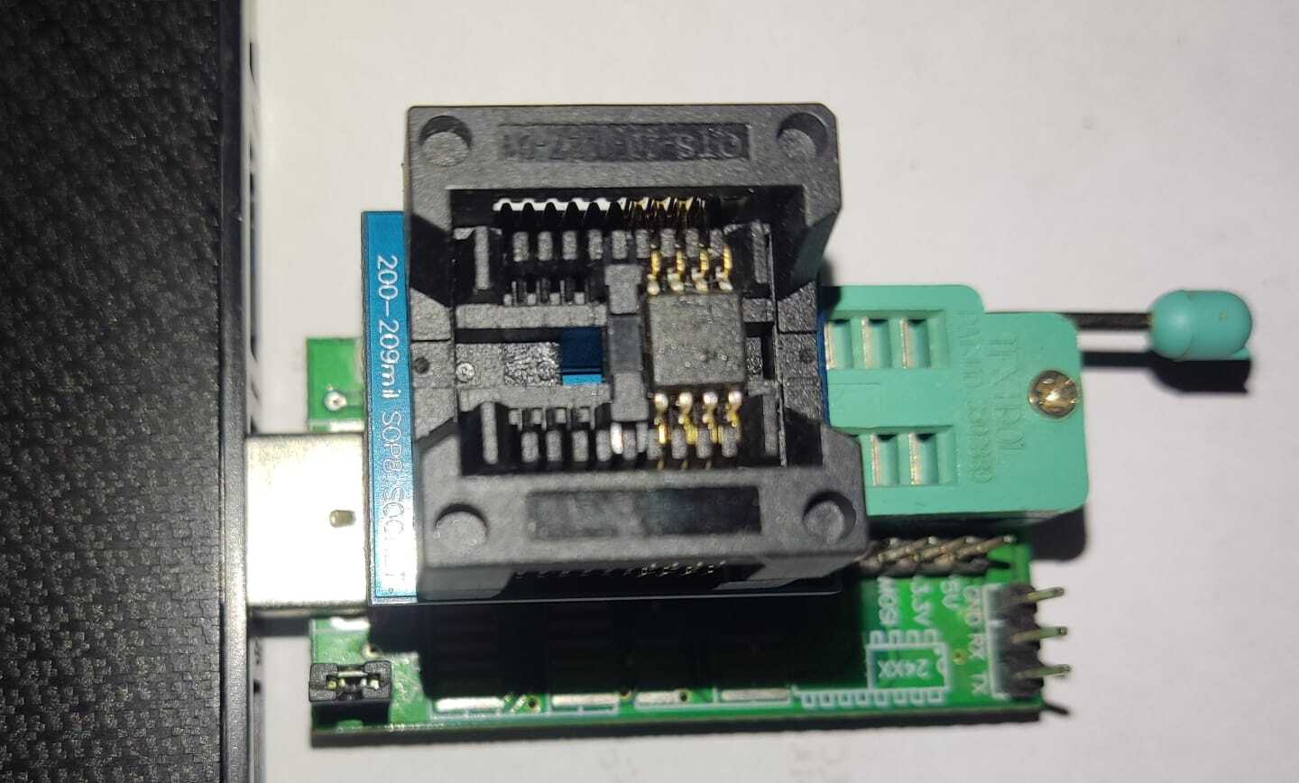

    Press the read ID button, it's the one with question mark, it should detect the chip
    If the chip is not detected properly, check the connection on the clip, make sure it's aligned properly
    After it gets properly detected click the read button
    You should get something else on the hex view, not just full of FF FF...,

      here is the bios dumps, you are right, it was a connection issue.
      sure good night! thanks

            Let's call it like it is: To read or write the BIOS with the alligator clip is BAD PRACTICE when you are not aware of the disadvantages.
            Best practice is to read and write the IC soldered on a discrete programming board which you can install on the CH341A.
            However, there are options to minimise the risk of data corruption while reading or writing the flash IC when you are not willing to go the safe route or when you have a Plan B in the backhand (for the experienced technicians).
            With Software like FlexHex you can compare two dumps.
            a) reading a dump and check for data integrity - Here you want to take two or three dumps from the flash IC and compare these. If they are different, you have read corrupted files and you need to check the connection (and health of the power rail connected to Pin 8 of the flash IC). To be in almost full fail-save conditions you need to completely disconnect and re-connect to the flash IC after each read attempt. You have to read dumps from the flash IC until you get at least 2 (better 3) dumps which are identical.
            b) writing a dump and check for data integrity - after writing the dump, you read out the dump again and compare it with the source file you have written. If the dumps are NOT identical, you have probably written or read a corrupted dump. You have to repeat this until FlexHex (or similar software) tells you that the source file is identical with the file you have read out again.
            with these simple but important steps you can work with the CH341A in combination with the alligator clip. I don't say that this is 100% safe, but the risk should be minized down to less than 1%.

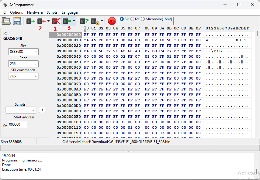

                            I found my old CH341A and a compatible flash chip (same size, different model/brand) from a dead board to test
                            On AsProgrammer, after you press Read ID, follow the steps in this order:
                            1. Erase the chip (button with X)
                            2. Write the new BIOS posted by SMDFlea (link is working now)
                            3. Press the Verify button (the one with the = symbol)

                              Thank you!! Sephir0th m1ch43lzm It worked With conditions.
                              So as mentioned i needed to shift data between drives and install fresh windows on ssd.
                              After flashing the bios, the bios worked ok, i was able to boot into my live usb by selecting from boot menu.

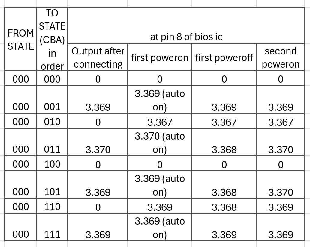

                                      Now I'm beginning to think it's a hardware issue, with the 3.3v supply to the BIOS chip, the 5v supply, or a faulty flash chip, and the BIOS corruption/not going into BIOS setup is a side effect of that
                                      As you said on the bios request thread it boots now into Windows but can't enter setup/change boot order anymore
                                      You'll need a multimeter with sharp probes
                                      Measure resistance across both R2802 and R2804, should be 0 ohms (same as touching the probes together), the schematics and board view linked above in post #27 will help to locate those parts
                                      Also measure the voltage on pin 8 on the BIOS chip, should be 3.3v

                                        #39
                                        Coin cell battery [C] =2.9 V
                                        battery [B] = 50%
                                        AC [A] = 19V
                                        The output at pin 8 of bios chip after plugging each powersource and their combinations in order - first coin cell, then battery then ac.
                                        See image.
                                        resistance across r2802 and r2804 is 0.8, 0.6 ohms.
                                        leads resistance 0.6 ohms.
                                        Sorry it took quite a time to respond, job stuff.

                                          Voltage in pin 8 of the BIOS is OK, I can't think of anything else except a failing BIOS chip (W25Q64FV)
