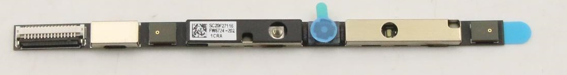

    According to the full model 20TD00GNUK i get only these options, you can enter the serial number at that web site to get the exact parts used
    Mars1.0INTELFRUCABLEMars1.0IntelEDPCABLEIR
    Part No: 5C10Z23917
    Camera,HD-IR,Front,2MIC,ZIF,Azw
    Part No: 5C20W42992
    Substitutes: 5C20W42993 and 5C20W42994
    Click image for larger version Name:	5C20W42993_A.jpg Views:	0 Size:	36.2 KB ID:	3635821
    And it says exactly what you posted SC20F27116 (for 5C20W42993), so it's an IR webcam, on the regular 720p cameras if i select only 20TD the number on the sticker is completely different
    You can click on the images on the lenovo parts site and check
    The serial number is: PF3JCYGJ (i had written above... ) again it shows 2 camera suitable for that laptop as a replacement .
    Oh my god imagine receiving another cable that it's not compatible with that hahah in 2 weeks haha...

      You meant
      Camera,HD-IR,Front,2MIC,ZIF,Bsn Part No: 5C20W42993
      Part No: 5C20W42992
      They're equivalent, both IR, listed as substitutes for each other, the LCD cable is the same 5C10Z23917
      Likely they grab whatever supplier they got cheaper for a given batch

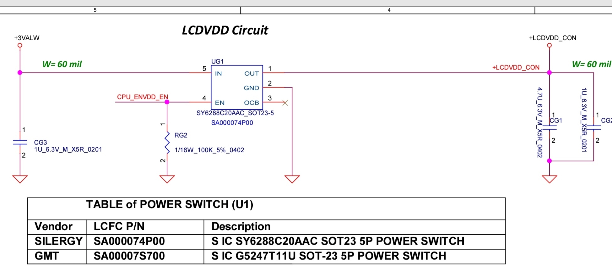

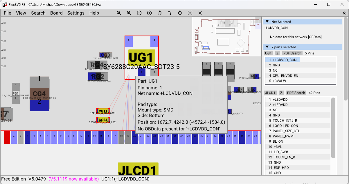

                https://www.badcaps.net/forum/troubl...ic#post1718498
                Schematics post #9, board view post #11, the boardview posted by "Lisa Su" you unrar, then rename the extension from GE4B0.fz to .tvw, open with flexbv free
                like a spark it shows a change from black to ultra black
                I think i understand what you mean, on IPS panels when off they look black even when shining a flashlight, when the panel gets energized gets a bit blacker before backlight comes on
                On TN panels when off it's a dark green color, more noticeable with a flashlight, then turn black when powered on
                LCDVDD is pins 18-19 of the LCD connector, you can measure it at CG11, CG24, or at pin 1 of UG1, should be 3.3v
                PANEL_PWM, pin 8 and BL_ON, pin 9 of the LCD connector, those go to the back of the board, the boardview will help identify some resistors where you can probe those signals

                  UG1..
                  • Acnologia
                    • Dec 2016
                    • 429
                    • Poland
                    #29
                    Plus i see that the capacitors are not there...CG24 and CG11...
                    Maybe when he tried to fix it he ripped them out ?!

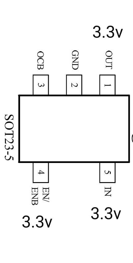

                      #30
                      Measure with laptop powered on, lid open, keyboard facing down on the table to make it easier for you
                      You should also get the enable signal (3.3v) at pin 4 to enable UG1, and the output should be 3.3v
                      Click image for larger version  Name:	ug1.jpg Views:	0 Size:	12.9 KB ID:	3653519

                        #31
                        Nice hint i was trying to turn myself around etc.
                        Yes, they are as you show me.
                        3.35 to 4.5 and 1.
                        2 and 3 are 0.00
