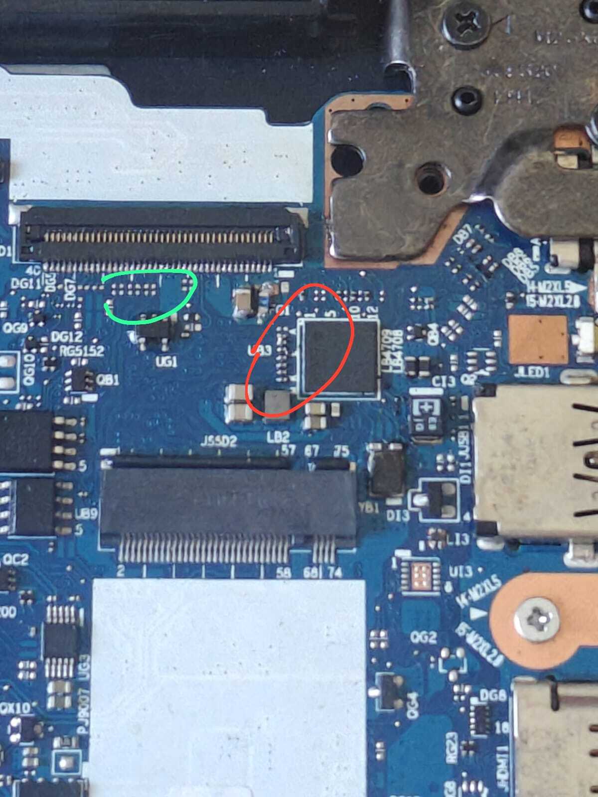

    Looking back at your pictures, could you post an updated picture of this area?
    Are those caps highlighted in green missing? Those are needed for EDP signaling, CG13, CG14, CG15, CG16, CG17, CG18, you won't get a picture without those...
    The caps in red are also badly soldered, but unrelated for now
    Resistance looks fine on BL_ON (50.5k), now fix those missing caps for EDP signals, your customer sure made a mess on the board

      Yes, but what can you do ? Customer is always right. To my understanding he will not bother , to even pay for that service. So most probably will reject the repair and i will keep the laptop or something for labour. So for now , i would say i am repairing it for personal knowledge and gaining experience.
      The 'green'eveything is missing , the red is a little bit better...
      So most probably i need to order parts for the CG13,CG14 , from aliexpress....

            Don't want to blame anyone yet, but that kind of damage could be done either by the customer himself, or "his friend" that will do it for cheap but ends up making it worse
            Always a good idea to take pictures before a repair, to cover yourself in case something goes wrong with the customer
            maybe he thought that there was a short and ended up removing caps at random, then replaced the LCD cable (or the whole display assembly, from the AMD version), then gave up after making it worse
            Or the opposite, the original screen could have cracked (or just didn't show a picture), then he/"his friend" replaced the whole display assembly with one from the AMD E15 gen2, and not realizing his mistake made it worse
            I'm making hypotheses here on what happened here

                        Well hello there!!!! 👋
                        As soon as I attached from CG13 all the way to CG18.
                        WE HAVE PICTURE!!!!!
                        I will do some tests to make sure.
                        But come on!! 😀
                        Yessssss!!!

                          Congrats!
                          It was a combination of the wrong LCD cable + the missing caps on the EDP data lines

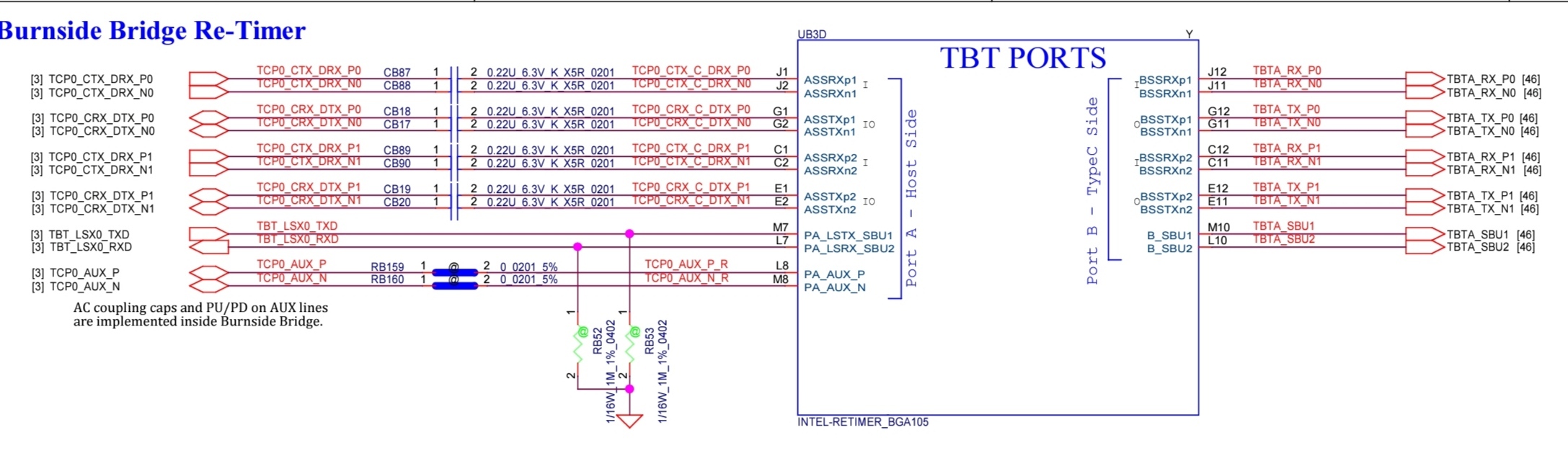

                          Now fix the remaining caps marked in red in post 41, unfortunately due to forum issues/upgrade the pictures you uploaded were lost
                          Those are data lines that go to the thunderbolt retimer, the USB-C port attached to it won't work for data if those caps are missing, only for charging

                            Already done, it charges all ,well diagnostic full . 100% without any issues.
                            We are good to go
                            You were amazing, and i gained knowledge .Thank you very much for your time ,effort and knowledge.
