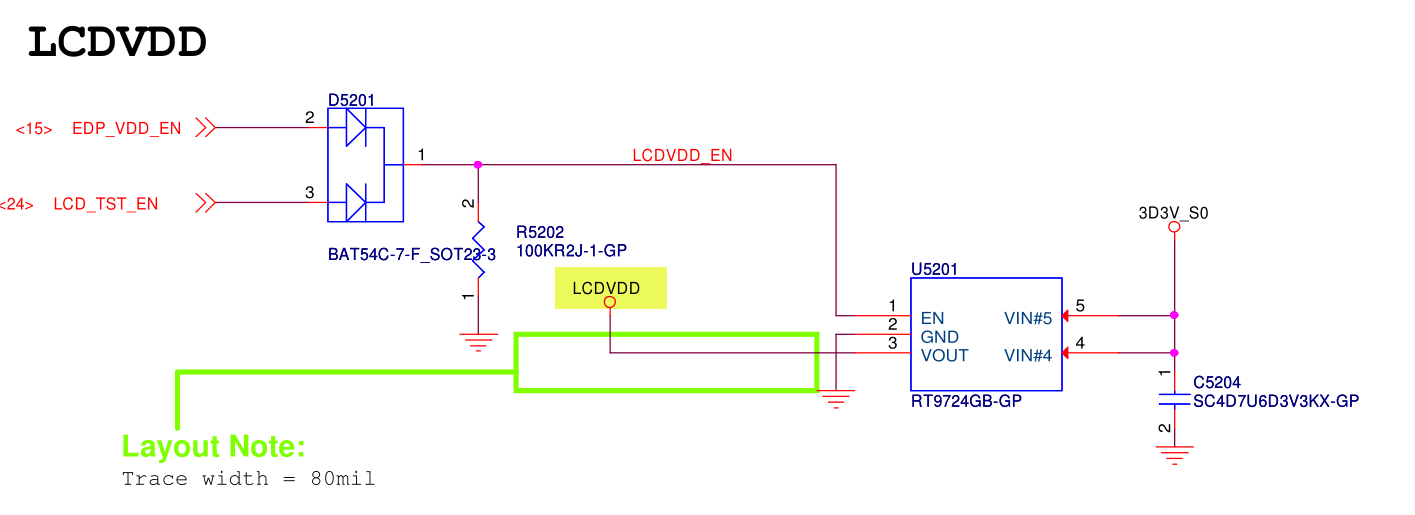

    Hi guys,
    this one seems to work except that there is no image on LCD, only on external via HDMI. I have flashed the bios with a cleanME one and measured voltages at GPU (0.9V) and LVDS connector (LCDVDD_LCD is 19V and DCBATOUT_LCD is 3.3V). I can see the LCD going black after power on but no image. I shed some light with a torch but there is no image or activity at EDP_TX0/1 using the oscilloscope. I also tried a different panel.
    any ideas are welcome.
    br,
    george

    Re: dell la-b843p image only on external
    Review the caps that are in series with the EDP lines from the Haswell CPU pins.
    I am not sure if 19v for LCDVDD is correct. Can you review the voltages on U5201?
      lcdvdd cant be 19V as it should be 3.3V. I think you mean DCBATOUT_LCD is 19V. If so that's correct.
        apologies the voltages are the other way around as you mentioned. the caps seem ok i.e. the are not shorted themselves or towards GND.
