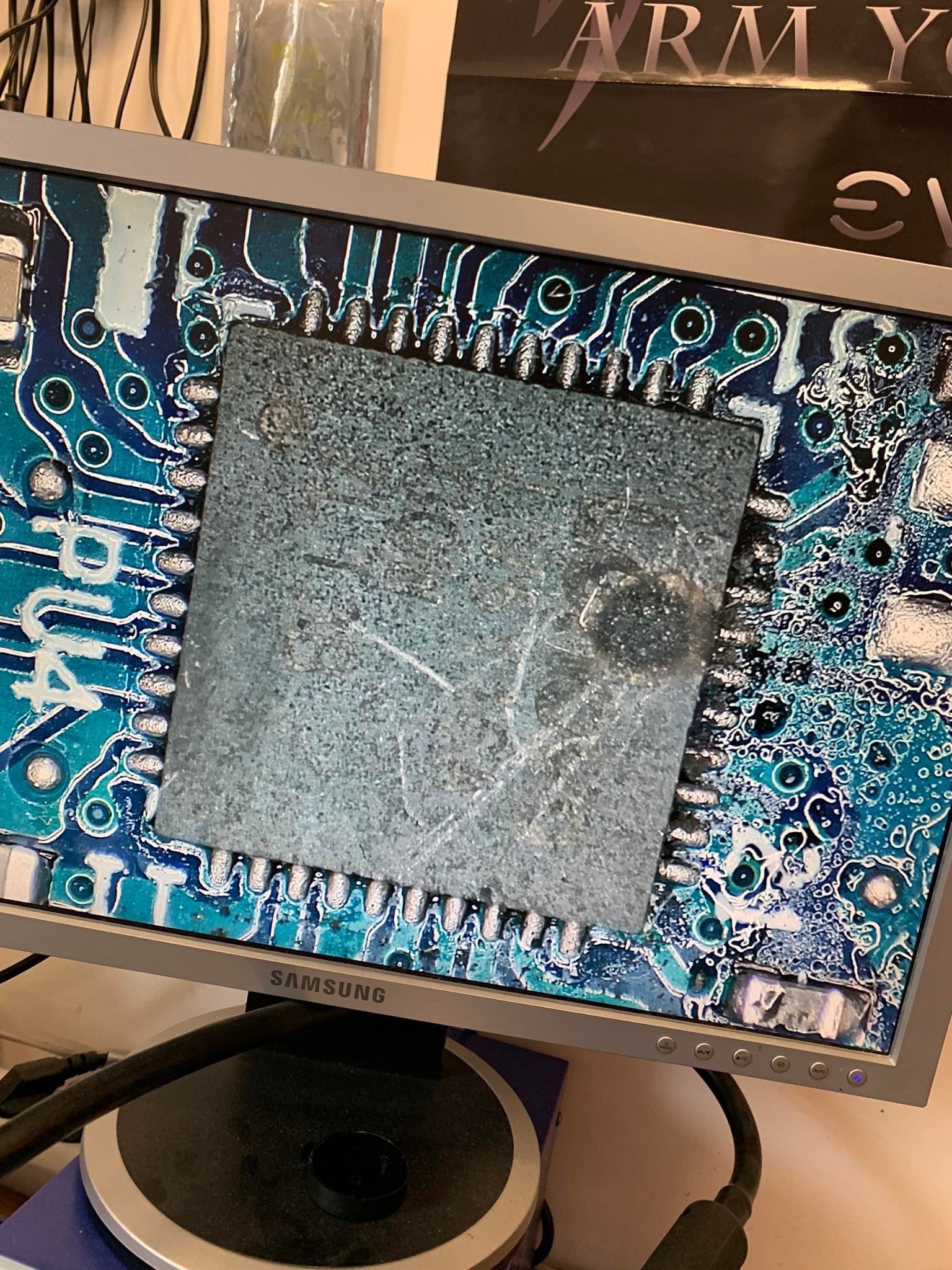

    Hi guys, today i've got this beauty. Bud i'm gonna need schematic, because i can't identify this at all.

    Post the motherboard part/model number

      GE4B0/GE5B0 NM-D011 rev 1.0

        nvm, just figured that type somewhat under microscope. It's LV5116AGQW
        Mod can lock this thread, solved. Thanks anyway.

          Thanks,the info that PU4 is a LV5116AGQW . The thread will stay open,someone will post the schematic if and when it becomes available

            lv5116a
