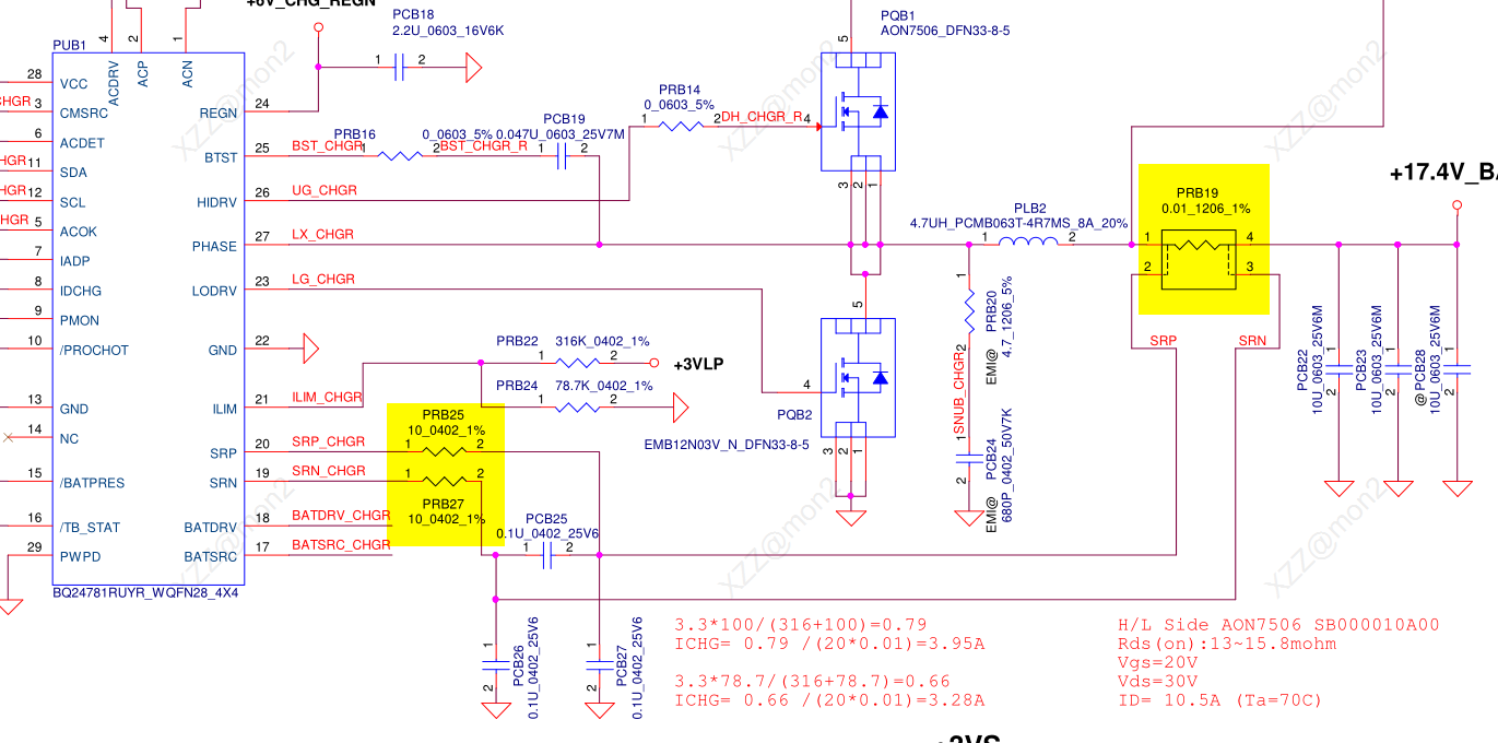

    hi,
    I don't figure out why this laptop doesn't charge battery. At first I thought it was the original battery that showed charged at 100% didnt' work at all. So I bought a new battery that is recognized from operating system and shows its charging. orange charge LED is on but keep it under charge dosen't charge! So I downloaded board schematic (Compal LA-L191P rev. 1C) and find out that D-S of PQ 201 give 1.7 ohm no matter if battery is connected or not but gate result insulated from drain and source. So i moved away mosfet and on board short disappear but testing mosfet looks working. Anyway I had here an other Compal board with same component and I replaced it with any success. Power adapter is orginal and using a lab power supply from laptop in shut down orange charge LED is on but current rise just to 0,03 A.
    Between + and GND there is just 1,5V and on pin 7-8 and GND just 3,2V. I'm sure that the new battery works properly because I tested it on an other same laptop. I attach the picture of schematic Really thanks in advance for some support.

    Attach the power adapter. Meter in DC volts mode (30v or higher is ok).
    Measure the voltage to ground on each pin on DCin mosfet PQB11.
    Interested in the voltage on
    1-2-3 (source);
    4 (gate)
    5-6-7-8 (drain)
    PUB1 (charger IC):
    pin 28 (Vcc)
    pin 24 (REGN)
    pin 6 (ACDET

      Thanks mon2 for reply.
      Laptop isnt' mine and the owner didn't sat me anything but on the internal side of back cover I noticed some trace of possibile liquid and there some little trace of liquid (maybe coffee or coke) on the right side of ram socket . (ref. Nitro5.jpg)
      I still didnt' dismount mainboard thing that I finished to make right now.
      There were also a great trace of oxide and PUB1 was really in bad condiction. (ref. PUB1.jpg)
      I cleaned carefully all and lucky pcb stil looks in good shpe and also PUB1 looks like (ref.PUB1_OK.jpg) ok and doesn't over heat if I power board.
      Cleaned it solved the weird short between drain and source of PQ 201.
      As asked here's valuse you asked me for:
      PQB11 (near DC power socket):
      1-2-3 (source): 19,7 V
      4 (gate): 25,5 V
      5-6-7-8 (drain): 19.7 V
      PUB1 (charger IC):
      pin 28 (Vcc): 19,37 V
      pin 24 (REGN): 6,0 V
      pin 6 (ACDET): 2,6 V
      Battery isn't still charching but as before is recognizd from Windows and looks like its charching, also orange LED is still on.
      Waiting for your opinion about voltage values.

              Carefully, measure the voltage to ground on each pin on this charger IC.
              Also suggest to remove all power -> no battery -> meter in resistance mode -> measure the resistance between the battery charge current leg on the charger IC. Measure directly on the charger IC. The full path resistance must be very close to the resistance in the schematic. What is the resistance in ohms of this path?
              The battery is still a suspect unless you are testing this exact battery on the same logic board in another box.

                  No. Remove all power. Meter in resistance mode. One meter probe on pin # 19 of PUB1. Other meter probe on pin # 20 of PUB1. What is the resistance in ohms?
                  We are checking the full path resistance of the current sense loop circuit used by the battery.

                      ah ok. I didn't understand exactly your first message so I detailed exactly where I made measurment. In the meanwhile following your suggestions I wanted to check better battery so I charghed it directily connecting to power supply. When I put on laptop again and started operating system battery LED was still orange but at the end of operating system turned to blue and battery level showd 100%. So I disconnevted power adapter and laptop didnt' shut off but battery level went down to 99% so I plugged again power adapter and battery LED went orange for like 1 minute and next turned blue again and battery went to 100%. I supposed that all worked fine! Next I wanted to make a double check leaving battery discharge at 91% and next I plugged again power adapter but even if system says battery charge level doesn't rise up staying at 91%.
                      Going to resistance values of PUB1 you asked me for are:
                      pin #19 - GND arounf 9 MB (rising to infinite)
                      pin #20 - GND 65K

                          We still need to confirm the path resistance between pins # 19 & # 20 on the charger IC.
                          From post #9 - Remove all power. Meter in resistance mode. One meter probe on pin # 19 of PUB1. Other meter probe on pin # 20 of PUB1. What is the resistance in ohms?
                          We are checking the full path resistance of the current sense loop circuit used by the battery.​

                              Ouch forgive me! I was reading your message too quick.
                              On PUB1:
                              pin #19 - pin #20 resistance (with no power) is: 20 ohm

                                  The current sense path for the battery leg is fine.
                                  Remove all power. Meter in diode mode. Test the dual diode @ PDB1. The diode should conduct in one direction (red on anode; black on common cathode) but should block in reverse. Test both diodes.

                                    Put black on PIN 1 and positive on PIN 2 or PIN 3 give 0,605V on reverse blocked

                                      Conducts in both directions? Flux and remove this part. Test again while it is off the board. Careful to not lose this tiny part. Been there.

                                        Yep before to remove I tested again. Now I removed PQB1 and it just give 0,6V if I put - on PIN1 and + on PIN3. Right now I put back this component and works fine., but battery still doesntì charge.
