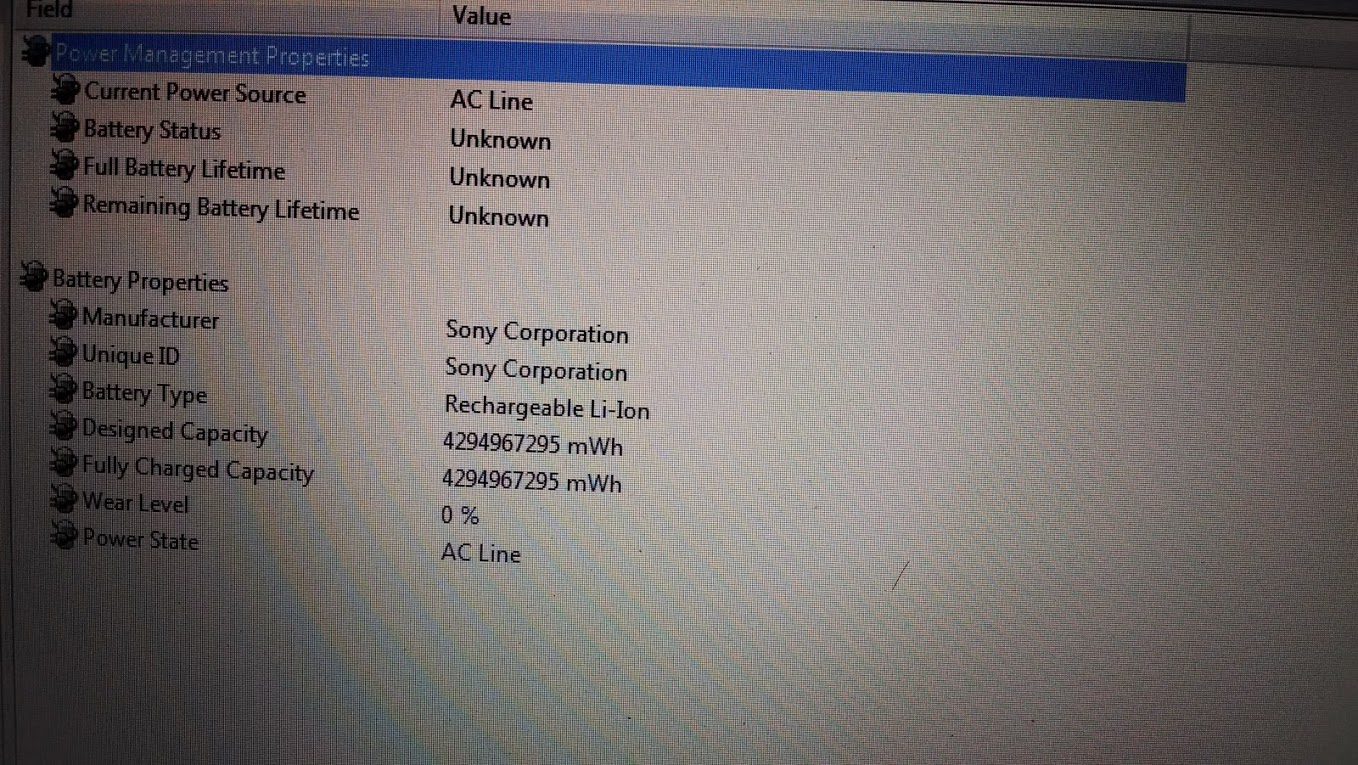

          I attached the docking board (charger IC) schematic, does anyone have any idea what are the battery signals and how to test them?
          EDIT: Attached a photo of AIDA64, battery is detected as Sony, but status and capacity are not being detected.

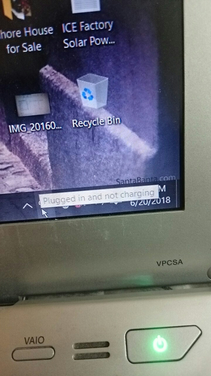

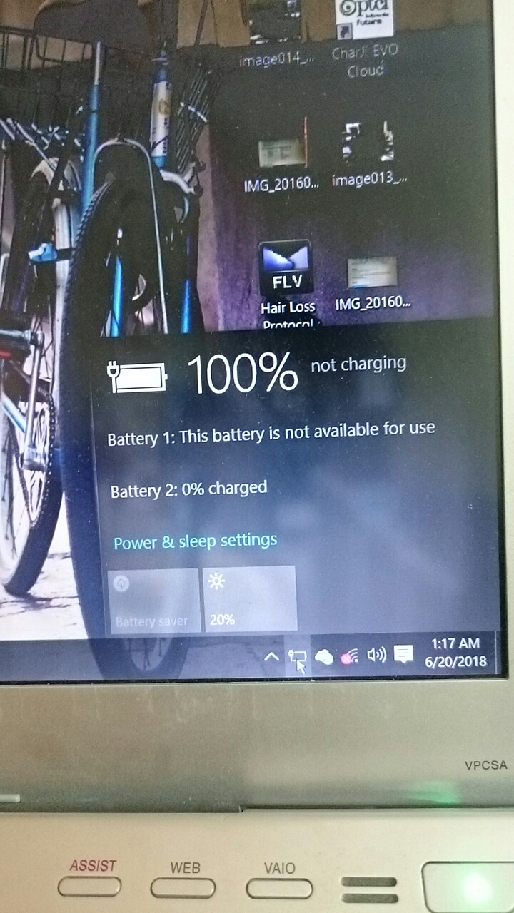

                                        I have vpcsa model and it shows plugged in and not charging and charging light keeps on flashing i tried to install the nios but it stops on say that you have updated Bios no need to install i just wanted to know how can i install the BIOS completely and how can i resolve the issue for battet assistance sharing pics.
