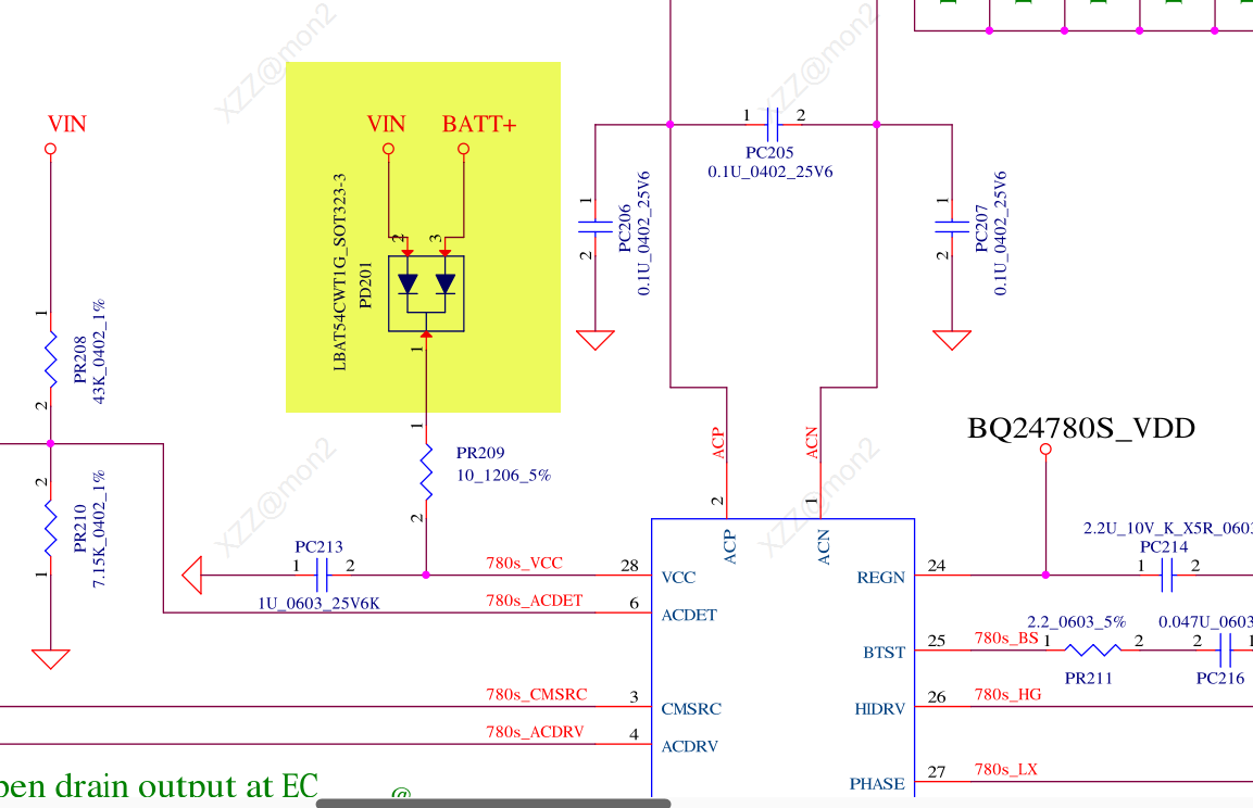

    Hello.
    i have this problem with a lenovo ideapade s145-15api.
    The charging led stays on even when the charger is unplugged. Also in windows it shows that is charging.
    Do you have any idea?
  • mon2
    • Dec 2019
    • 14575
    Yes, have seen this issue with other laptops. Remove all power. Meter in diode mode. Review the dual diode @ PD201. Test in diode mode; red meter lead on anode; black to cathode - the meter should conduct. Reverse the meter leads and the meter should block else is defective.

      Thanks for the help.
      the diode is ok.
      Any other idea?

        Disconnect the power adapter. Connect only the battery. Carefully, measure the voltage to ground of each pin on the charger IC.
        Post the list of the measurements along with their pin # and the pin function name.
        Also interested in the voltage on each pin of the same dual diode when using only the battery.

            PIN4 -- ACDRV=20.46
            Review the 2nd DCin mosfet since ACDRV should be ~25v and often, the 2nd DCin mosfet causes this fault of a low gate voltage.
            If required, will need more measurements but for now, review / replace the 2nd dcin mosfet.
            2nd DCin mosfet = PQ202.
            1st DCin mosfet = PQ201.
