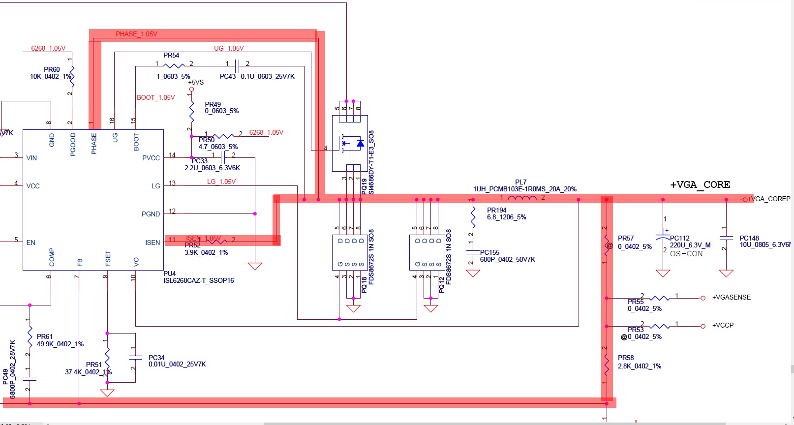

    Hi, i have this lenovo N500 that wont start. It wont spin fan.
    I found that rail i marked on picture is shorted with ground (13ohm) but i cannot find where, please help.

    PQ18 is OK, and PQ12 does not exist

      13 ohm is normal resistance for vga chip.

        ok, i found that one MOSFET have oscilating voltages.

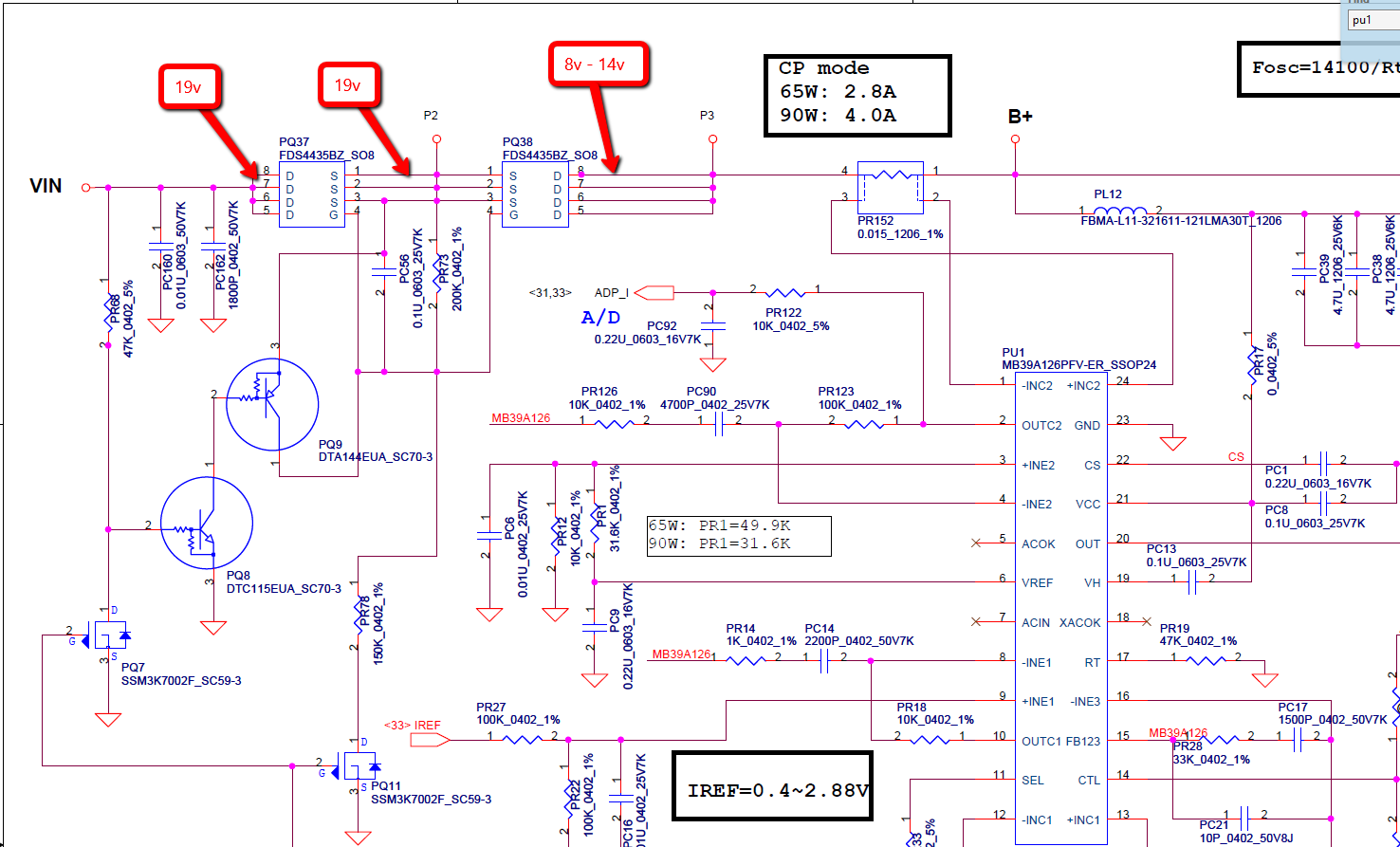

              hi, if notebook doesnt start, first look for usual 3v and 5v always if present or not. then we can go on PL10 PL11 coil. check 3 and 5 volt here

                i have 3V and 5V for few seconds, then it go to 0V

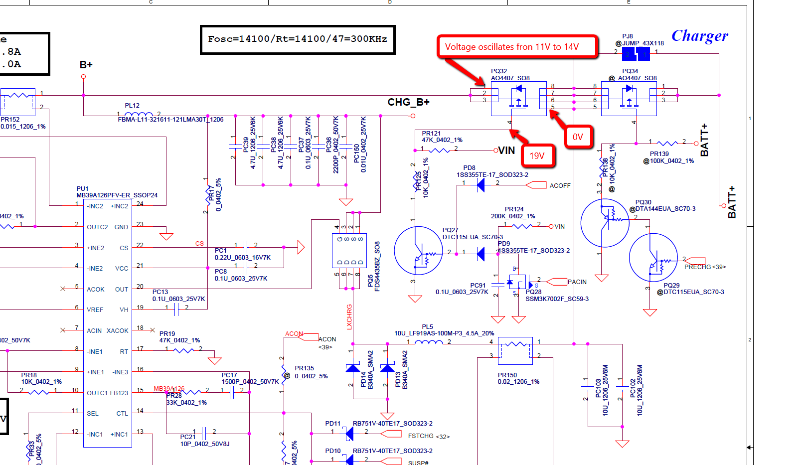

                  the ovner of laptop say that it worked on battery, but no charger. Is this the PU10 fail?

                    if with battery charged it works ill focus more on the dcin circuit rather then charger problem

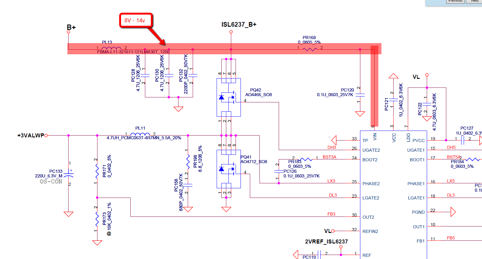

                      ok, i check PU10 and i found that VIN have oscilating voltage 8v to 14v

                        Pq42 ok

                          If the owner is correct, then pu10 should be fine, look for the charger ic PU1 fault or circuit around it.

                            ok i found that PQ38 have oscilating voltages on D

                              check PQ38 IT IS ok, I TRY TO REMOVE PL12 and then on PQ38 i have stable 17V. Is this the PU1 fail?

                                By VIN do you mean the +ve voltage point on the DC jack itself?
                                If so check for continuity between the ground nearest to the oscillating voltage points and the ground on the barrel of the DC plug. A good adapter wouldn't work when loaded to 8v. You may have an open ground somewhere.

                                  i mean VIN marked on PU10

                                    Oh yeah I see. So no oscillation at the DC jack?

                                      no, on DC jack i have 19V. In this rail i have oscilate voltages.

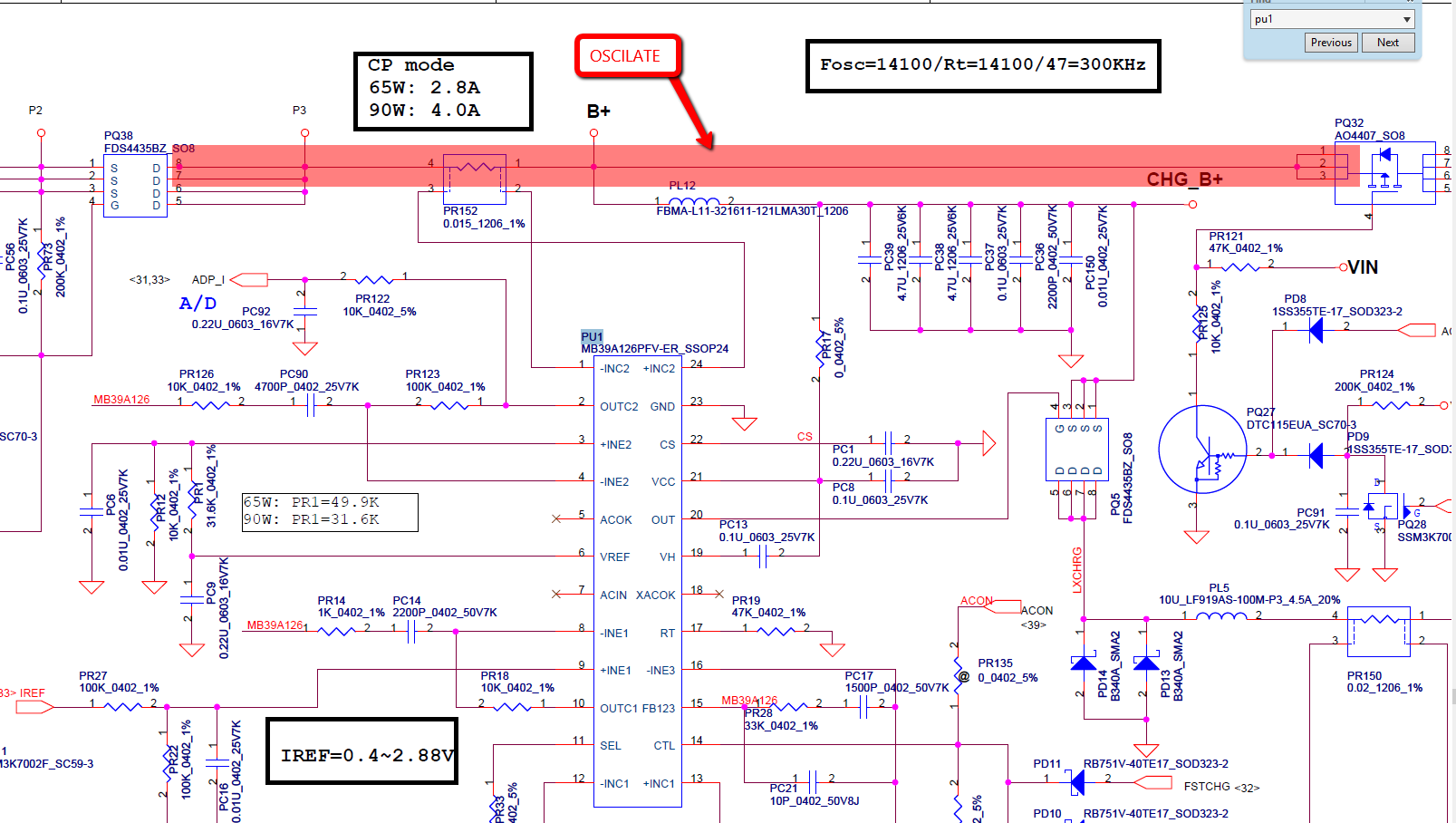

                                        Firstly that CHG_B+ rail is confusing me, it doesn't seem to connect to anything else on the schematic. But that aside for now, I would try removing PQ5 and seeing if that has the same effect. I doubt the ceramic caps are shorted or else it would be dead. It looks to me like something closest to the CHG_B+ side of PL12 is causing the oscillation, not PU10 itself.
