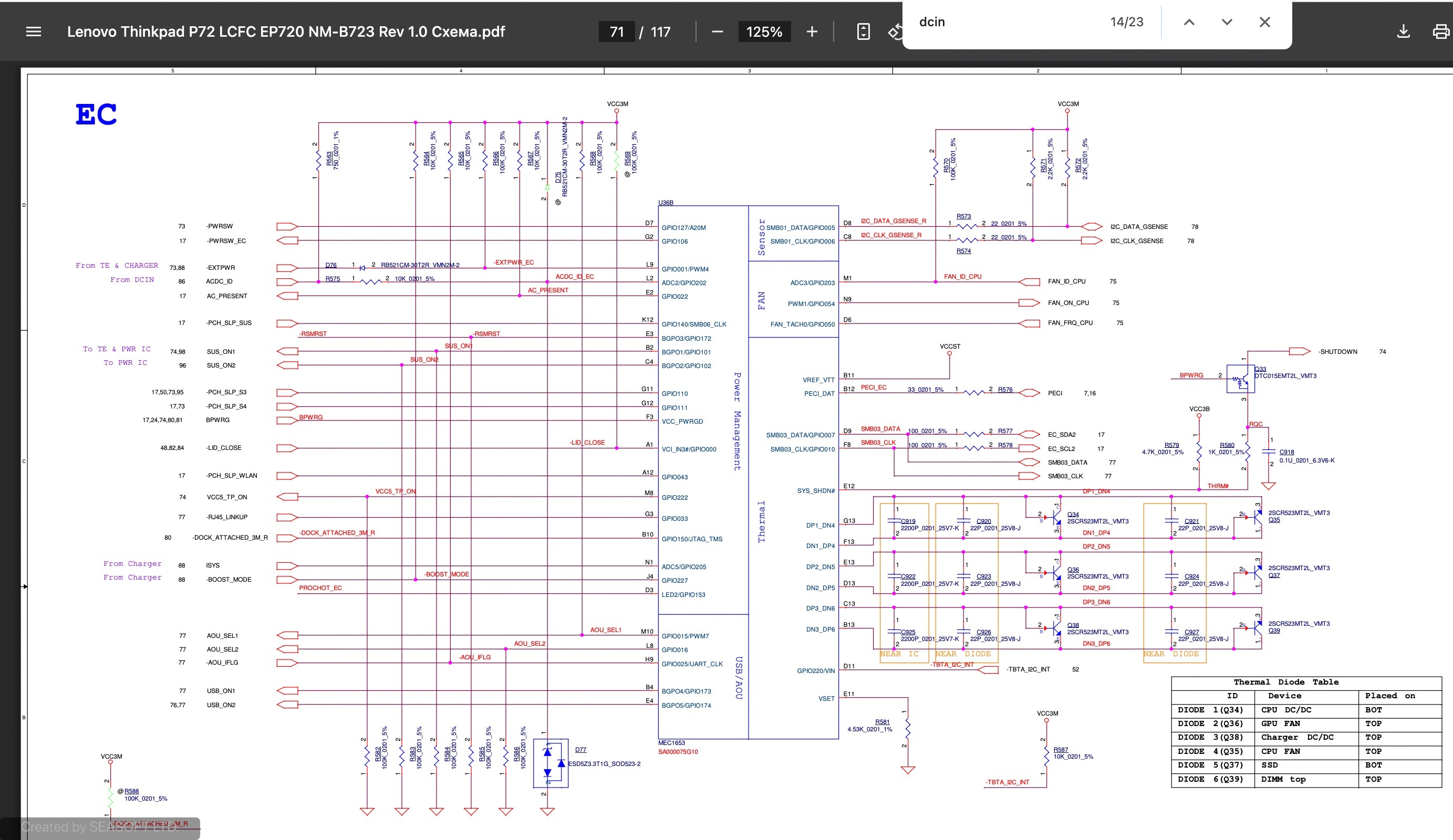

    Unfortunately I do not know the power sequence of this laptop. As far as I see the power management is controlled by one of the two Lenovo ThinkEngine chip, but there is no documentation on the net about this. It could be possible there is an another reason the rails are disabled within a short period of time.

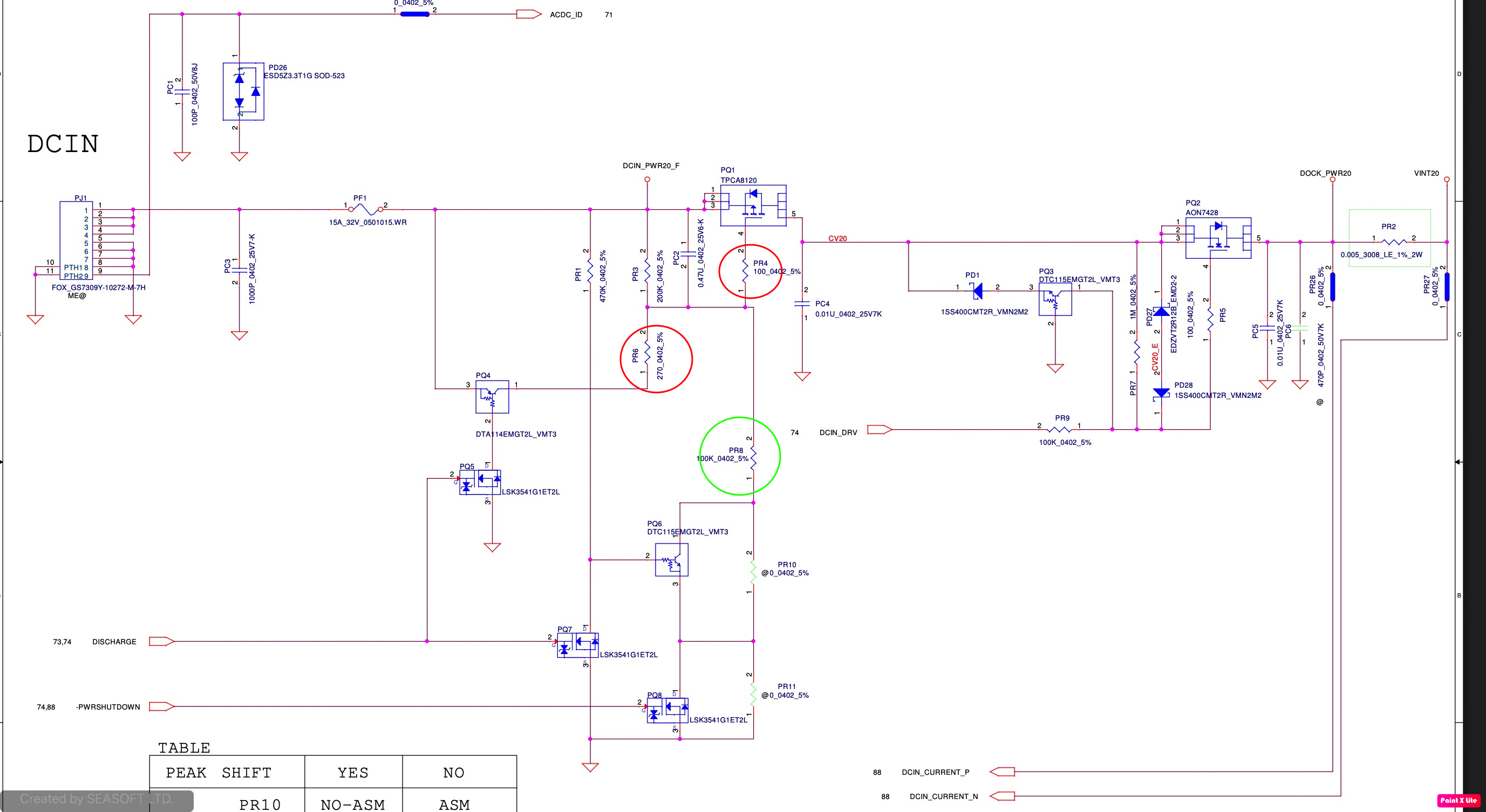

    The situation became worst: no power at all, not for one second. I have attached the schematic of the DC-IN section to better understand the "strange" situation.
    Symptom: there is no voltage at the output of the PQ1 P-channel mosfet because its gate always on DCIN_PWR20_F, ie. at 19V. It seems the Thinkengine switches off the MB immediately with PWRSHUTDOWN signal pulled to low. PQ1 pin 5, output resistance to ground is in megaohm range, no output short present.

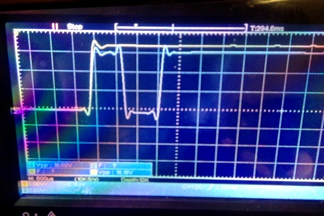

    Measured PR8 resistor's both legs with scope at the same time and got the picture attached. Yellow line on pin 2, blue line on pin 1 of PR8. Pin 1 went to high and to gnd for about 1ms and to high again. 1ms wide 3V PWRSHUTDOWN signal switches PQ8 which turns on PQ6, grounding PR8 pin1. But. How on earth the PR8 pin2 do not follow this change? PR8 pin2 is on steady 19V instead of about 6.3V for 1ms.
    To simplify the situation I removed the resistors with red circles eliminating the PQ1 gate and the PQ4 effects.
    The situation remained the same, PR8 pin 2 did not react the change of pin1 voltage drop to gnd. We have a voltage divider PR3 (200k)-PR8(100k) which is not working. Between PR3 and PR8 about 6.3V should be present for 1ms but not, it is 19V all the time. It is like there is no current flowing through PR3. The resistance between PR8 pin1 and PR3 pin 2 is about 300kohm wich is ok based on the schematic.
    If somebody has an explanation why the voltage divider is not wokring please share with me. What would be the next try to figure out what is happening with the gate voltage?
    Other question is why Thinkengine PWRSHUTDOWN output is high for 1ms only. If it is low the main power rail disabled. PQ1 is never open therefore main rail overcurrent can not be the reason to shut down the main power rail. But the first question is the PQ1 gate voltage. If the PWRSHUTDOWN signal would be high all the time the PQ1 gate voltage still remained high and the main power rail voltage would be zero.
