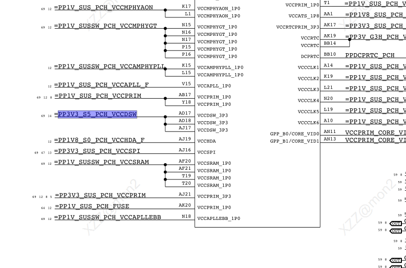

    I've recently acquired a 13 inch MacBook Pro 13 2017 (A1708, 820-00840-A). I bought it with the intention of trying to fix it and learn a thing or two about electronics repair along the way. So I've never repaired or even had another MacBook or Apple product before actually. However, I do have some experience with designing and producing my own PCB's so I do have some equipment like hot air station, oscilloscope, microscope, hot plate, etc at home. Today I received my USB ammeter and got to work.
    The USB ammeter first showed 5V and after a few seconds it was up to 20V, so if I understand correctly that means that both of the CD3215 IC's are doing great. But of course I bought the thing as defective and that showed... When it reached 20V I noticed it got stuck at 0.045A. Weirdly enough it got stuck at exactly 0.04500A. Sometimes it would briefly go a few decimals off but then quickly go back to exactly 0.04500A.

    I wonder if anyone has some tips for me on how to continue and what to measure next. I know someone who has a FLIR camera which I could borrow if necessary to better visualize voltage injection.

    Remove all power. Meter in resistance mode. Measure the resistance to ground of each inductor (usually grey in color; 2 leads). Checking for lower than normal resistance to ground. Report any suspects for a review.

      Here are some measurements. The ones I left out were all super high resistance, usually in the MΩ range.
      L7430 2.1 Ω
      L7410 2.1 Ω
      L7420 2.1 Ω
      L7210 4.1 Ω
      L7370 6.5 Ω
      L8060 0.4 Ω
      L7900 0.4 Ω
      L8030 212 Ω
      L7960 35.9 Ω
      L7690 0.5 Ω
      L7900 seems to be dead short to ground. This kinda worries me since I saw it's connected to the PCH...

        This is a show stopper. You have a shorted part on this rail. Would you have an adjustable power supply? Consider to use it at 1 volt (to be safe; not higher) and inject onto this inductor. Whomever is shorted will heat up and/or crack under the injection pressure. Often it is a shorted capacitor. The PCH may be also low but start with this review and hunt down the suspect.

          3 power rails going to the PCH shorted to ground? Conclusion should be pretty obvious, no point in wasting time.

            I tried the voltage injection at L7690 but my power supply can't do more than 3A. It was near impossible to spot or feel anything heat up. I also tried pouring some IPA on the board but it didn't really help. I think I saw the alcohol evaporate a tiny bit quicker near the PCH, but it could just be my mind thinking I saw that because it seems likely to me that there's a fault there. I will try to borrow a FLIR camera next week and have a better look at it. I'm doing this purely as a hobby project and to learn a thing or two so there's basically nothing to lose at this point. I will update the post if I find something.
            Could it be helpful to desolder L7900 or L8060 and see on which pad the short is on?

              The PCH is dead...

                  L7690 is a power rail (PP3V3_S5) that feeds many sections of the board including the PCH / CPU. Remove the heatsink off the CPU. Test again to see if the PCH is heating up.

                      A thermal camera will really be helpful here. Suspecting a shorted capacitor. You can also consider a low ESR meter used to measure in the milli-ohm range for components. This process will then demand to test each and every part on the board to hunt for the shorted component.
                      Alternatively, but in my opinion risky, is to check if there is a path from this shorted one to the CPU rail / any low voltage rail on the board. If not, only then you can consider to use a higher voltage to 'smoke' out the shorted component. We are using a product called 'short killer' which is dialed up to 0v8 (by us) but will spike out 20A/30A surges. This combination cracks up the target part in seconds. No can hind under this pressure. Purchased it from Aliexpress. A good variable power supply should also be ample. Can you push out 5A or more on yours?
