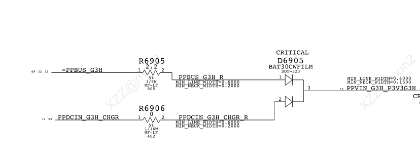

    Hey guys, I need a little help here. I have a MacBook Pro A1708 820-00840 stuck @ 5V. Started off affecting just one port but now it's affecting both. Both CD3215 ics were replaced but the issue remains. One port does a loop and the other stays at a constant 5V. Both CD3215 have 3V incoming. I checked for PP3V3_G3H @ R3000, C3100 and C3108, R3001, C3200 and C3208. The weird thing is though that the ammeter shows the current draw (5V @ 0.5A) coming out from the port as opposed to it going in. Any ideas on helping me fix this?

                What is the voltage to ground on D6905? Test each pin. Post each measurement.
                  With charger plugged in to the looping port
                  PIN 1 = 0.086V
                  PIN 2 = 1.7V then 5.02V cycling
                  PIN 3 = 4.7V then 1.7V then 2.4V cycling
                  On the constant port
                  PIN 1 = 0.094V
                  PIN 2 = 0.9V
                  PIN 3 = 0.8V

                          Meter in DIODE mode. No power to the board.
                          Confirm that the dual diode @ D6905 is ok. Red meter probe on pin # 1; black meter probe on pin #3. Meter should conduct.
                          Reverse the meter leads and the meter should block.
                          Repeat to test pins #2 and pin #3 in the same way. We want to check that D6905 is leaking and allowing for a reverse voltage to travel through the part.
                          Also, what is the voltage to ground of PPDCIN_G3H? Is it stable?
                            Diode is testing good
