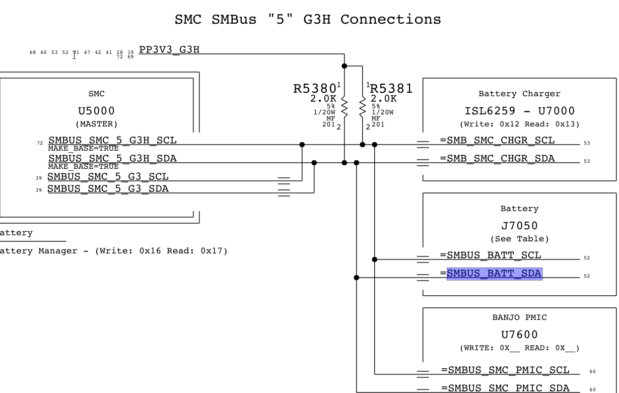

    SMB_PMIC_SDA is not shorted to ground (~7k5 resistance) but is showing ~0v8 on the SDA line.
    The local pull-up is present for the SDA line @ R5380.
    SMB_PMIC_SCL is showing ~3v3.
    Could the SMC chip be defective (U7800; SN650839ZAJ) or U5000 ?
    Will replace R5380 tomorrow to rule out this component. Resistance checks out fine for this pull-up.

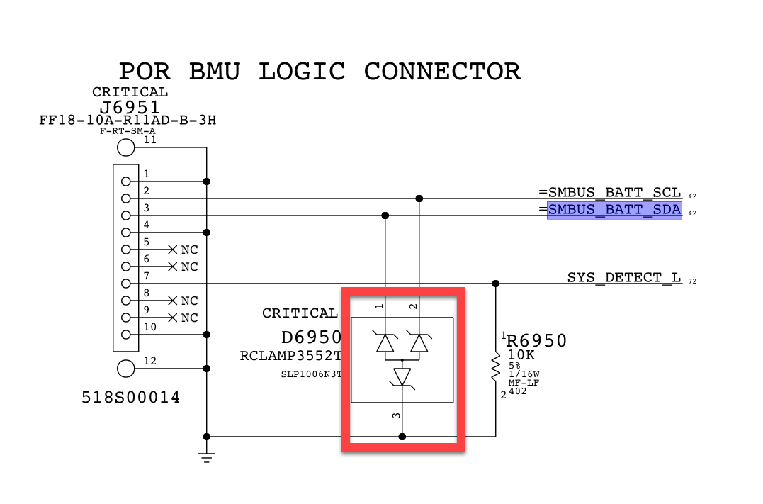

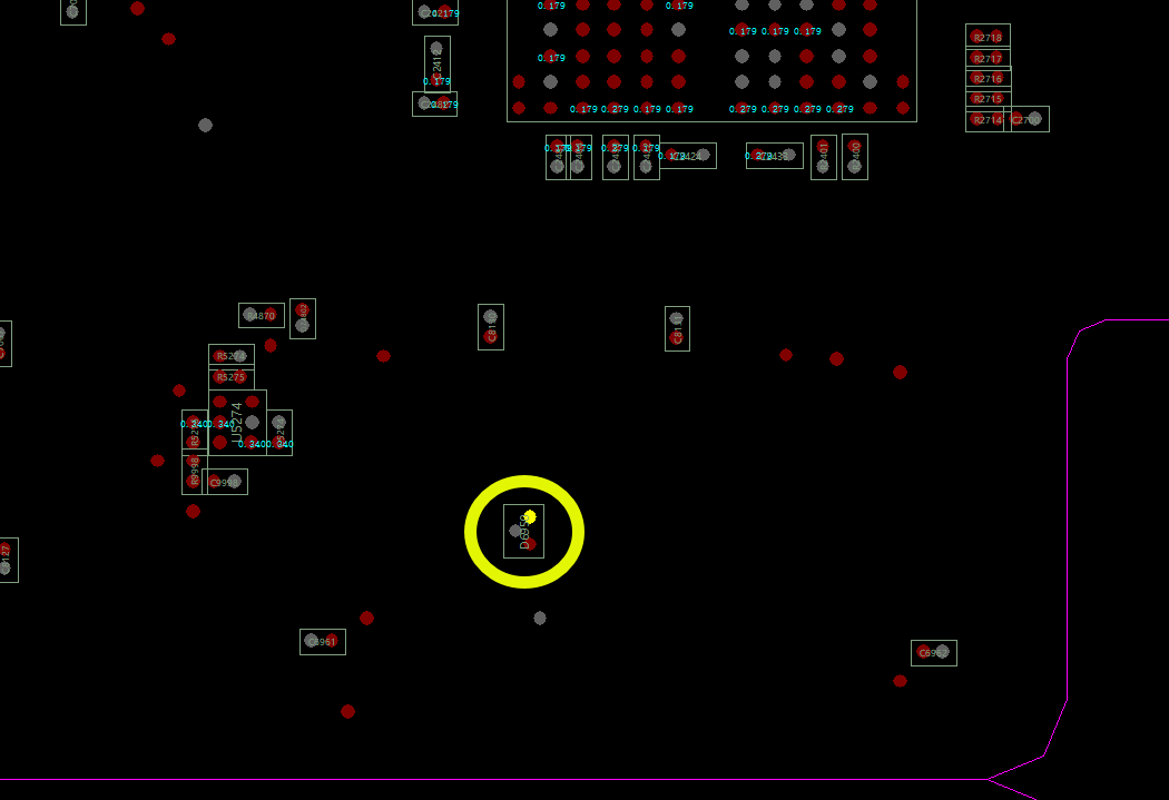

      My Peter Parker sense is tingling. SMBUS_SMC_5_G3H_SDA communication line, that is stuck low @ 0v8 is also mated with SMBUS_BATT_SDA. This party line is then mated with the battery connector and also a local TVS diode (D6950) to protect transients on the SCL & SDA lines.
      The TVS diode @ D6950 looks like a possible candidate for this fault. Will reflow and/or remove to confirm.

        Removed D6950 off the board.
        We have PPBUS_G3H !!!!!!!!!!
        After removing D6950, the resistance to ground increased for the SMBUS_BATT_SDA rail (and also for SMBUS_BATT_SCL).
        Type C meter now climbs much higher than the ~35mA that was not allowing for the board to boot.
        So, U7000 + mosfet (Q7030) were both replaced. Numerous parts on this SMBUS line were reflowed but could not fix this fault. In hindsight, do not believe that either of these parts were to blame and did not require to be replaced. The SMBUS interface was being pulled down and prevented for the proper communication by the SMC (SMC bus master) with this slave switching buck regulator.
        PPBUS_G3H remained OFF (about 20-30mV).
        Removing the TVS diode @ D6950 now allows for a healthy voltage @ PPBUS_G3H.
        Have some fresh TVS diodes in transit from Arrow to replace and ship out this computer
