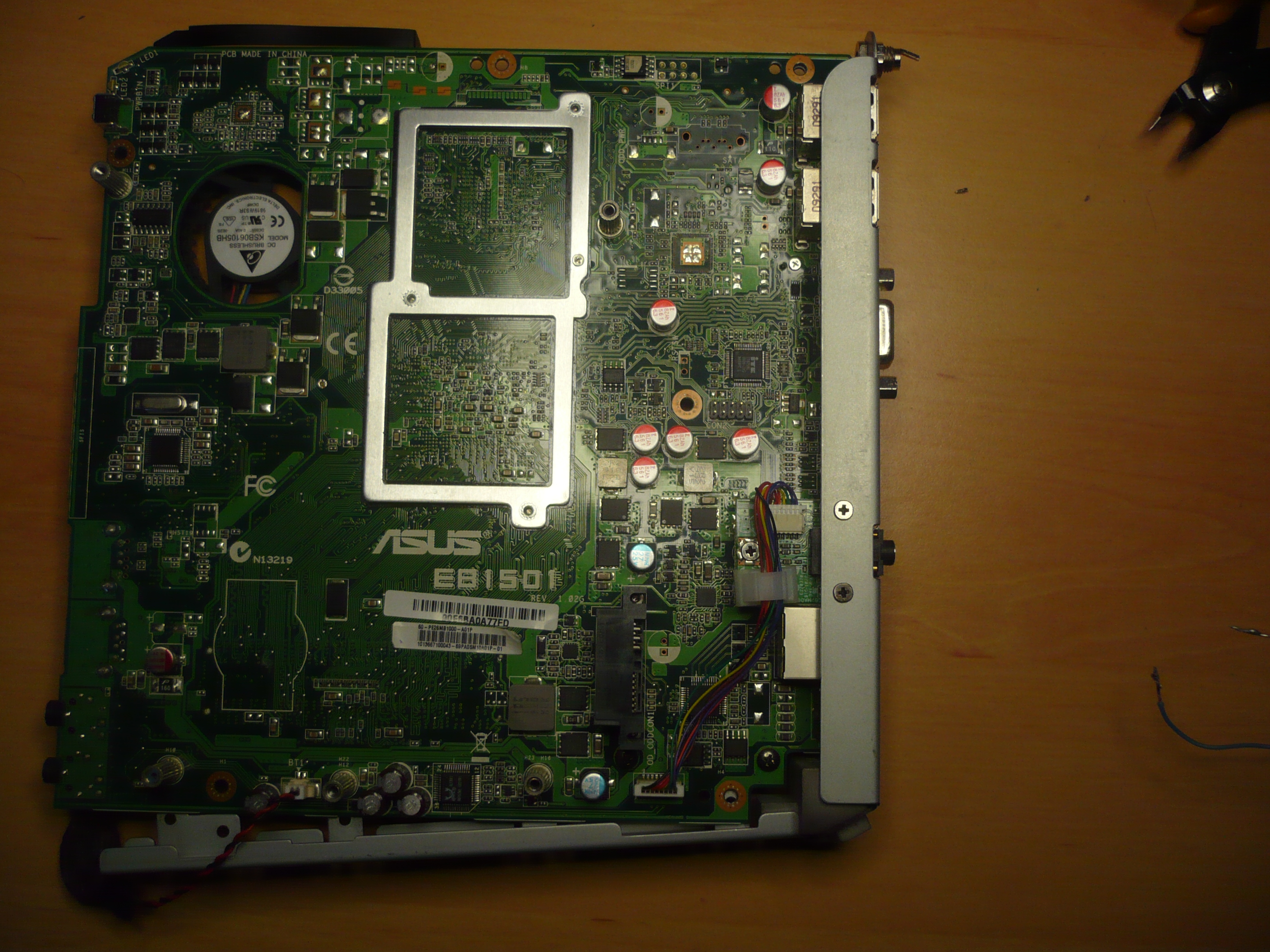

    Tried reseating the Ram? Perhaps post good clear pictures of the back and front of the board - maybe someone will spot something.

          Selldor, I have already reseated the RAM but nothing had changed. Yes, i will post pictures ! Good idea but I have to find my camera

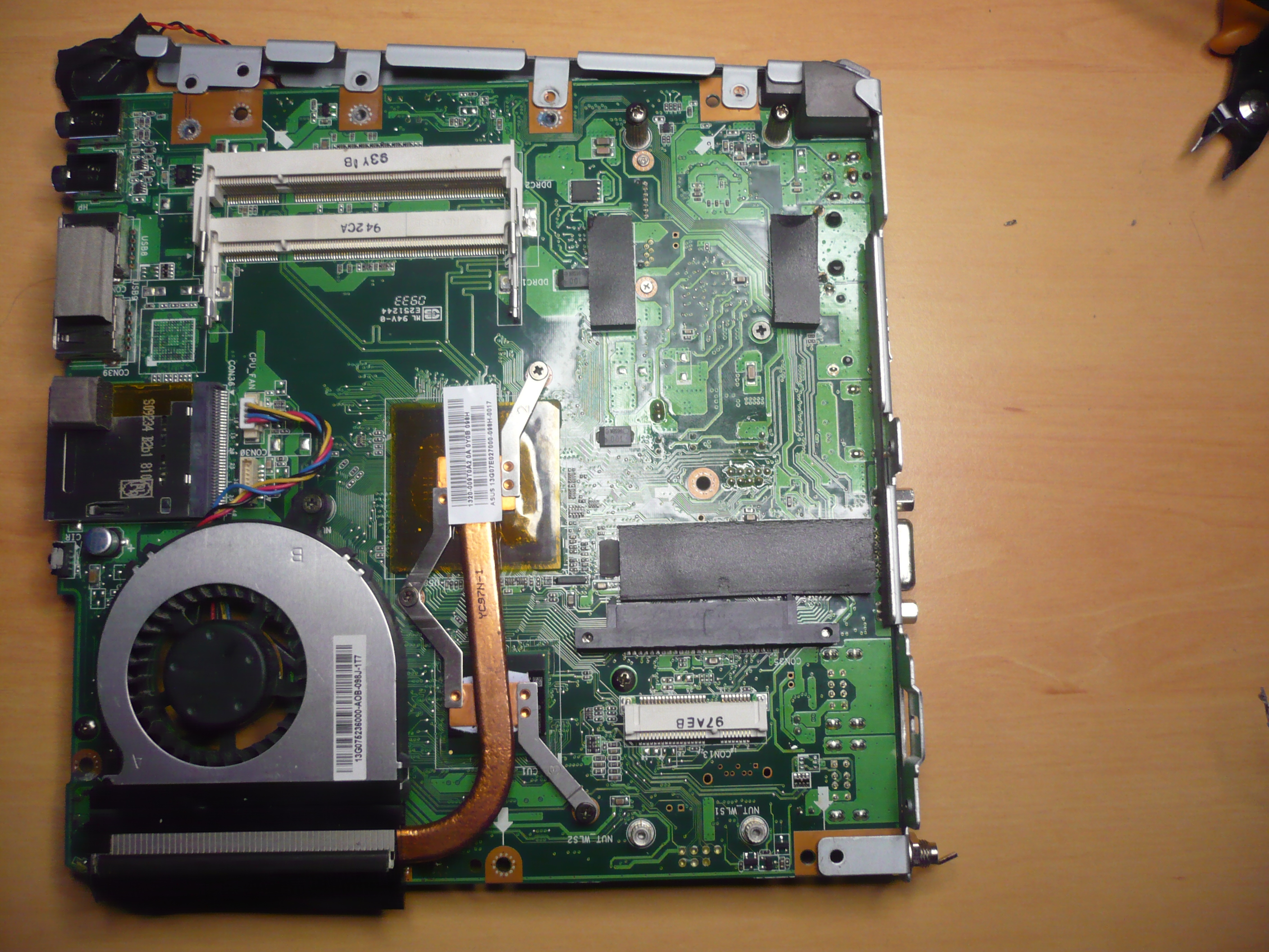

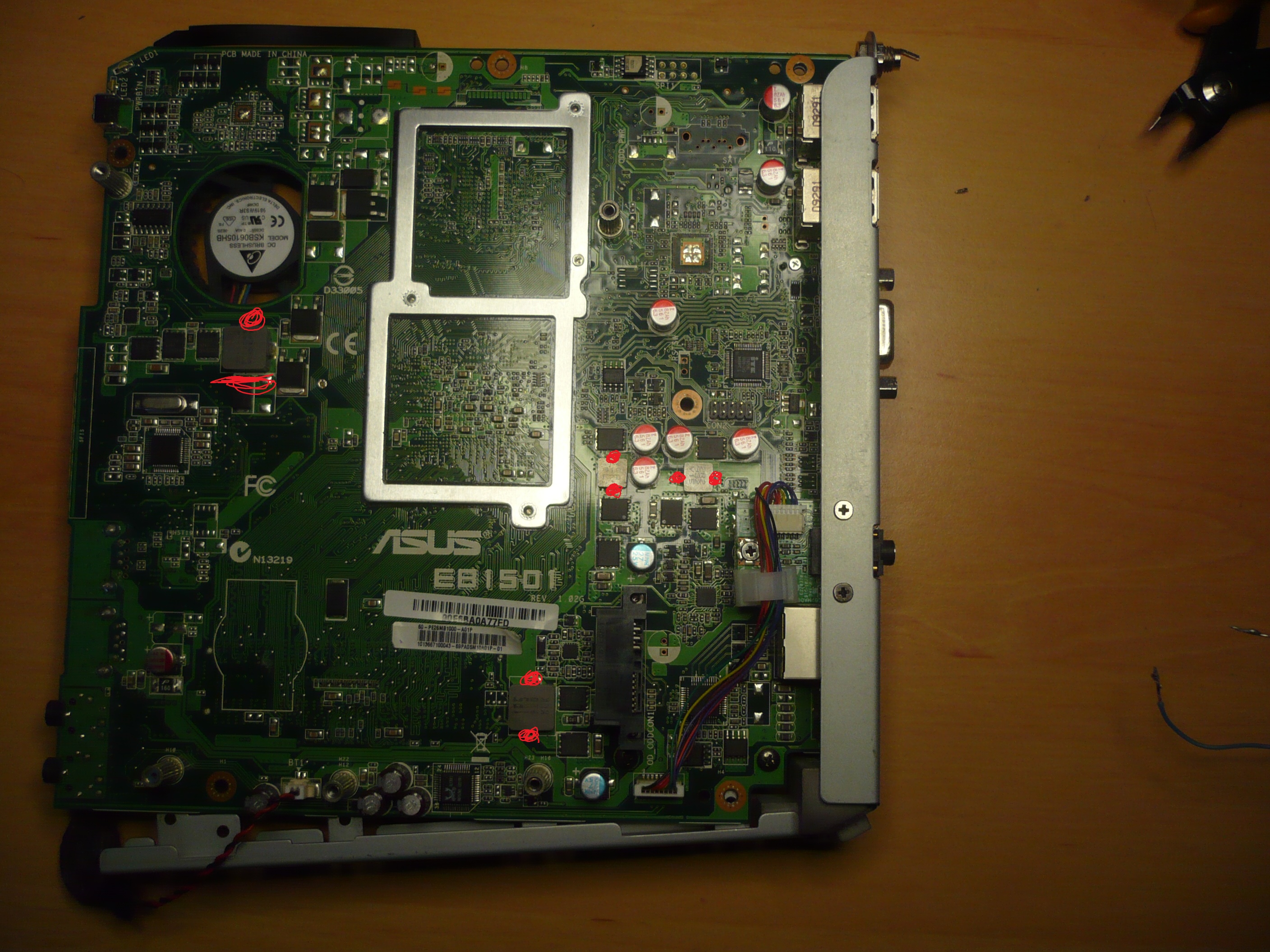

              I plugged my EeeBox on my laboratory power supply. The current consumption is only 0.05 A (about 1W) ! Maximum current labeled on the power adapor is 3,42 A ( so 65W with 19v) and i limited the current on my power supply at 0.5A to be sure do not destroy components. But, as soon as I press the ON button, the power supply indicates 0A.
              If I had a permanent short circuit with one of the components, I should have a bigger current. So I assume that the system goes into safety mode and disconnect the power circuits.
              Or the bios is corrupted as indicated by spidey and I'll have to play with spi !
              But it seems possible :
              http://bios-repair.co.uk/SPI-ISP/spiflash.html
              I posted pictures, If someone sees something suspicious do not hesitate to tell me!
              Regards,
              Stéphane

                Re: Asus EB1501 power on failed
                Hmm
                Soldered cpu.. Where could be the problem.
                Reflow cpu and cipset

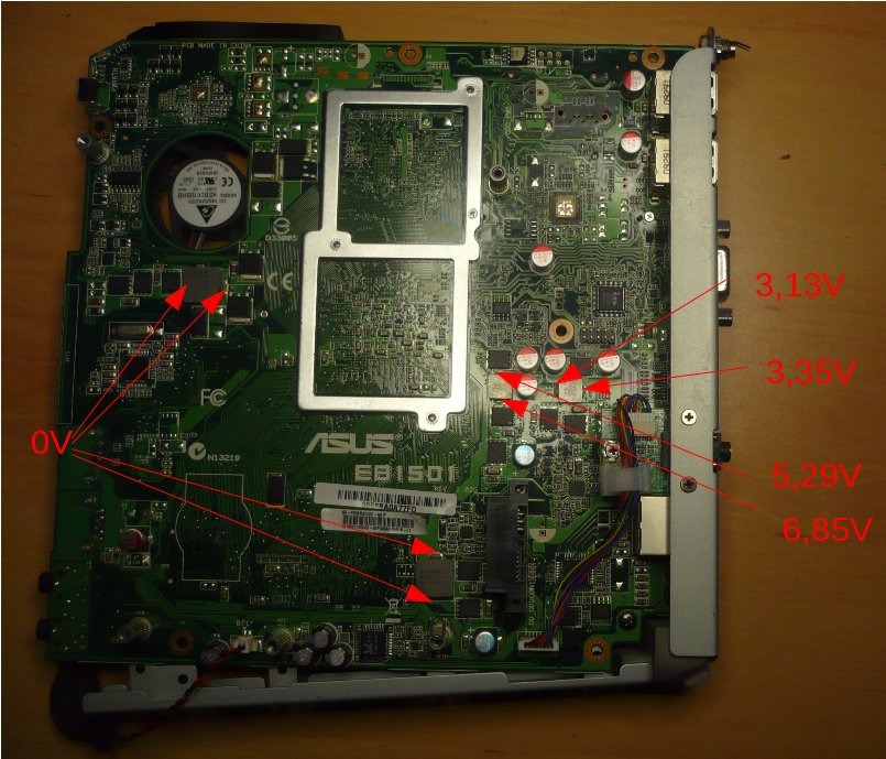

                  first check voltage to this 8 pin, then if both side of each one is shorted:
                  • Stephane R
                    • Feb 2014
                    • 7
                    • france
                    Hello dellxps15,
                    2 resistors are supplied. One of them delivers 5.29 V and the other 3.13V. The 5.29V voltage is the same I found on USB. These voltages are issued by Mosfet "k0355" controlled PWM I think (I would have checked with oscilloscope).
                    And then when I press ON I lose all voltages except the 19v applied to the mosfets. I do not think the mosfet are damaged because when I have no output voltage, the Gate is no longer supplied.
                    Regards,
                    Stéphane

                      • 3d0
                        • Jan 2014
                        • 159
                        • BiH
                        I think what dellxps15 was trying to say is, check if the coils are short to ground.
                        • Stephane R
                          • Feb 2014
                          • 7
                          • france
                          Ho, sorry, I thought it was resistors! In ohmmeter, one of them (the lower) shows only 3.5 ohm connected to the ground. It's low! While all of them are behind a mosfet in series with the supply line! I will investigate that !
