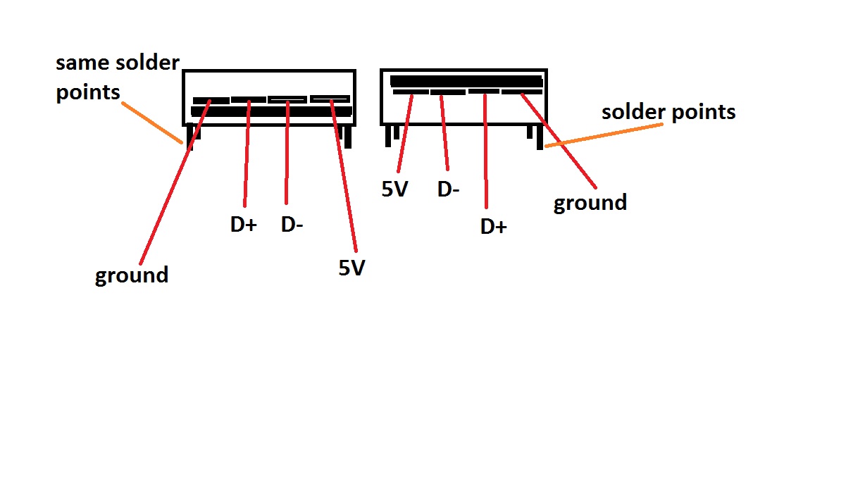

    Hello everyone. I have a LA-4854p Acer mobo with broken usb ports. This mobo have only 2 usb ports and both broken. I pulled out old ports and soldered new ones. Board worked well. I checked new soldered usb pins. No short circuits and checked 5v voltage. But there is a problem. When i plug in an usb device, 5v drops to 0v.
    I checked pins of D23 , C538 , U28. They are all working properly. What should i do.

    check that you have not fitted the wrong usb ie usb1

        I'm getting closer. When something plugged to usb, board cuts power. Something is making short circuit with usb but what? By the way i replaced U28 too.

          Re: Usb voltage 5v to 0v
          Make sure you check the proper positioning of the port you just soldered.
          A few months ago I made a mistake of replacing the port. The port is almost identical until I noticed that the inside pins are inverted. Check the images I attached. hope this helps
            You know i just figured it. My ports are reversed ones. Thank you man.
                    so it means lgf700b not fitted well usb1 and usb2? is that different
                          oh im understand reversed mean u soldered in wrong position right.
                          • lezsimply
                            The Wanderer
                            • Jan 2013
                            • 645
                            • Philippines
                            in some way yes, check post #5. same solder points but different pinouts.
