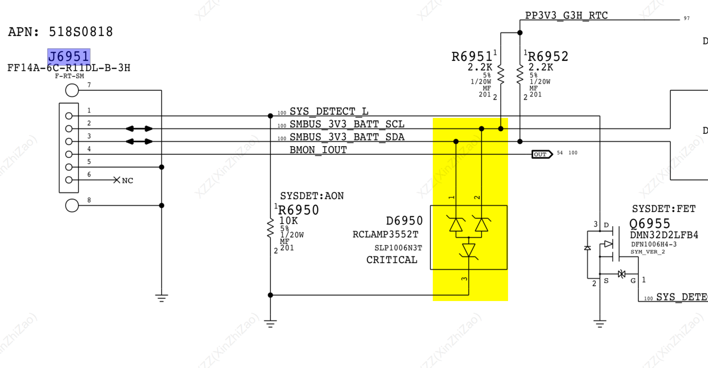

    Hey there,
    I have a MacBook 820-0085-a that was working perfectly, after keyboard replacement the MacBook would not charge any more. As we speak the battery might be completely dead. I think that this MacBook need a battery to boot up.
    I have a very limited experience with newer MacBooks. If anyone would suggest where to start taking measurements or testing, I would appreciate it.
    All I know is that the MacBook was working perfect before the keyboard switch.
    A tech confirmed that he used a universal charger.
    Thank you
  • mon2
    • Dec 2019
    • 14659
    I think you mean 820-00850 logic board.
    Do you have a USB Type C meter? To confirm, even after the keyboard was replaced, only the battery would not charge?
    Remove all power. Meter in resistance mode. Measure the resistance to ground of each pin on the battery connector. It is ok to remove the battery and then probe the pins on the battery connector that is on the logic board.
    No battery / no power adapter during these tests. You can use the metal shield for the ground on the logic board.
    Pins # 2 & # 3 are of the most interest. These are the SDA / SCL lines which are the SMBUS / I2C lines used to communicate with the battery BMS inside of the battery pack.
    Post each measurement.

        Thank you for getting back to me.
        You are correct the model is 820-00850.
        after the keyboard replace whoever replaced it said that it would be possible to turn it on, but didn't charge.
        me I never saw the MacBook turning on.
        Yes I do have usb c meter tester.
        i think on the downside of the usb c port have different behavior that the top ones.
        Measuring the battery in diode mode connector it seems that everything is good.
        j6951
        Pins:
        1)0,5
        2) 0.8
        3)0.8
        4) OL
        5) GND
        6) OL

          What is the voltage to ground on pin #2 of the battery connector? Red probe on pin # 2; black probe to ground.
          Repeat for pin #3 of the battery connector. Post each voltage measurement.
          What voltage and current draw is showing on your USB Type C meter? It should be 20V if working properly.
