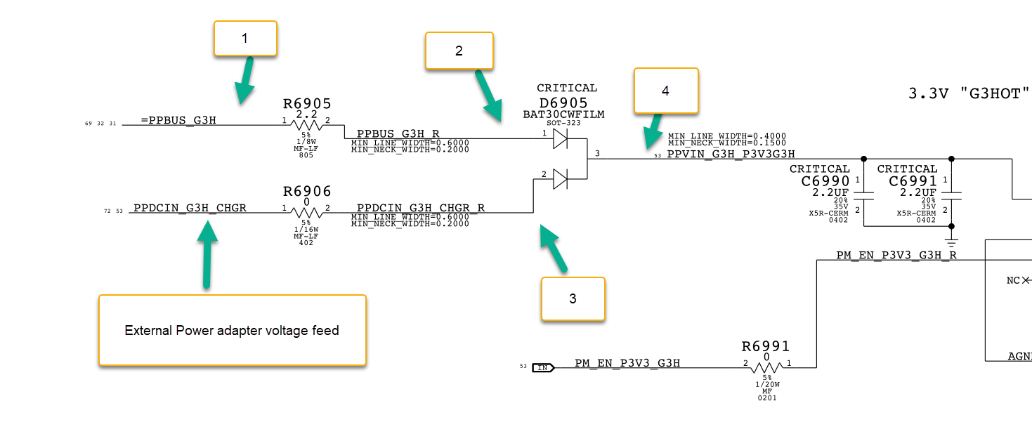

                            Re: Macbook Pro 13'' 2017 A1708 Won't power on with battery connected.
                            See attached.
                            Remove the power adapter. Connect only the battery.
                            Meter in DC volts (20v or higher is ok).
                            Measure the voltage to ground on each point of this dual common cathode diode.
                            This diode is used to select the higher of the 2 power rails. Since the external adapter is removed, only the PPBUS_G3H side should be active. Need to confirm the voltage to ground of each leg.
                            It is possible that this diode @ D6905 is defective.
                              To test the diode in another way.
                              Remove all power. Meter in diode mode.
                              Red probe to the back side of the diode (anode), ppbus_g3h feed. Black to the cathode of the diode.
                              What is the measurement? Reverse the leads. What is the measurement?
                              Now move the red meter lead to the other anode pin, charger input feed. What is the measurement?
                                0.203v on both the two separate measurements u requested
                                Reverse leads says 0.L
                                    Okay so good thing i didn't stick the battery down yet. so i have the new battery out of the chasis with battery and board alone connected ok..
                                    D6905
                                    Pin 1 = 12.47v
                                    Pin 2 = 0v
                                    Pin 3 = 12.68v
                                    U6990 Pin 3 = 3.4v
                                    Pin 10 = 5.166V
                                    isn't pin 10 which is the enable for U6990 supposed to be 3.3v ?
                                    Last edited by platinumsteel; 03-04-2023, 10:39 AM. Reason: missed voltage difference
                                    • mon2
                                      • Dec 2019
                                      • 14672
                                      So far ok. I think the voltage readings on pin # 1 and pin # 3 of d6905 are maybe reversed?
                                      Pin #1 should be higher -> then the diode will lower the voltage by a small amount since it is not a piece of wire and there is a voltage drop onto pin #3.
                                      Otherwise ok.
