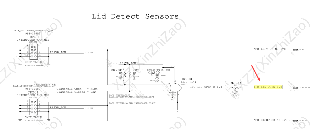

    There is a hall effect sensor in the trackpad that is used to sense if the display lid is open or closed. Perhaps that is faulty and you should check the IPD_LID_OPEN_1V8 logic level at this stage of your repair.
    Monitor this voltage when the lid is open and compare to the value when it is closed.

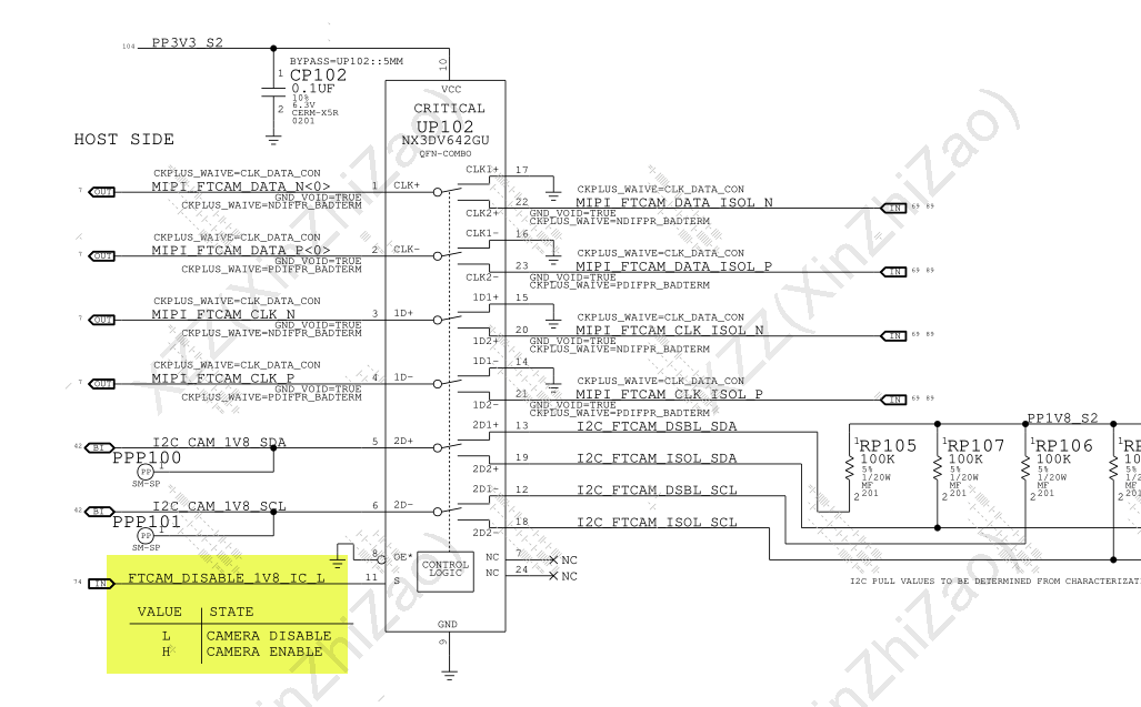

    Is the camera listed in your hardware device listing? Or is not detected at all? There is a multiplexer chip @ UP102 that is used to ENABLE / DISABLE the camera and is selected by the end user for privacy reasons.
    Review the voltage to ground of FTCAM_DISABLE_1V8_IC_L. Post each measurement.

      I've checked
      lid open IPD_LID_OPEN_1V8 - 1,8V
      lid closed IPD_LID_OPEN_1V8 - 0V
      Camera is not available also in system report when I select camera I got information that no camera device connected.
      I'm not sure if I have correct board view or what but where UP102 should be I have only two metal shield for CPU clamps.

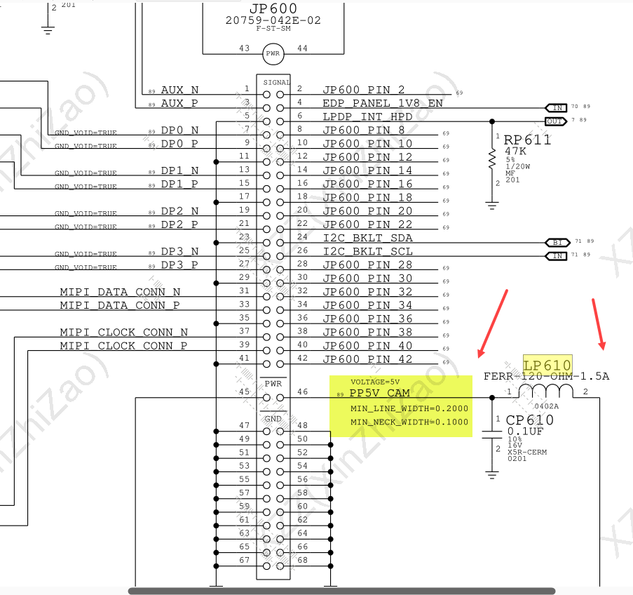

            Measure the voltage to ground of PP5V_CAM on each side of LP610.
            • obelix24
              • Jun 2023
              • 300
              • Slovakia
              #46
              Hi thank you for response.
              5,2V on each side of LP610
