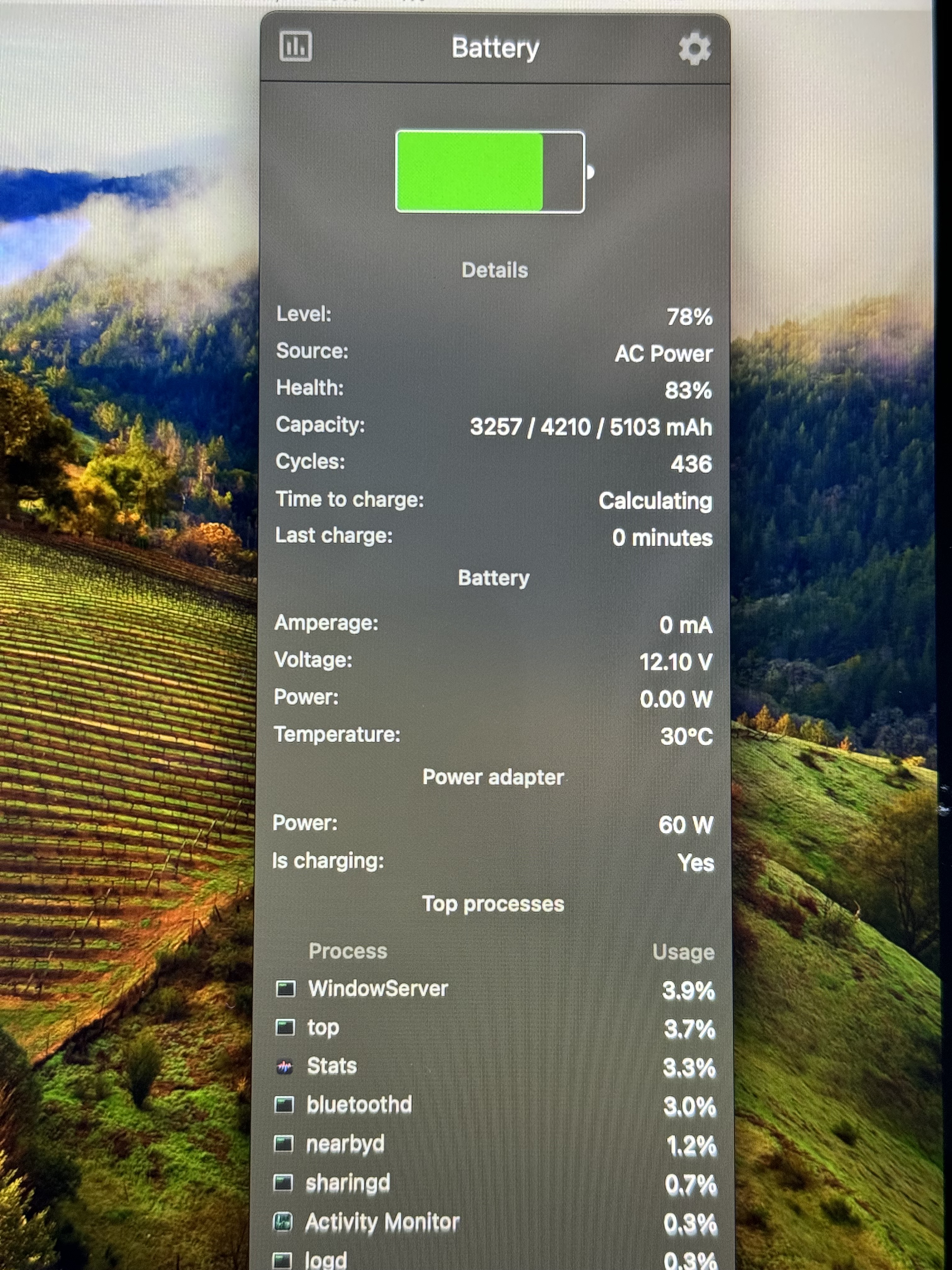

                                        ok I've measured battery pins when battery and charger are connected :
                                        I2C_SMC_PWR_3V3_SCL - 3,2V not stable falling to 2,8V
                                        I2C_SMC_PWR_3V3_SDA - 3,2V not stable falling to 2,8V
                                        SYS_DETECT_L - 0V
                                        When battery is disconnected and charged is connected I've measured :
                                        I2C_SMC_PWR_3V3_SCL - 3,2V stable (it's going from 3,251V to 3,249V)
                                        I2C_SMC_PWR_3V3_SDA - 3,2V stable (it's going from 3,251V to 3,249V)
                                        Also I have issue that Power button is working but Touch ID not.
                                        Also camera is not detected.
                                        Touch Bar starts working - I have to test it more.
                                        battery is showing 12,10V and 0a in stats
                                        • obelix24
                                          • Jun 2023
                                          • 300
                                          • Slovakia
                                          #40
                                          ok update. Battery is charging fine now.
                                          Issue was that I didn't know that over battery connector (that one attached with screw) was missing one black part that was creating probably more pressure
                                          So now I have 2 issues left.
                                          1. Touch Bar is working but when I turn on MacBook it's black, I close the lid a reopen and Touch Bar is fully working
                                          2. camera is not working. I was told by previous owner that it was working before.
