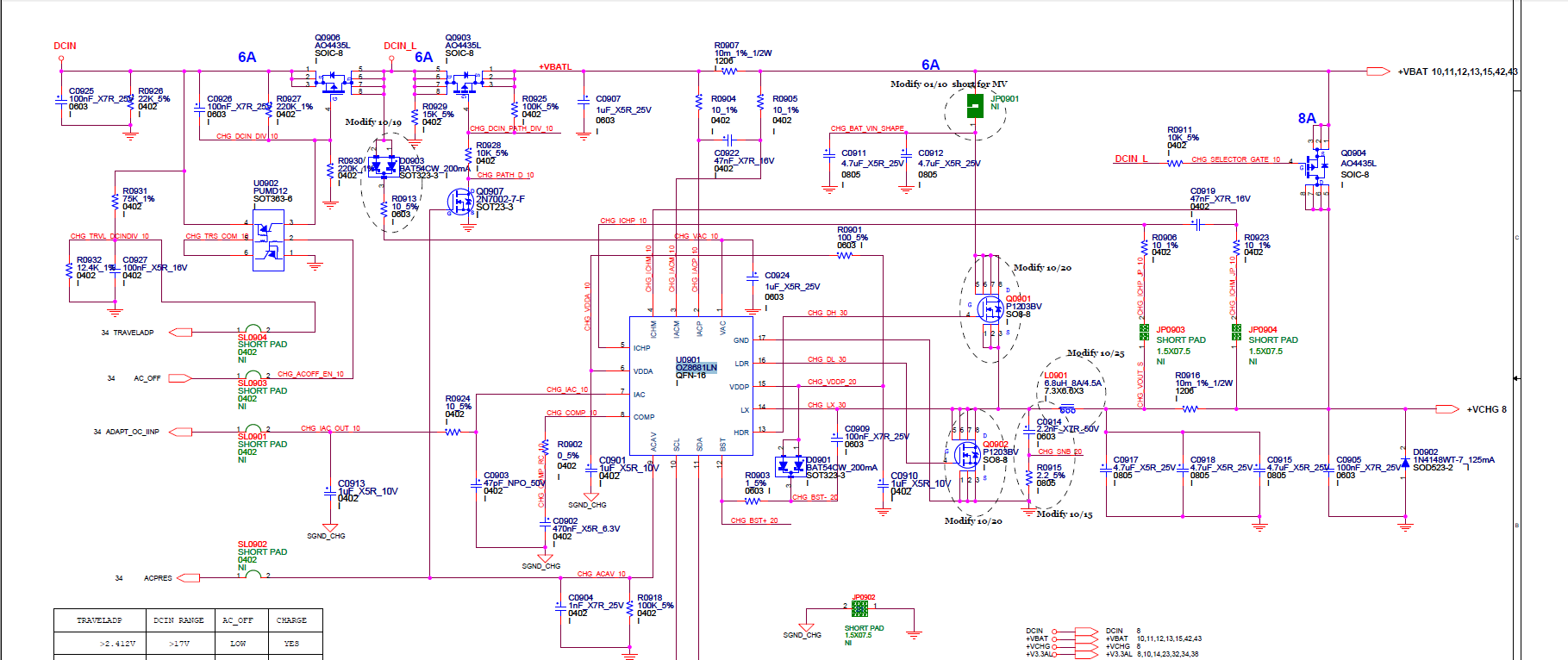

                              in compaq CQ43 have 8186L ic. it pwr charging ic. what compatible for this ic? i attach picture schematic diagram for this ic.
                              im measure Q0902 on all pin no volt. Q0901 got 19v on pin 5,6,7,8. i think 8681L is culprit and need replace but i dont have the ic
                                #55
                                Re: List of pin compatible Laptop ICs
                                On the bottom left of the page, part of the CHART is cutoff so you cannot see what they are supposed to be.
                                I can see that TRAVLADP has to be >2.412, the DC IN has to be >17V, AC OFF = LOW, then the charger will be 'YES'.
                                So the circuit may not be getting the required signal for the charger to function.
                                OZ8681 is available on line. IE. http://www.aliexpress.com/store/prod...223328230.html
