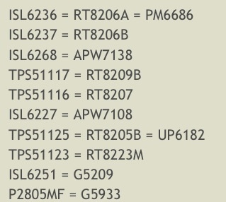

    Re: List of pin compatible Laptop ICs
    Here.
            Rt8206b = tps51427 = isl6237
            isl6236 = rt8206a = pm6686 = sn0608098 = max8778 max17101 max17020
                                    are there any substitute for tps51123 besides rt8223m? like from maxim? thanks
                                    • highpulse
                                      i hate HP
                                      • May 2013
                                      • 1488
                                      • portugal
                                      51123 can be replaced by 51125
