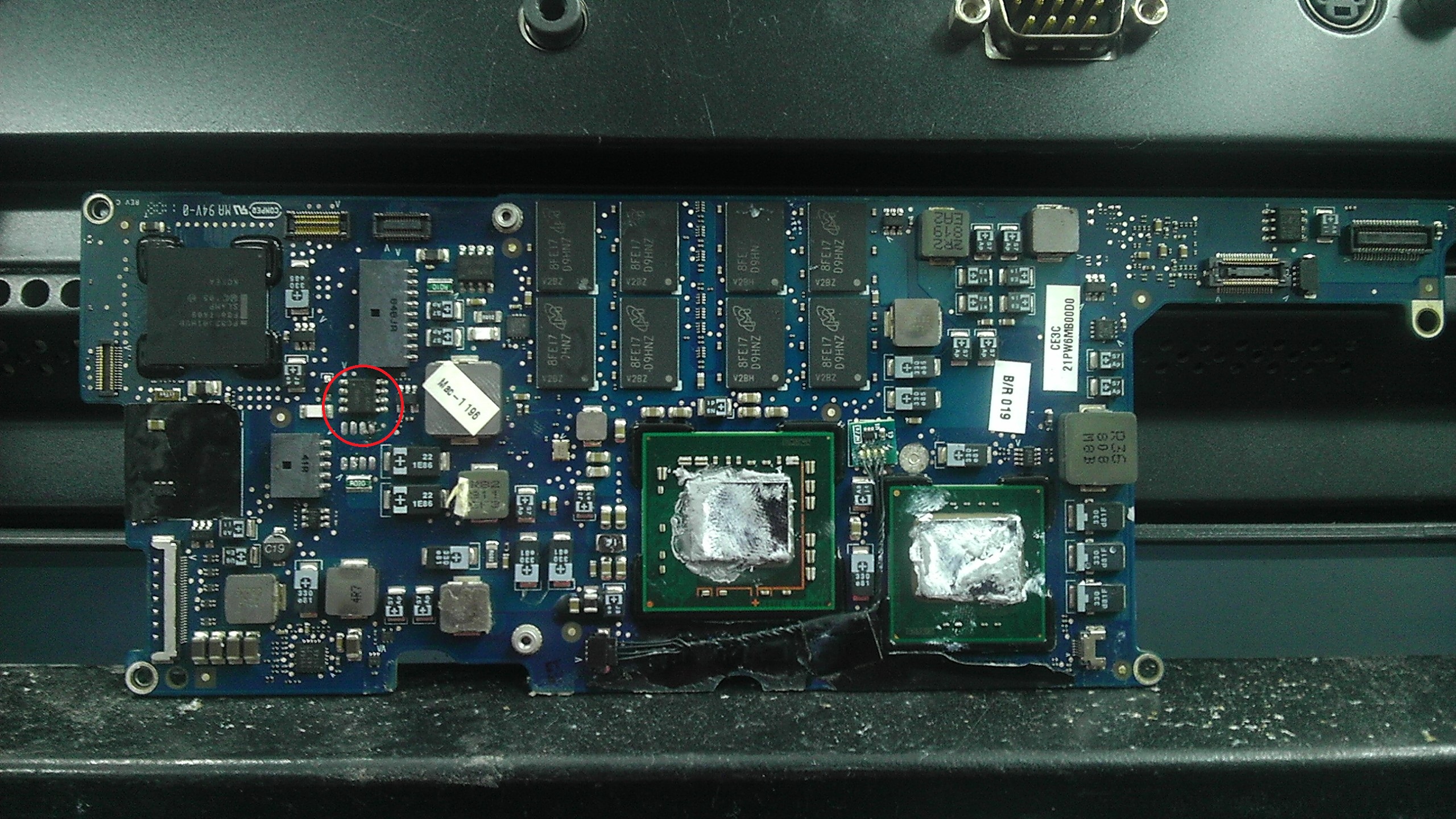

                            Re: MacBook Air power on problem
                            hi everybody
                            i have a problem in this board
                            after this smd ic i don't have any volt or any connection with any Piece
                            thank's for help

                                Originally posted by 3gen
                                hi everybody
                                thank's for help
                                Then replace the ic. What is the writing on it ?
