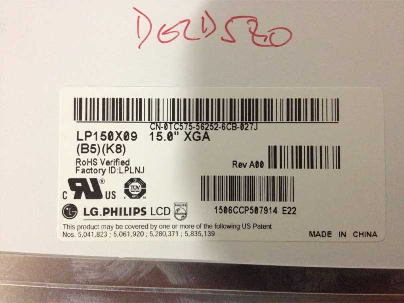

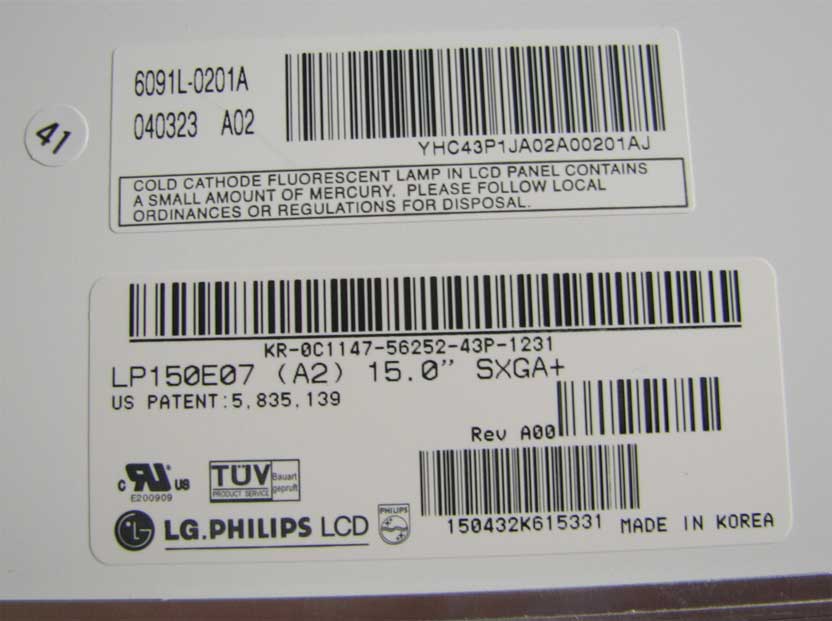

    Dell screen compatible ?
    Hi, is possible to put 15" SXGA+ instead 15" XGA I mean is a chance to this work ? dell d 520 has sxga+ 1400x1050 and d 505 with xga has 1024 X 768 resolution. Im in dilema, because I cant test, i dont both have both with me.

          Re: Dell screen compatible ?
          Each dell screen has it own BIOS. Even if you replacing for exactly the same screen you have to read that chip on old screen and dump it to new screen to make it work properly with mobo.
          Things are complicated when you trying to switch for a diferrent screen. If you know how to edit that dump , compare it to original and change something it can work but there is a lot of work to do to make it work. Basicly it will not work without any changes.
              I've replaced several Dell laptop screens with the same model/type (but not the same brand) without needing to do any BIOS adjustments. What are you referring to?

                          Screens with back lights are in short supply so screens are now being made with led back lights with akit that modifies them for known models the reason it says don't use for dell with same number is the connections are different you must get the correct one for your model made for dell.
                            Well as gabik111 already said, not only the right connector is important but the screen also needs the correct eeprom. If its not then brightness control will not work correctly and the screen stays more or less dim. To solve this you need to dump your original eeprom and program in the timing and resolution information obtained from the new screens eeprom. This way you get your replacement screen work flawlessly.
                            The tools:
                            - Viewsonic EDID Editor (for comparind and building the EDID proms)
                            - Ubuntu Linux 12.10 (for dumping and programming eeproms)
                            I used a live DVD where I had to install i2c-tools additionaly (may be downloaded from the distributions website).
                            On thinkwiki you'll find a HOWTO which describes what to do, it works quite well for Dell machines to. I don't know if links are allowed to be posted, but if you google "thinkwiki edid" the relevant posts come up.
