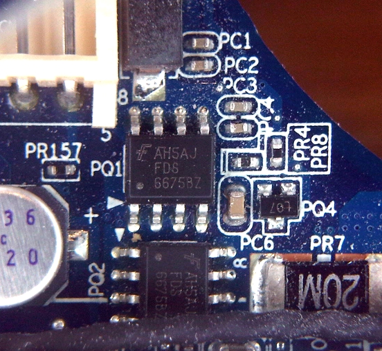

    I have a HP G7000 laptop here that is totally dead. Pressing the power button gives me nothing, connecting the AC adapter gives me nothing. No lights or anything.
    I have stripped the laptop and checked for anything obvious, I have also checked the solder joints on the mainboard and confirmed the power adapter is supplying the required 19.5v.
    Can anyone advise me on my next move?

    Check AO4433 switching mosfets on power source side on mobo (just where power entering ). Did battery hold any power?

        If those are shorted you have to replace them (propably only one) for new ones. You can easly use AO4407 instead.

          I have found what I think are the equivalent parts on the mobo. I have attached a picture.
          The parts are labeled...
          AH5AJ
          FDS
          6675BZ
          Am i looking at the right thing?
          EDIT : I have also found a datasheet and am now pretty sure I am looking at the right thing.
          Any tips on how to test them?

            That's right. You can use AO4433 or AO4407 instead of this.
            Measure resistance between pin 4 and 1,2,3 / between 4 and 5,6,7,8 / between 1,2,3 and 5,6,7,8. You got datasheet so you can see how it is look inside. If there is no resistance that component is shorted. Otherwise there should be some resistance one way .

                  Thanks for the suggestion, I spotted the guy in Portugal selling them and have ordered a couple.
                  Ill report back when I get them and fit them with the results

                            Just a quick note to say my original issue with the HP G7000 was resolved by fitting those new parts.

                                I have the same problem. The two mosfets one shorts between pin 4 and 5 or Gate to Drain. I have found these mosfets in the UK at Farnell components for £1.30 Each http://uk.farnell.com/jsp/displayPro...ss_price=true- Hope this helps. The model number is FDS6675BZ. It is similar to the A04433 or A04407 but going to order direct replacements. Thanks for the thread.
