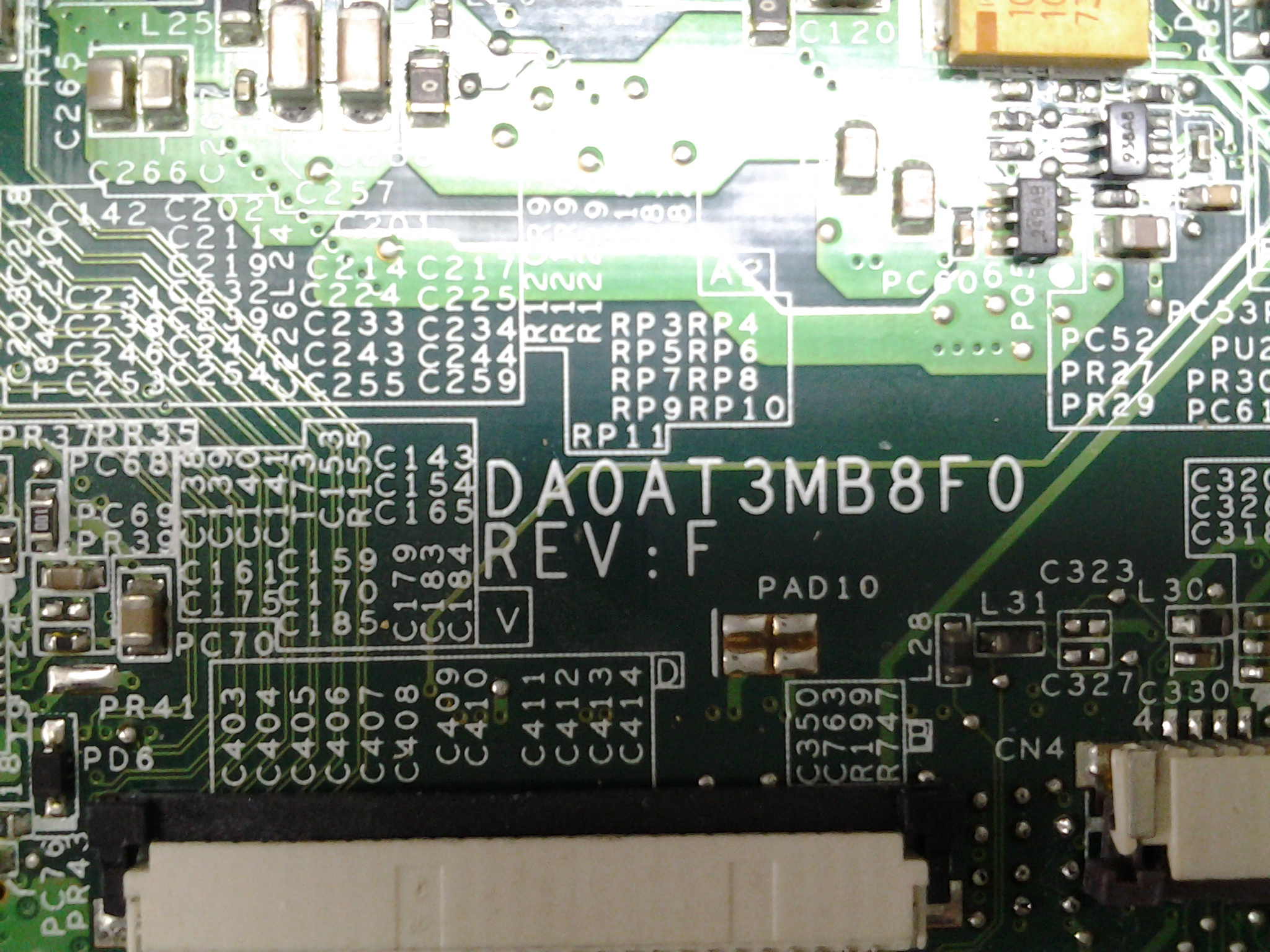

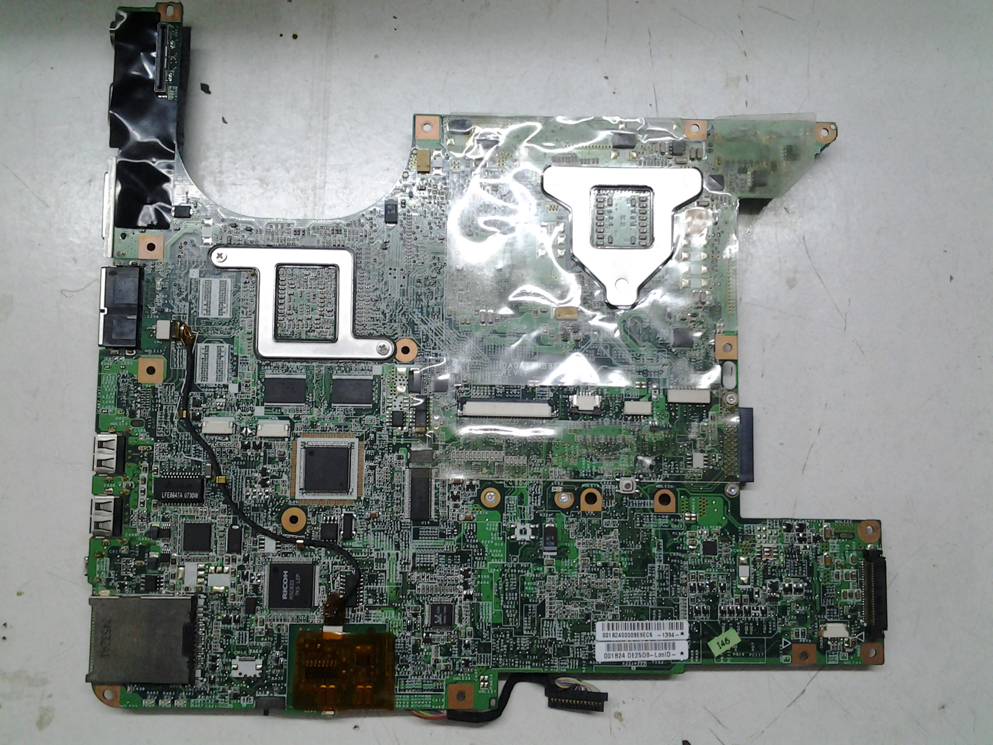

                      Re: HP pavilion dv6000 power problems
                      Some photos of the motherbaord and link for the schematic :
                      https://www.badcaps.net/forum/attach...4&d=1356686752

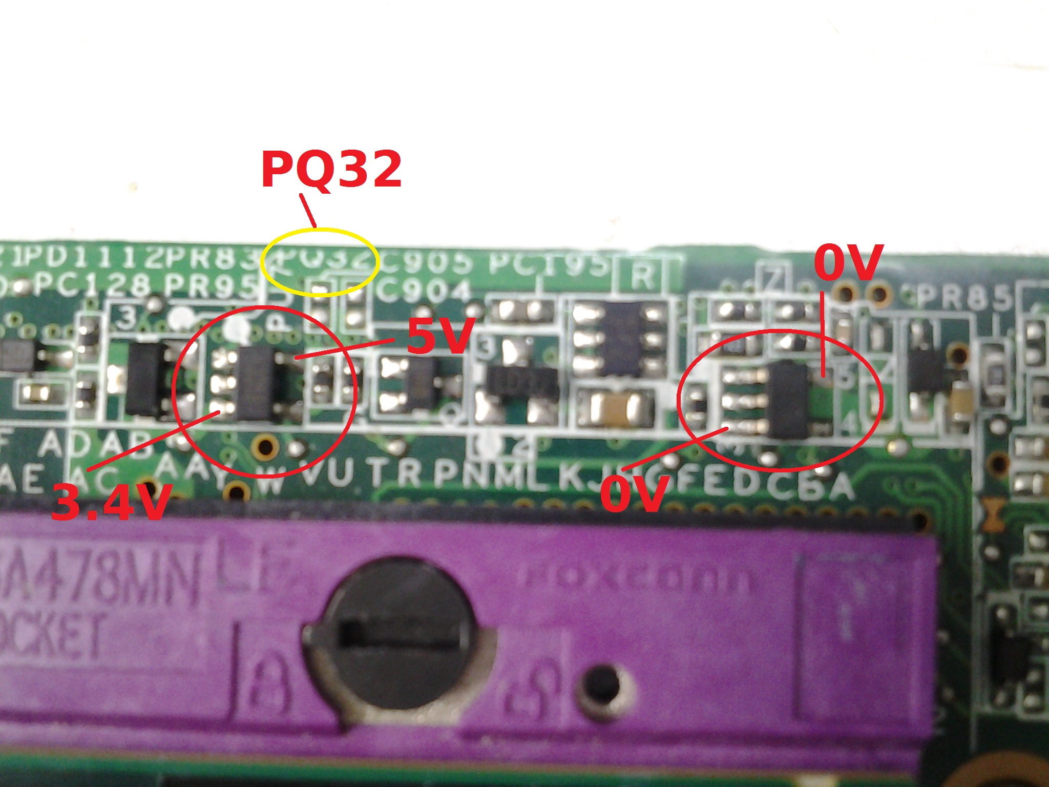

                                After searching the pcb about 15 min i managed to find the below in red circle but not sure if the right side one is PQ31.
                                With yellow circle is the PQ32 marking and suppose that below in red circle is PQ32
                                This Volt readings are with battery plugged. Without battery and only dc jack plugged no volt readings
                                    The 5 pin one is PU7 with 5v on pin 5 and 3.3v on pin 3. Give voltage and to the rest of pins.
                                    PQ32 is on the left of it. To find which ones are on the right of PU7, you have to find the Z and R sections printed on the board which they define the layout of the smt's in those sections.

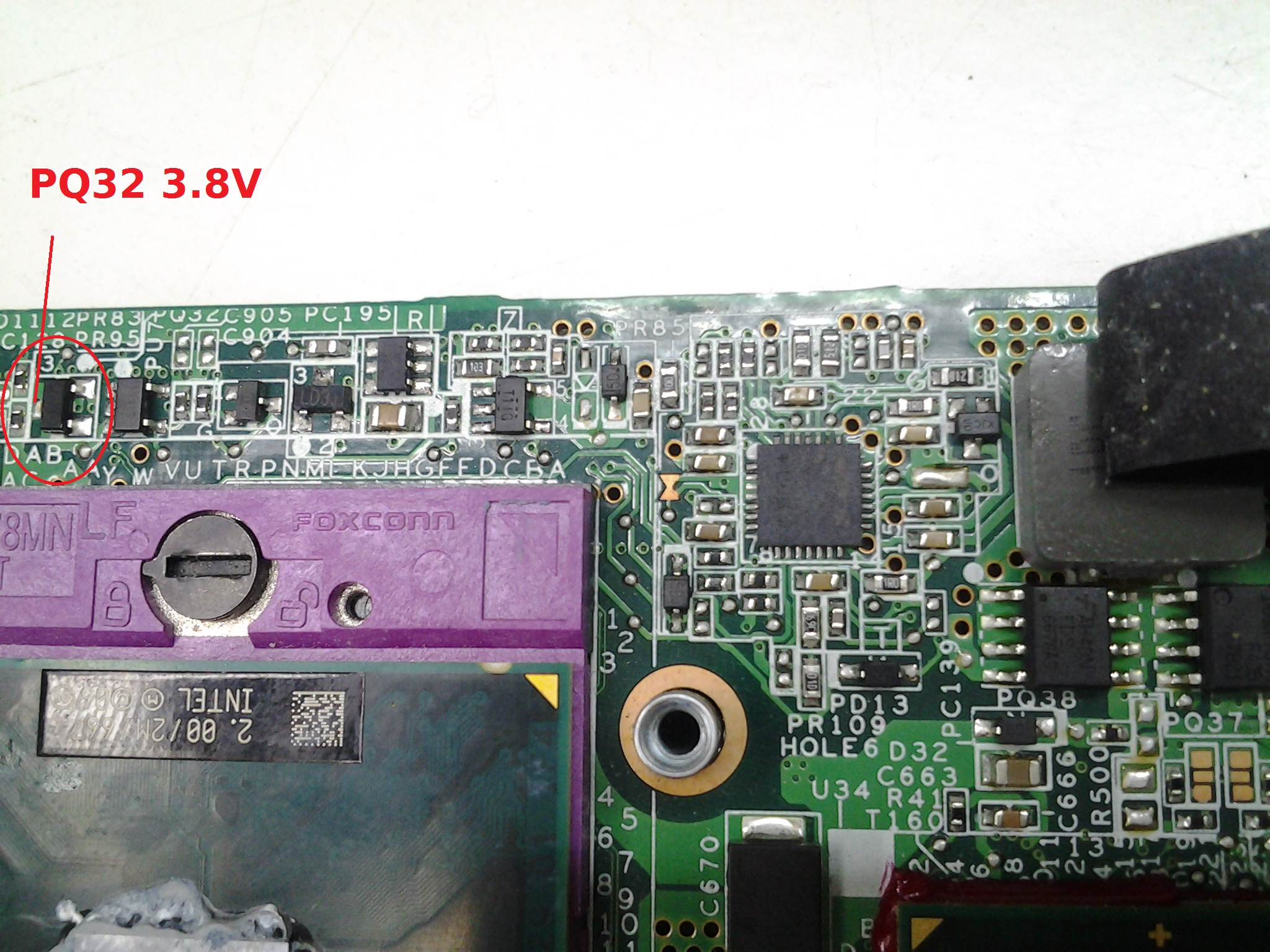

                                        Please have a look at the below pic i have attached for you.
                                        I have only 3.8V at one pin of PQ32 as i marked at pic. other pins are zero Volts.
                                        Maybe from this pic which is more clear you can identify PQ31?
