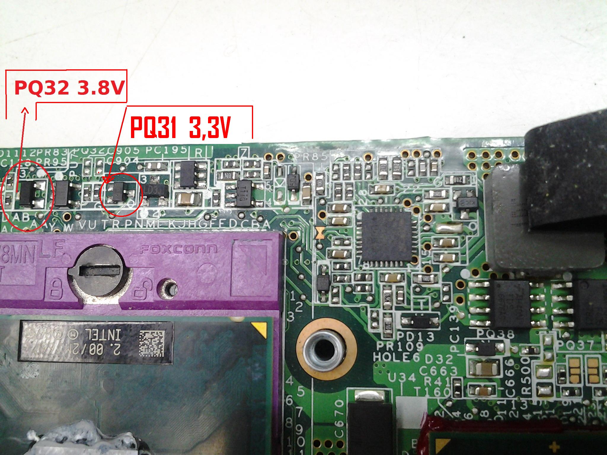

          After i spend some time reading the schematic better i realized that PQ31 is the one in red circle at the attached photo below.
          I am definitely 100% sure because pin number 4 of PU7 is connected with PQ31 pin number 2(GND) at schematic page 41
          So With battery on i have only 3,3V at pin 1 of PQ31. 0 Volts at pin 3 output
          Is this normal?
          PQ31 datasheet https://cdn.badcaps-static.com/pdfs/...fa66748403.pdf

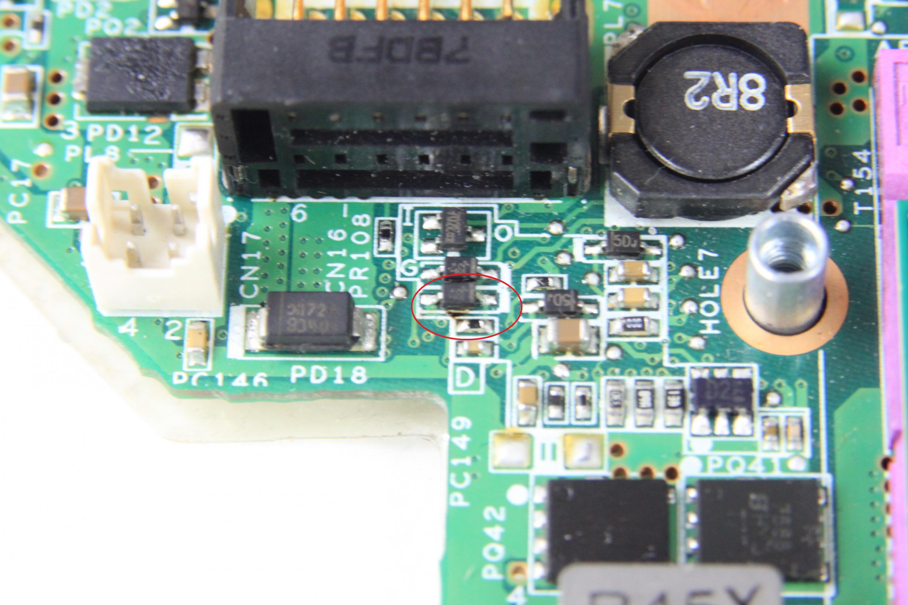

            I found a diode burned near the 19V plug.
            I hope this will solve the problem
            See at the attached picture in red circle.
            From the schematic i found that this is CH501H schottky diode 45V 0.1A.
            https://cdn.badcaps-static.com/pdfs/...64beb02925.pdf
            Does anyone know what non surface mount component to use for replacement ?
            I have fast access to many components but not smd and don't want to order it and wait a week or more

              I will use the BAT 42 diode for replacment
              https://cdn.badcaps-static.com/pdfs/...17acd67c38.pdf
              Later today i will come back and post the results

                    The diode replacement did the job !
                    Thanks to everyone for their effort
