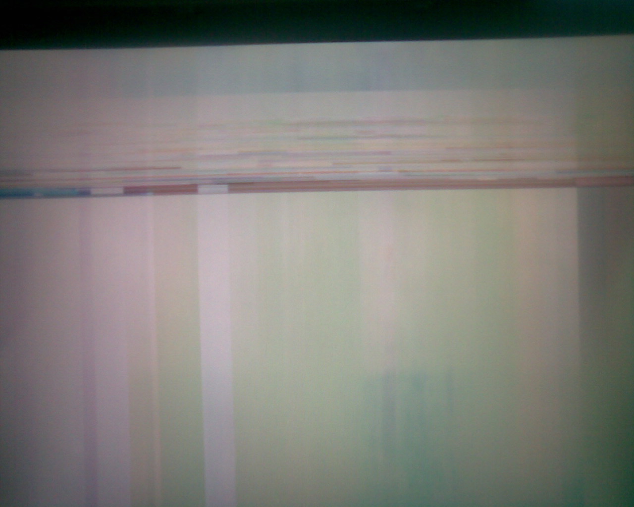

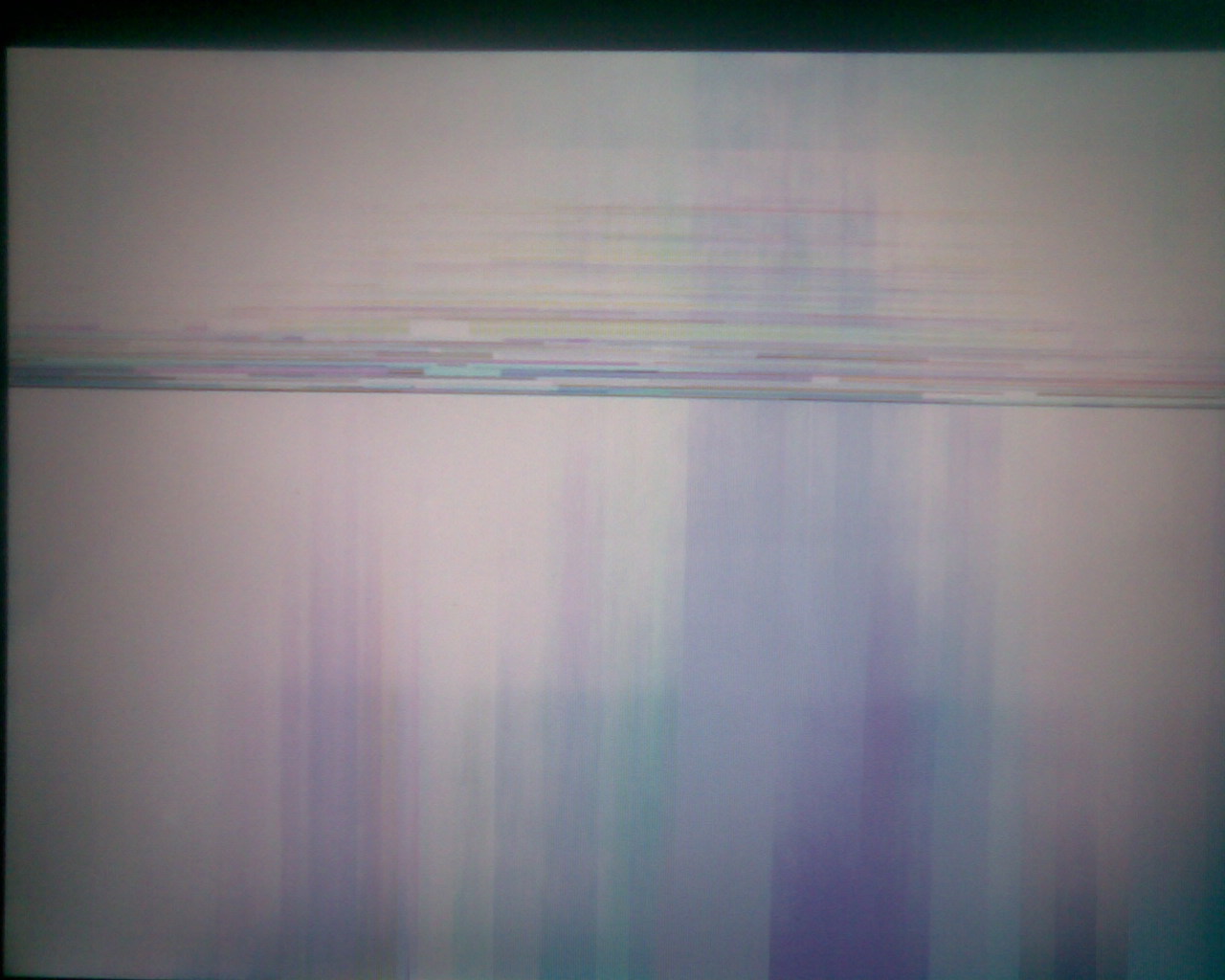

                  Hello guys,
                  On trying to trouble shoot the problem, i got it to work fine for a moment.
                  the next day turning on the system boots to the desktop, and displays the following screen in the picture.
                  sometimes, as soon as windows boots up, it will display the desktop for about five minutes and shuts down by itself, at other times, it will just go off without shutting down!
                  what could be the problem?
                    Re: Samsung v25 screen and power problem
                    If I had to guess I'd say that the graphics chip/card is overheating due to a faulty fan/connector. That's assuming that you've done all the checks that have been suggested already...
                    Did you find out where the fan that doesn't work is connected to? It's probably the graphics card/chip
